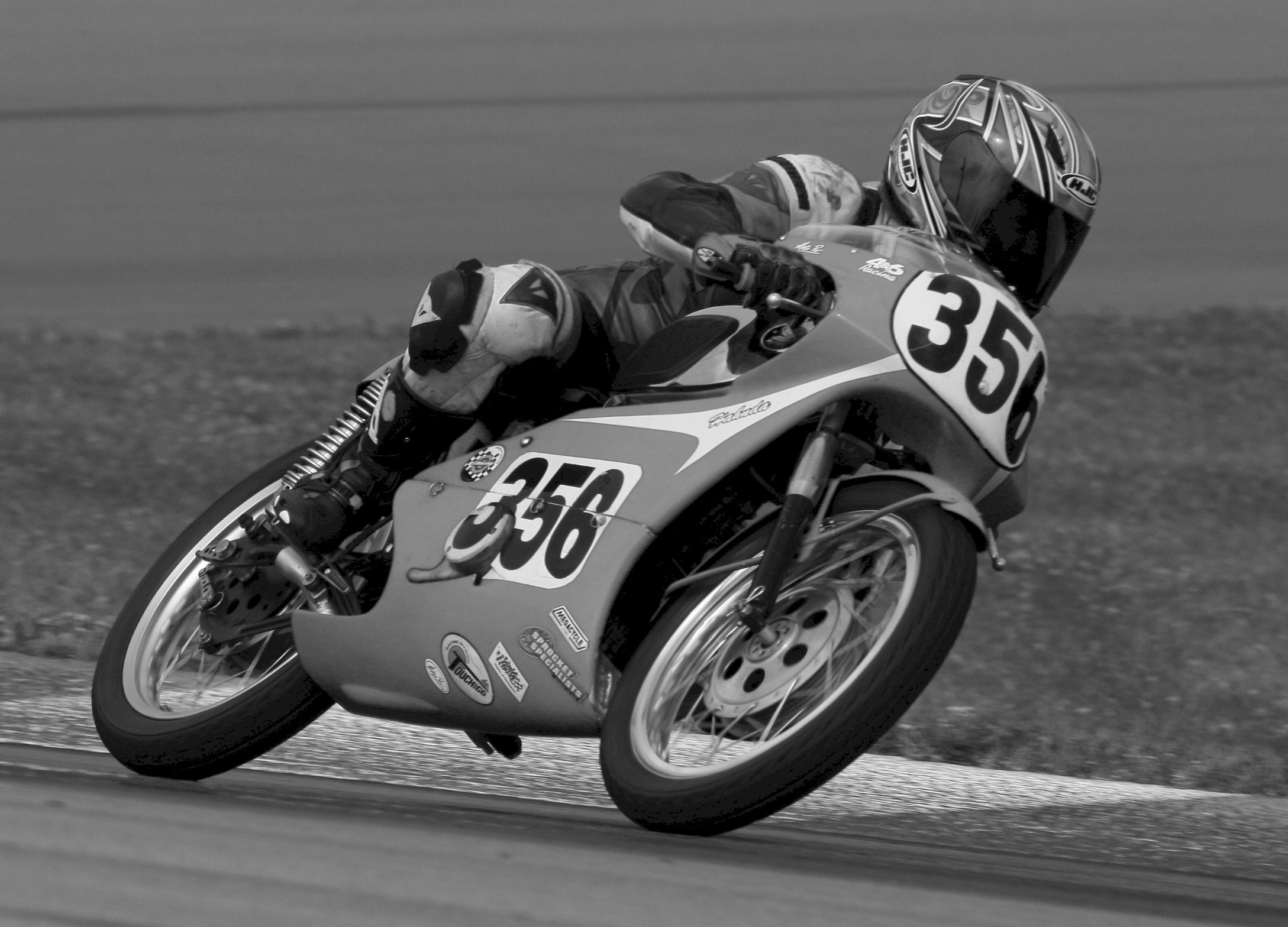

Back when we were racing a pair of CB160s, we collected them from all over the place for free or not much more and some of those parts are still in crates here - road only parts went in the recycling bin, but I never planned on a full CB160 resto, so that was never and issue.
Good luck and let's see some pics please.
Some fork seals are available but Honda changed the size and design. We had a batch imported but I don't recall which legs they fitted. 68 used alloy sliders and I think they were the seals that are NLA but I'd have to check my notes.
