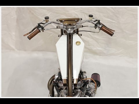

I already have a plan what I want to do...I will use the base of my XS 750 tank as a "base plate" and then I will build my new tank on top of that.
Thinking about doing a "split tank" like the old bikes had with separate tank bungs and petcock bungs, which I would cut out of other steel tanks.
Really not planning on building something too big, it will be more an experiment slim and flat tank design, very streamlined and unpractical :)
