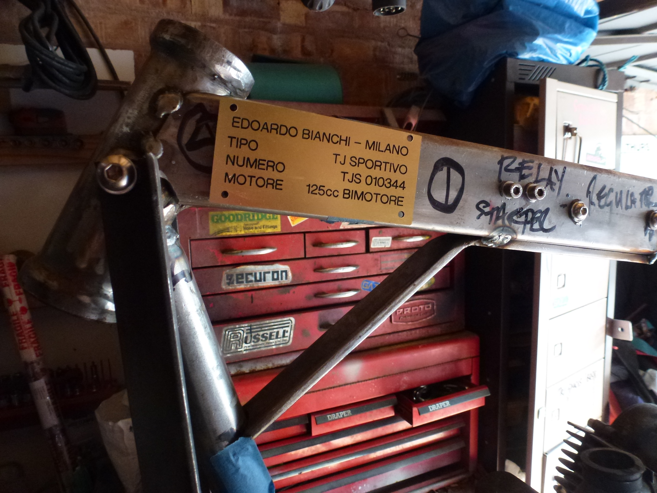

Phantom chassis plate for a Phantom bike !!!!!!

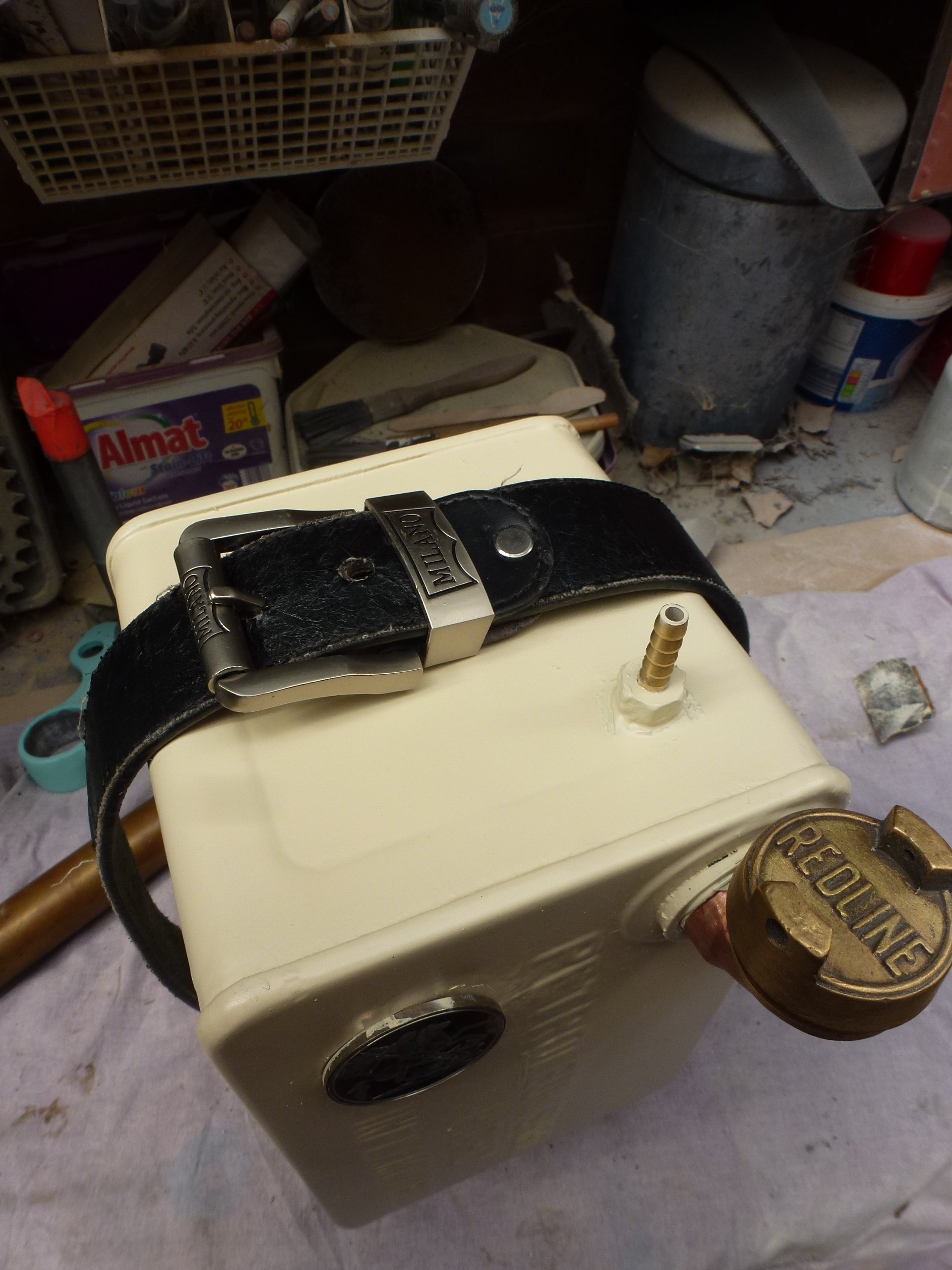

Almost there, just some fettling and working out how I'm going to use the "Milano" belt to attach and where !!

That's fantastic. Coming up quite nice.
The build plate is a great addition as well.

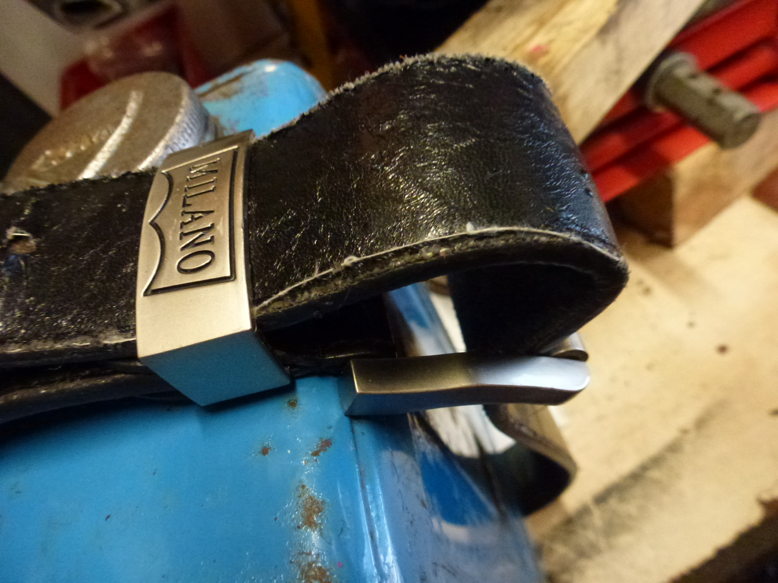

Thanx Brodie - maybe here for the belt ? I might use it as a dummy and use some fixings at the bottom of the tank to the engine plate.

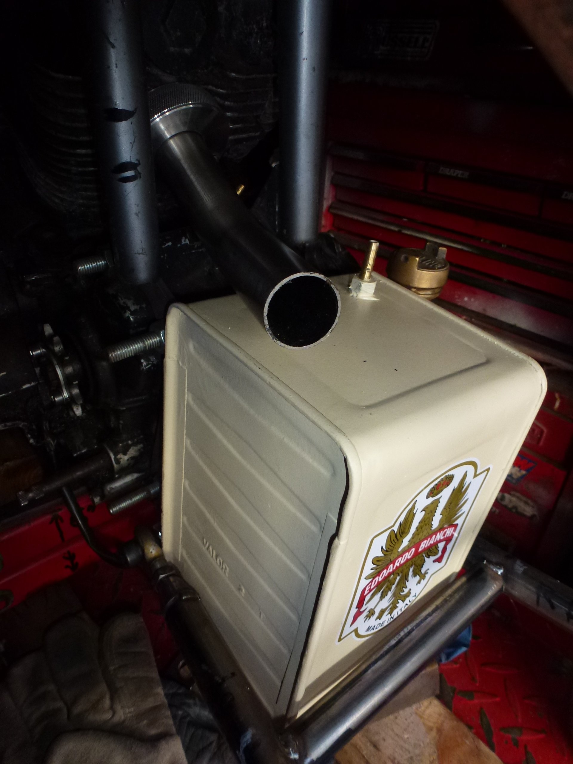

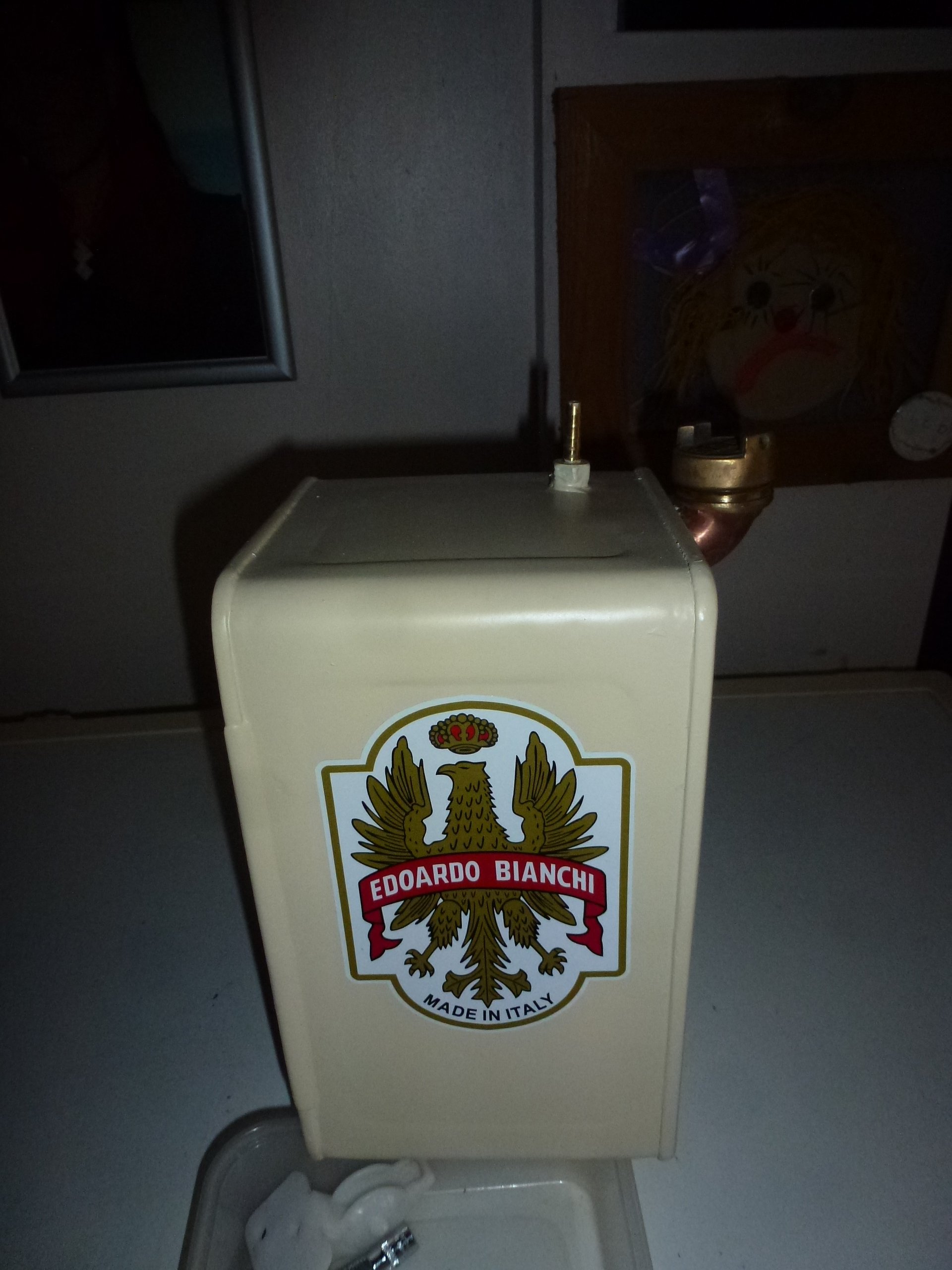

Fuel cell is finished now.
I had to cut off the alumimium boss off the brakeplate [ cable stop mount ] as it fouled on the frame axle plate.
All linished off, primered and finished in light Ivory to match the wheels - which should be back from powder coating next week.

Not sure where it's going yet, but just wanted to see what it might look like !

Lookin good! The fuel cell turned out very nice.. looking forward to seeing that frame all welded up
Thanx for the encouragement.
Well pleased with the fuel cell, went from a "whatif" to a "that's it". More important it solved a lot of packaging problems and saved a whole bunch of money. Bonus - embossed on the side "petroleum spirit - highly inflammable".

I also found a company that can make an OEM style chassis plate - just waiting for a quote.

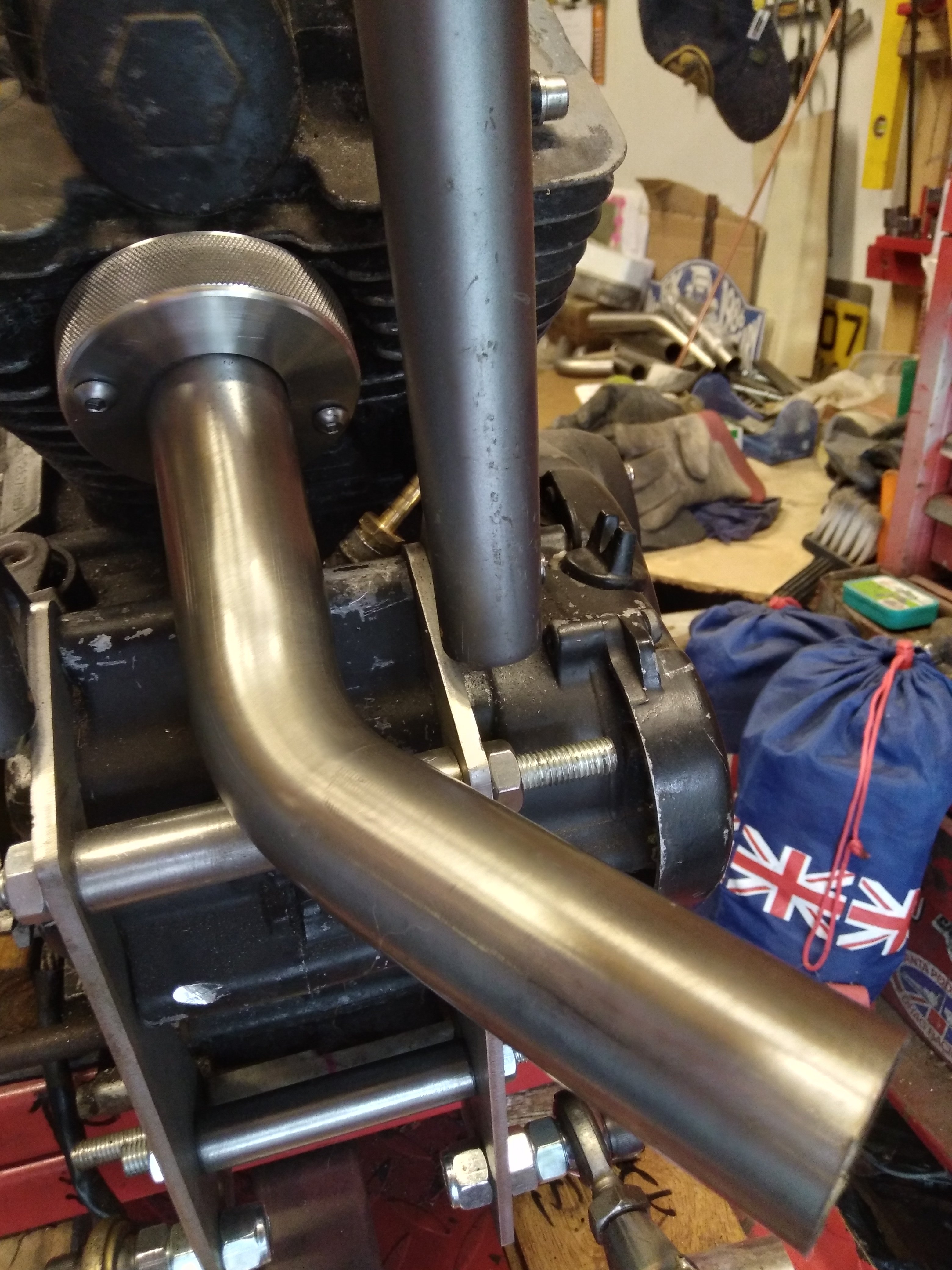

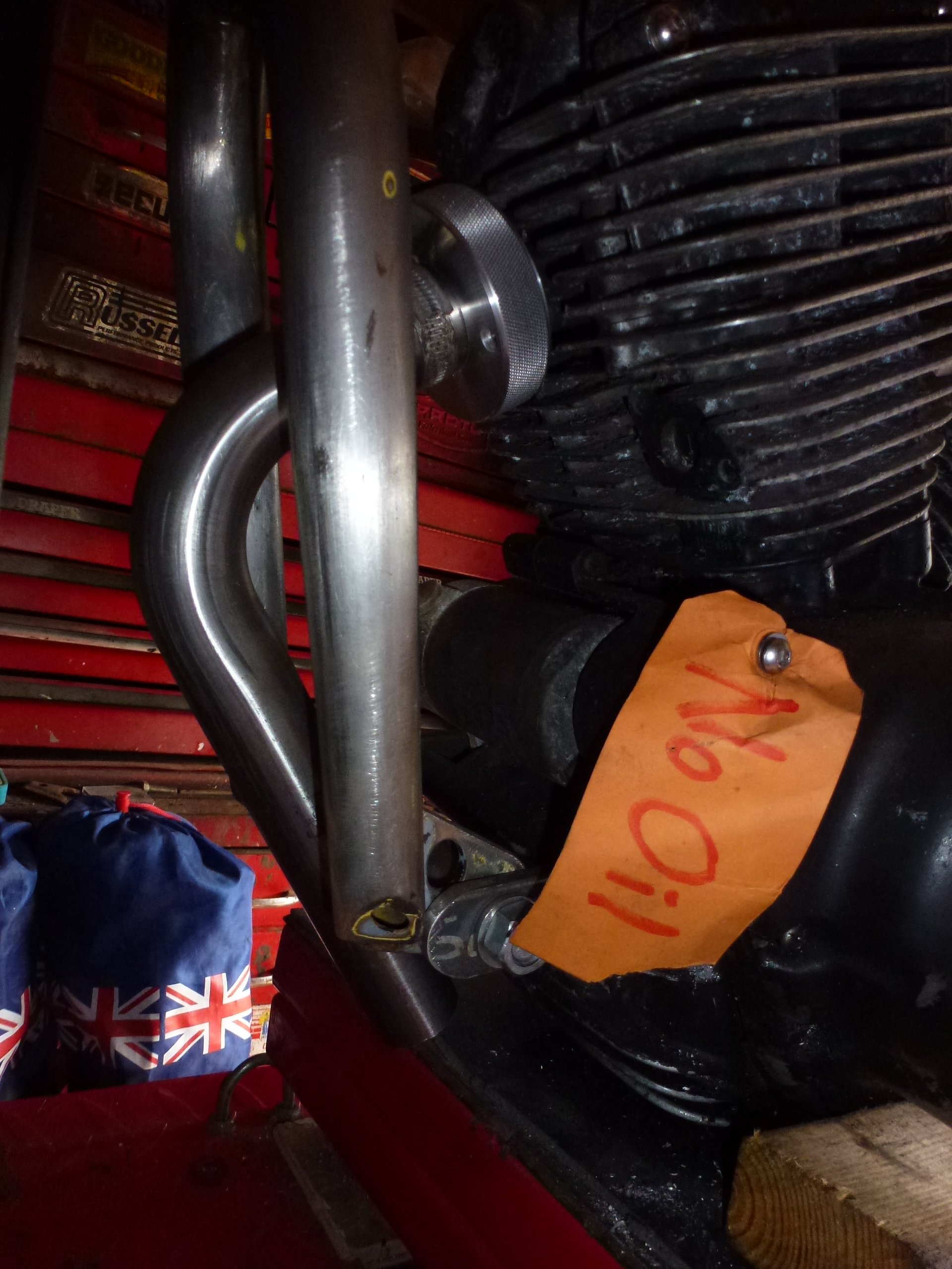

Finally got the headers mocked up in the new collars. Front is dead simple, a 90 degree stainless bend off the shelf cut to length.
The rear is doable now - clearing the fuel cell. I can't finalise the layout until the footrests etc are in place.
