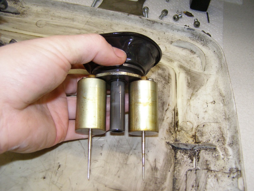

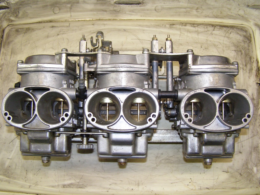

The carburetors are quite different too. 3 "double barrel" carbs versus 6 individual. I worked on one a few years back. IMO they are a tad "uglier" than the CBX. And trust me, I'm a tried and true KZ fan. I have always liked them over the CB series. Usually had more torque from what I could find. (and feel) Plus they are cheaper :) 120bhp compared to the 105bhp of the CBX too :)))

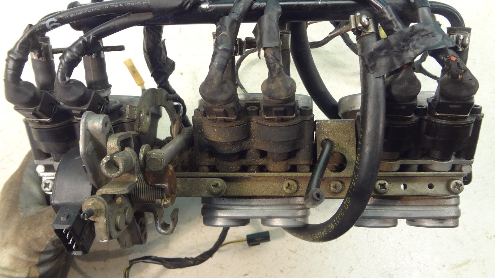

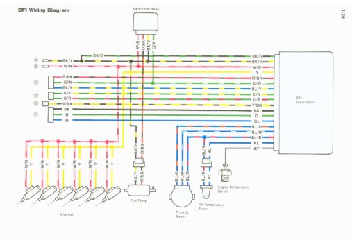

This has my brain working overtime... we may be onto something for the home build simple EFI setup. It seems to me with the 1300 throttle body and simple ECU and electronics someone here could isolate these down to 2, 4 and 6 cylinder application.
Would it be possible to build a set of manifolds to run two of these: throttle bodies on a CB750 or even a KZ1000, the ECU seems simple and the TPS is integrated and just as simple...
Calling all FI guru's can you make it work??
