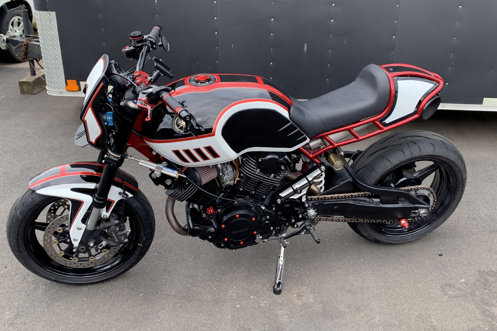

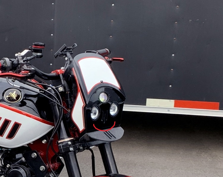

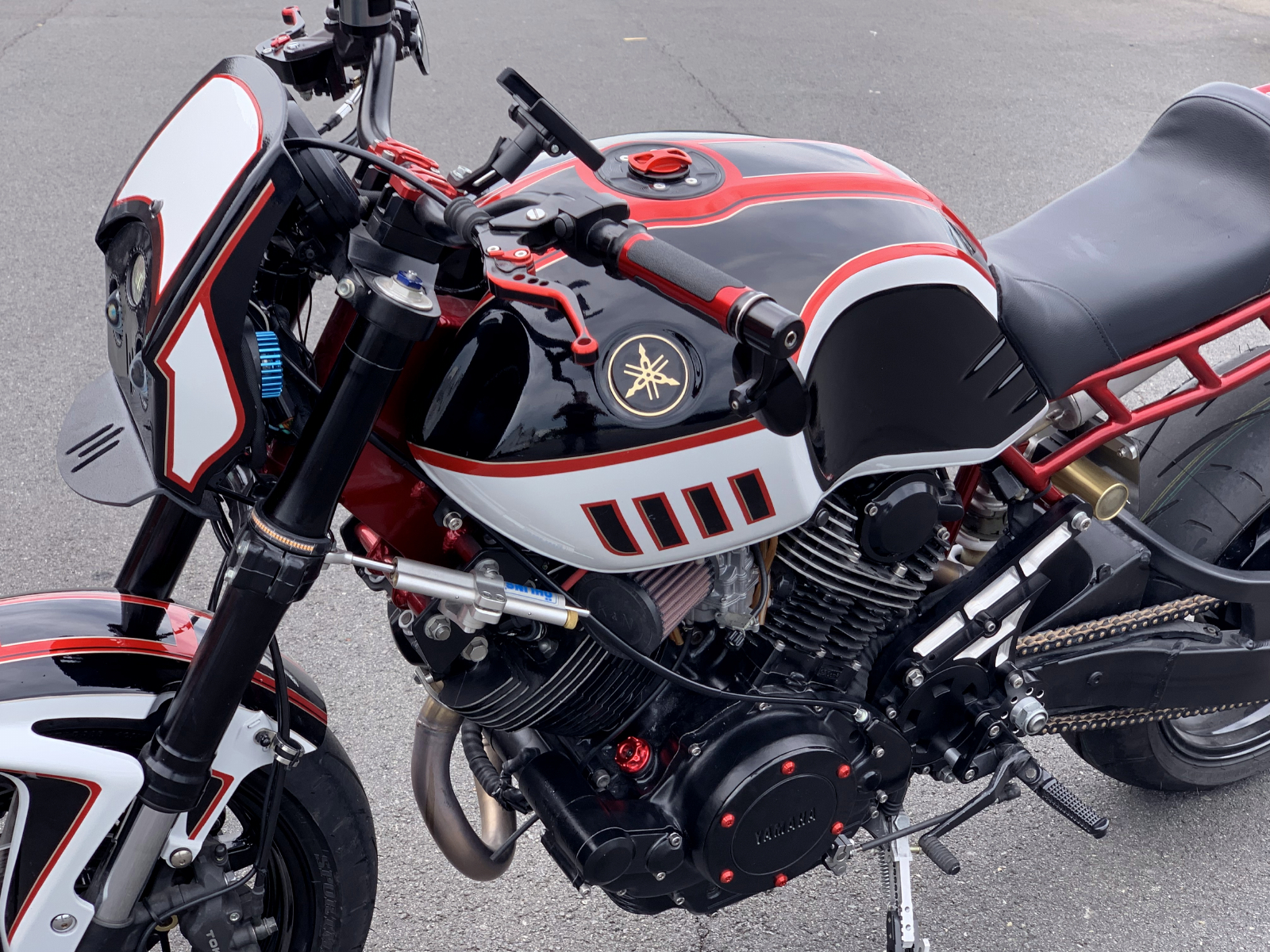

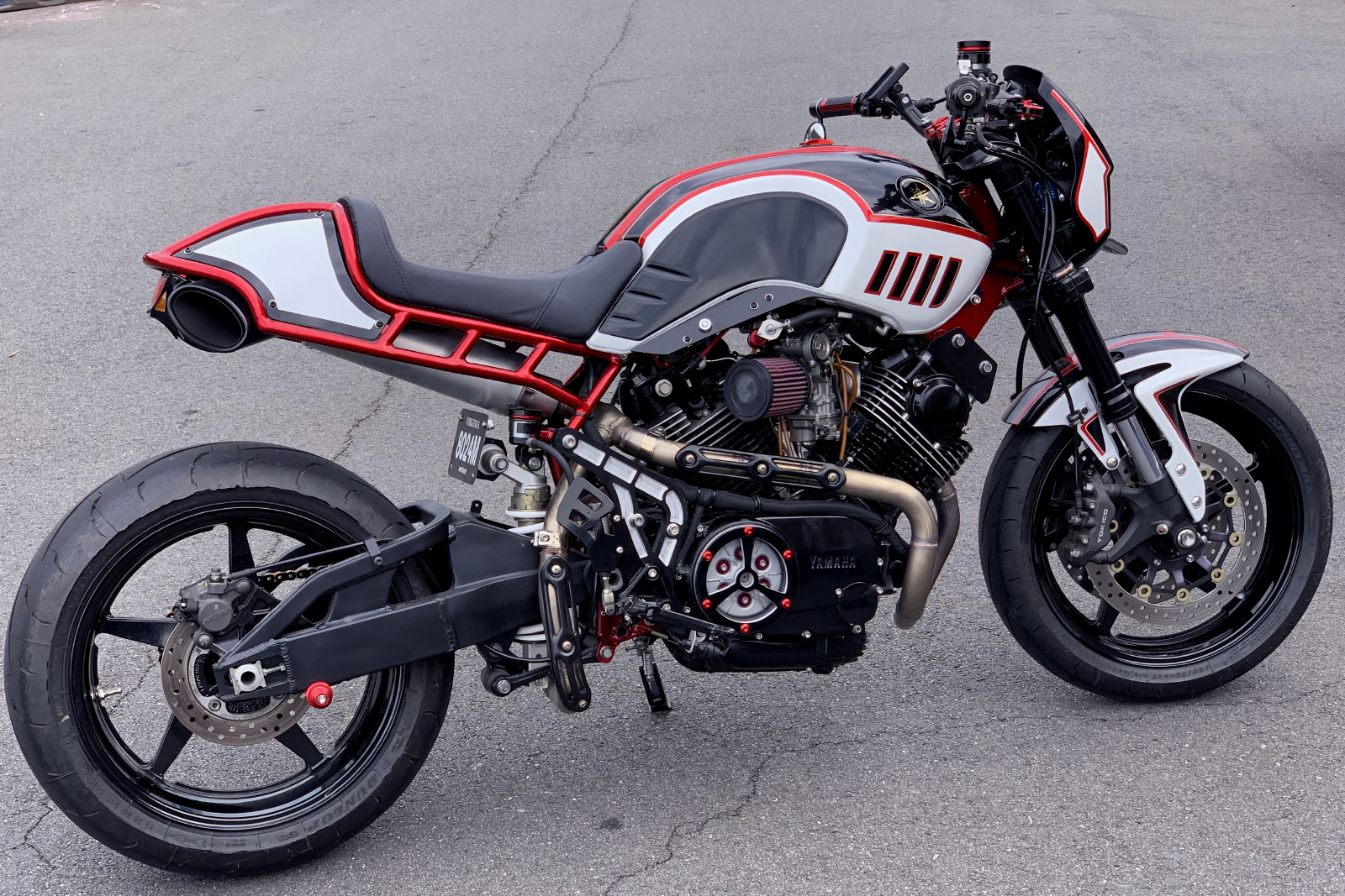

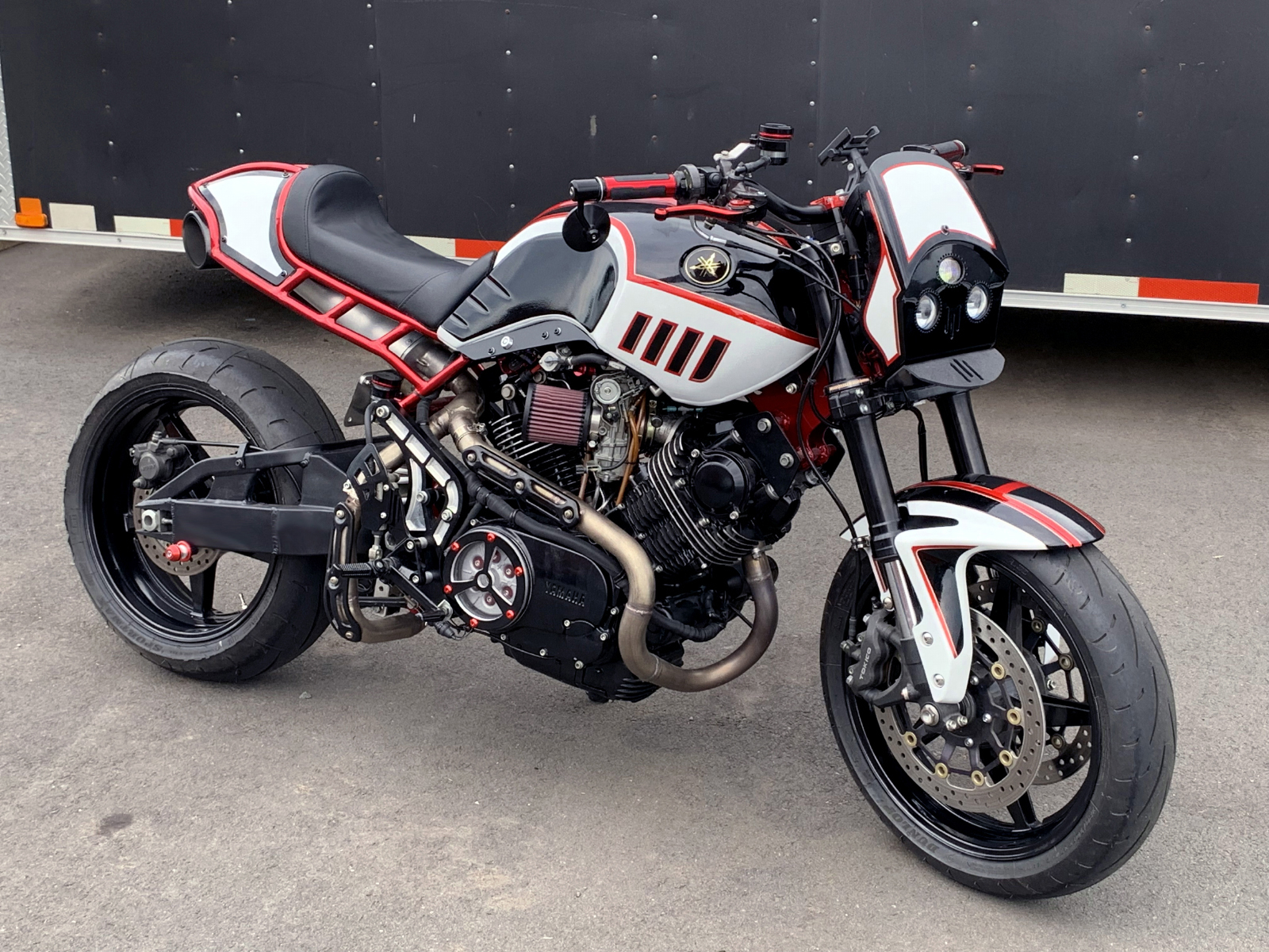

Finally!! I have a completed and running bike. I still need to take care on some details like buffing the paint and really cleaning the bike up some more. The bike runs pretty well considering I took a wild guess at the jetting, need to spend a little time dialing it in. The exhaust note sounds great closer to a Ducati than a Japanese cruiser. Took a couple pics with my phone ,but will get it out and take better ones with a decent camera.

Wow, that came out right, euphemistically speaking ;) :D
Any chance of hearing those pipes? They look awesome :)
p.s. But why so serius?
You should put a smile on that face ;) :D

Nice man, looks like a modern high attack street fighter! I like how you tied the swingarm, shock to the subframe to the frame, very cool. Maybe check for cracks in that subframe from time to time just to be safe as your swing arm, frame and shock won't break, leaving all the stress on the aluminum sub frame. How's the handling and cornering?
Ya you did lose the vintage twin sound a bit. I lost a little too with a modern muffler on my tracker (Cafe is fine tho) but when the tracker had the the 2x slim bullets it was tooooo loud cause they had no more packing.

The bike handles and rides more like a modern bike with the new frame geometry and the modern suspension wheels, tires and brakes. I have pushed it a little bit and it feels really stable. I have kept an eye on frame although I over engineered it. The CNC parts add a lot of strength to the overall package they are secured to the engine, lower frame, subframe, as well as the outer swingarm pivot mounts. I was surprised at the performance with the stock internals of the engine , not modern sport bike fast, but plenty quick for a street bike. I had considered getting pistons from you and putting cams in but I was already over my budget.
