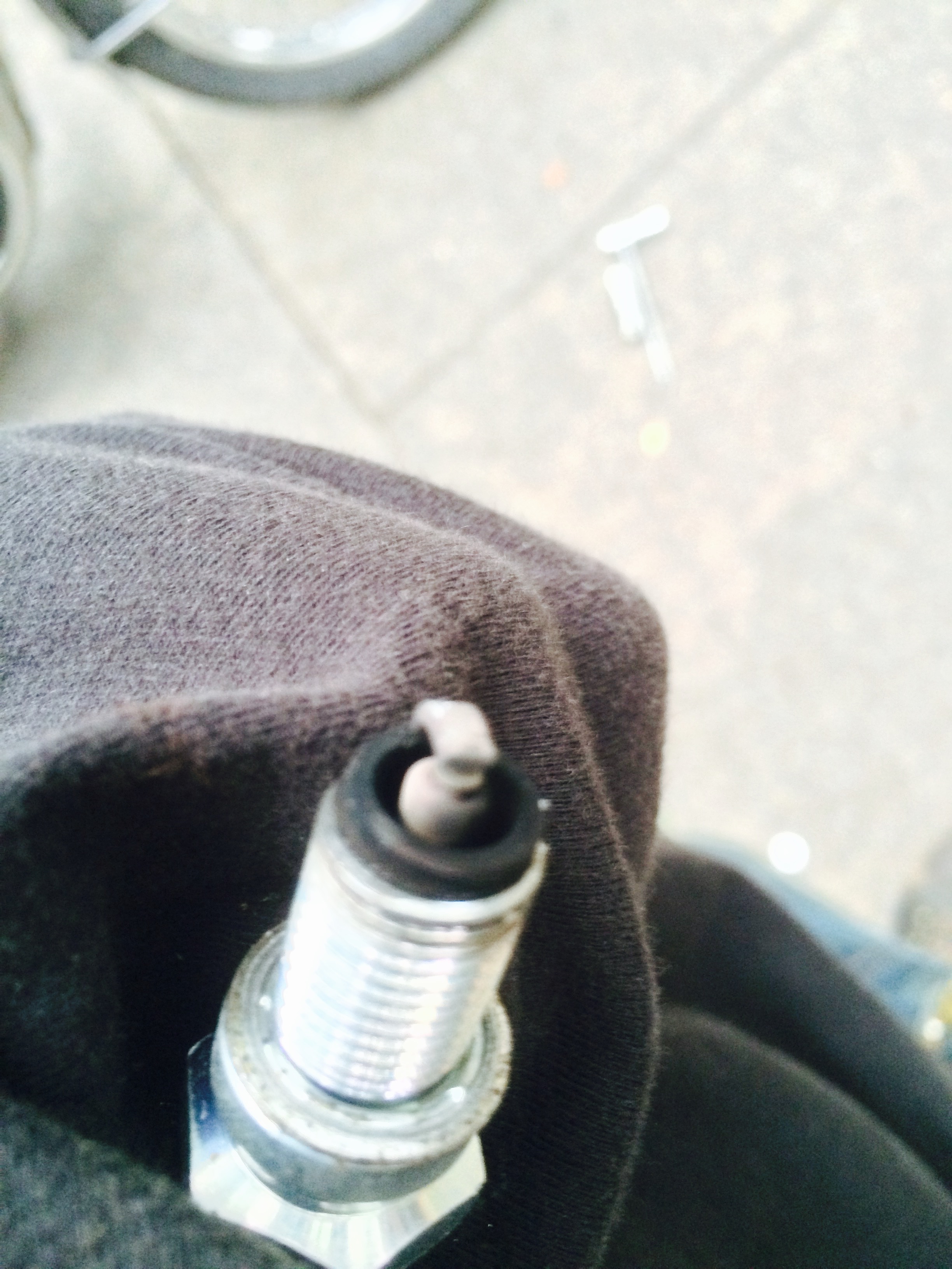

Hard to know "how much" until you see the plugs. A fresh set of plugs will help alot if the old ones are grubby. You'll get a better reading off them.

I forget which one of y'all was looking at condition of spark plug, but this is it on one of the cylinders running well. This is on cylinder 4. 1, 2, and 4, all appear to be running well and in sync. 3 is just off. See attached pic for plug. I guess it's a little black...
