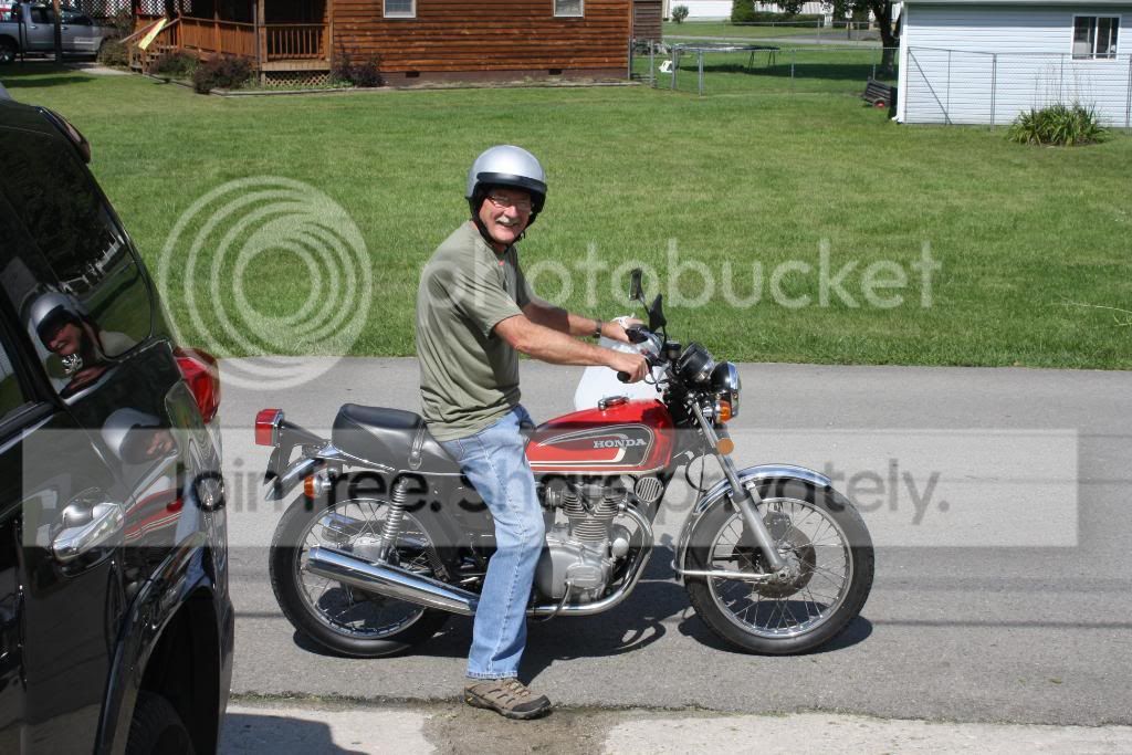

This is a pic of my father in law on his 74 cb360 that I owned for 2 days. :o

That's one clean little scoot (74' cb 360)
I've heard some people say the tapered steering bearings are easy, and others say they are hell to get the right fit. Glad you got them in.

Yes the cb is a nice little scoot, it runs strong and is in very clean condition. I do have a question for the electrical guru's. What volt switches should I usefor my headlights, Horn, ignition? I am building a custom dash with a momentary electric start, momentary horn, and a 3 way center off toggle for the headlight.
