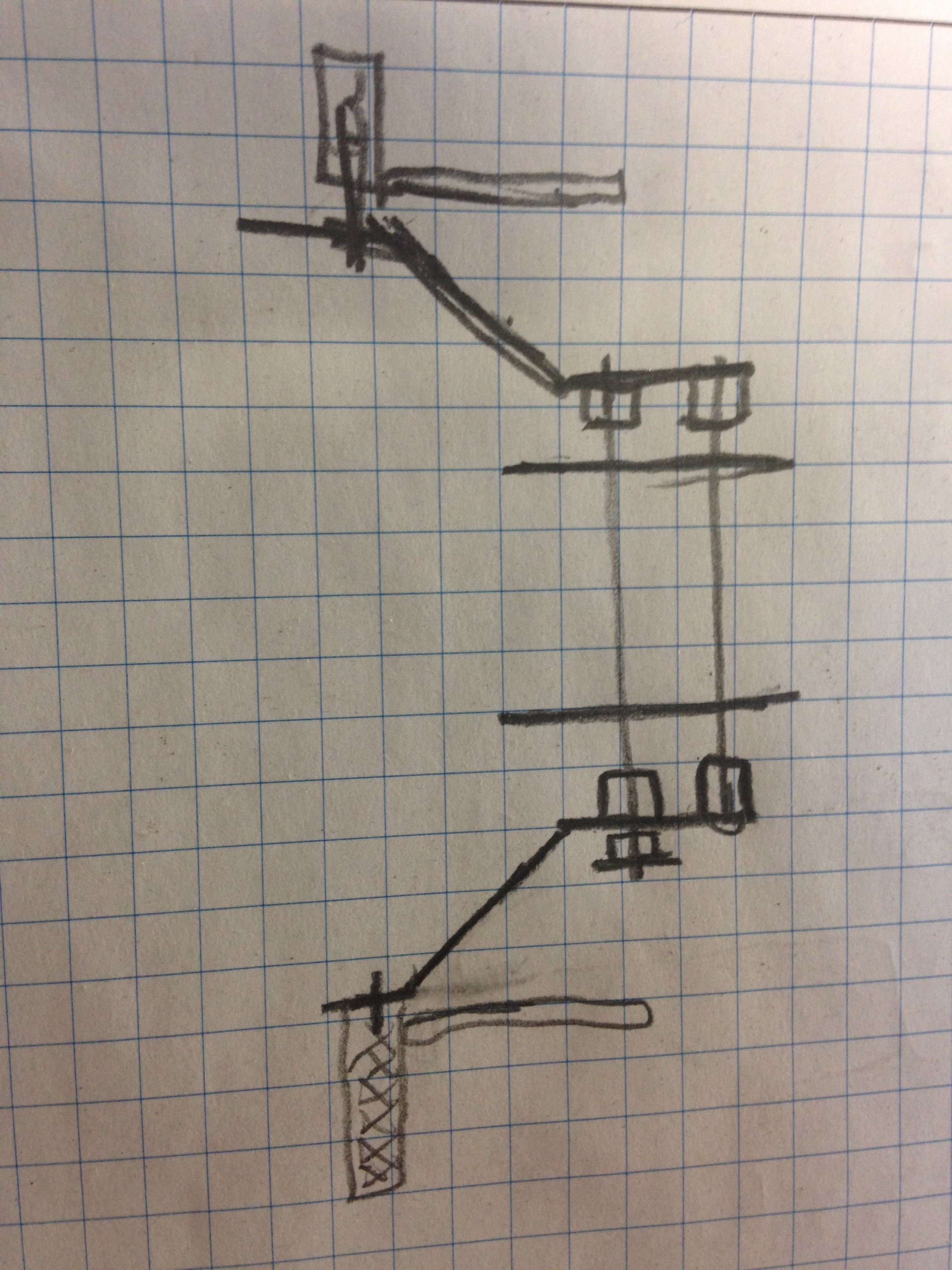

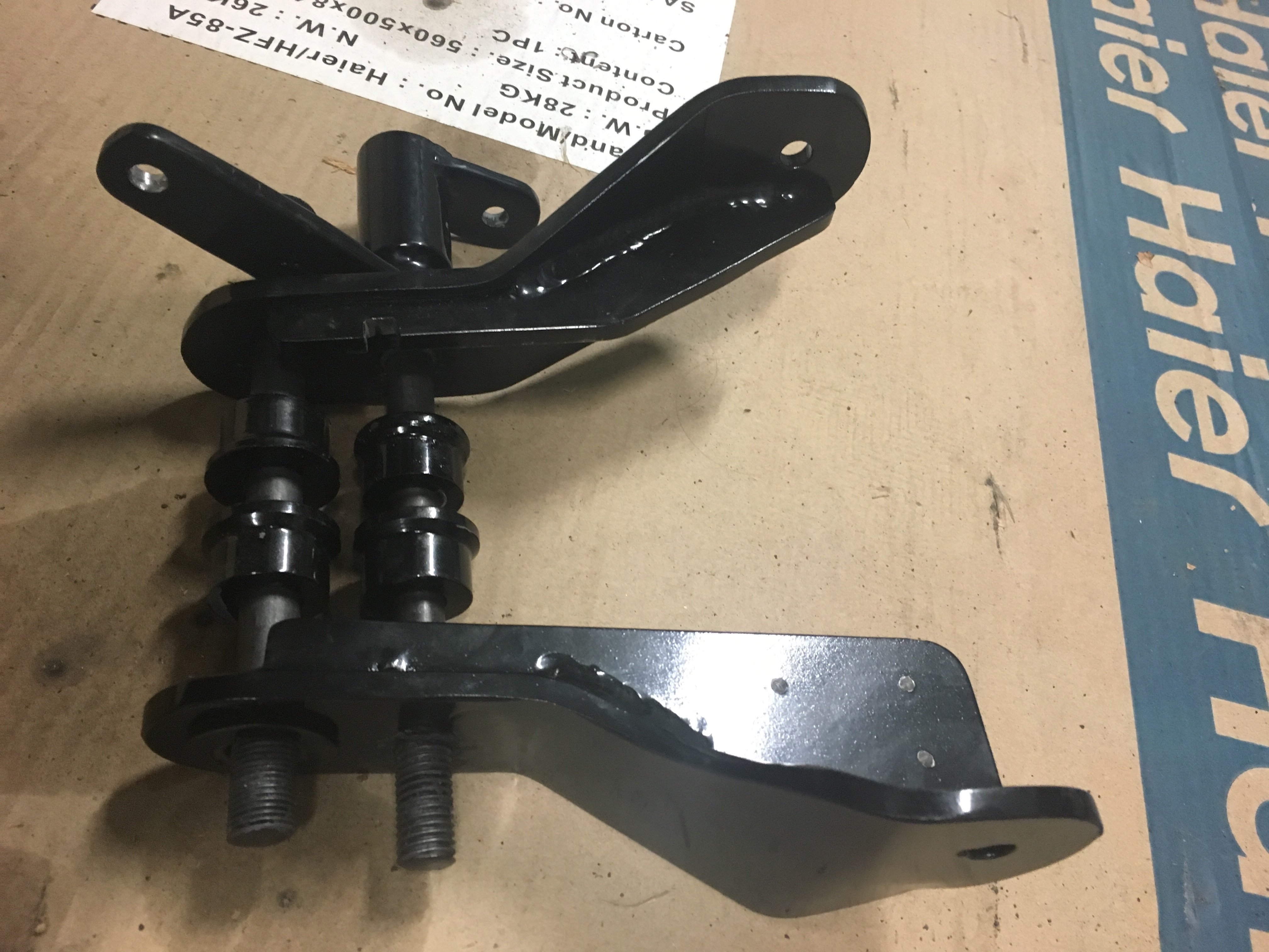

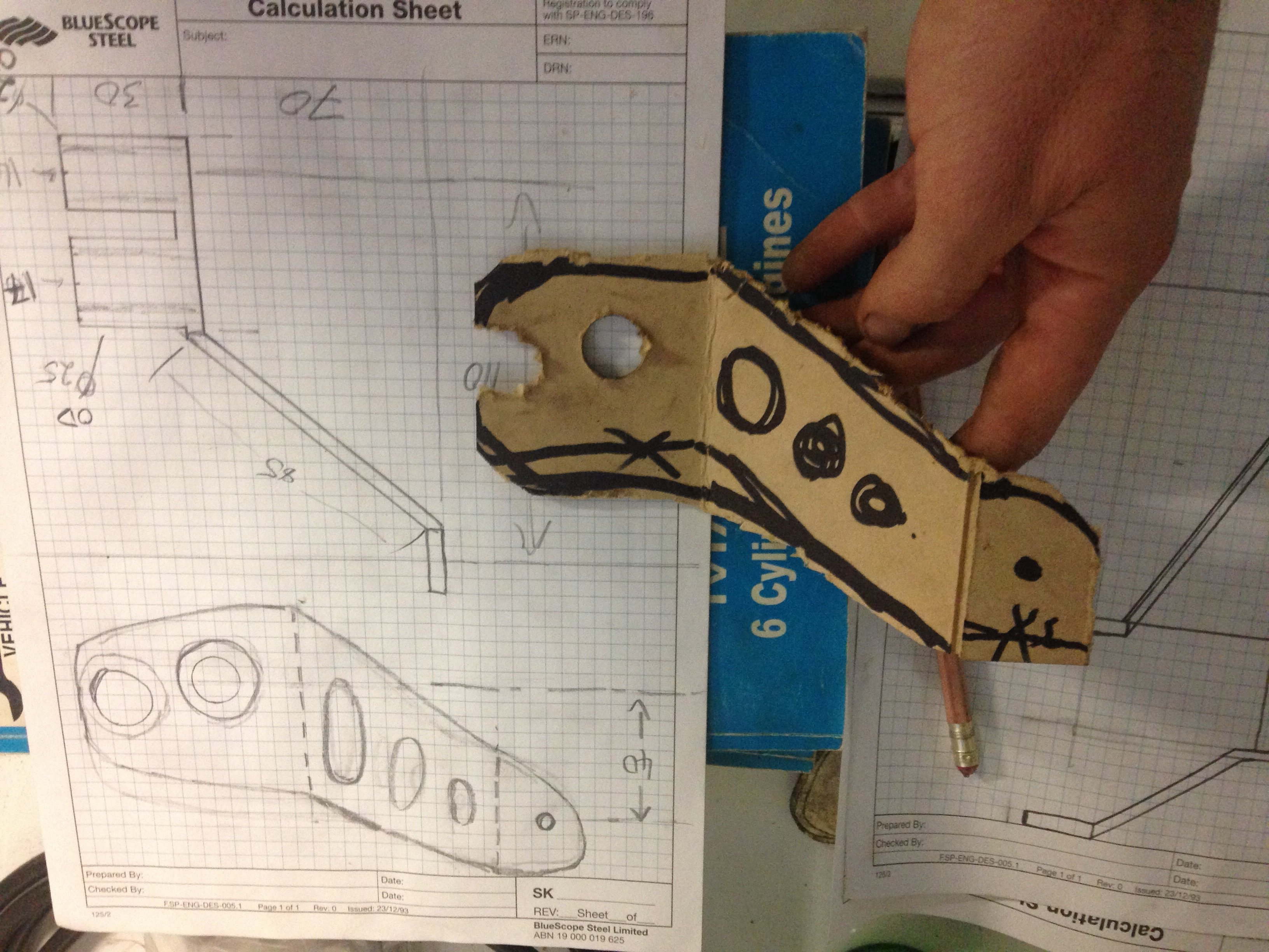

the brackets will be made of 25mm round bar drilled to size for spacers (a neat fit hear will put max shear and min bending on the pivot bolts when tensioned up) these spacers will be spigot located into 5mm steel plates fabricated into a z shape to get the right location.
ill try to put up some pics of the plans iv drawn plus template iv made.
need to get my hands on a lathe to make the spacers though.
im not I a hurry to get them made. just needed to design them so I can move on with frame prep.

these are my plans.
will probably use Alloy instead of steal as stated earlier.

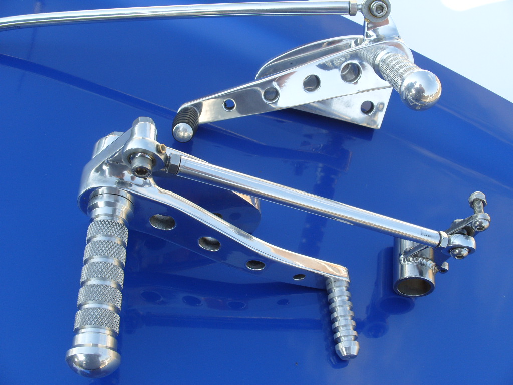

I'm helping a pal build a cafe bike from a CG125....it's a slow process as we have very little time to devote to it. We removed all that stand and footpeg stuff that's bolted under the motor, and had some steel hangers waterjet cut, which we have welded to the frame member that runs diagonally up toward the back of the bike.. This gets the pegs in the right place in our opinion. The hangers have to be splayed outward a fraction to clear the swing arm, and the hanger is then bent in the bottom inch or so compensate and bring the footpeg back to horizontal. We'll be fitting some slightly adapted versions of the rearsets we make for the 500 Suzuki.
The biggest problem doing it this way, is that you lose the stand mounts....and the chain run interferes with any new stand mounted on the left side. As a result, we purchased a stand leg of the correct length from a breaker, and manufactured a mounting bracket which will have to be fitted on the right side.

There has been a big holiday from this project, as we are working in an unheated workshop, so we have waited until the weather warmed up a bit. The rearsets I pictured above, will be used without the mounting plates. The gear side is easy, but the brake side needs more thought. The easier option would be to pull the rear brake with a solid rod attached directly between the lever and the arm on the brake hub, (which will have to be turned through 180* to get it in the correct position). However, a cable operated brake would look better in our opinion, but this will need stops attaching to the rearset hanger and the brake hub itself....so quite a bit more work.
I'll keep you posted !

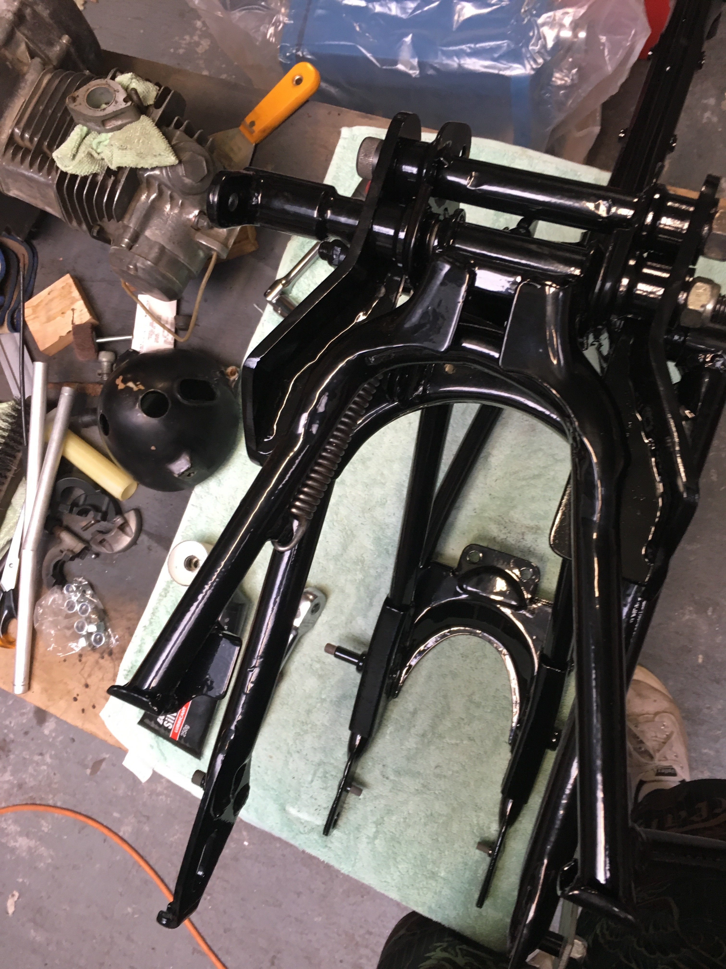

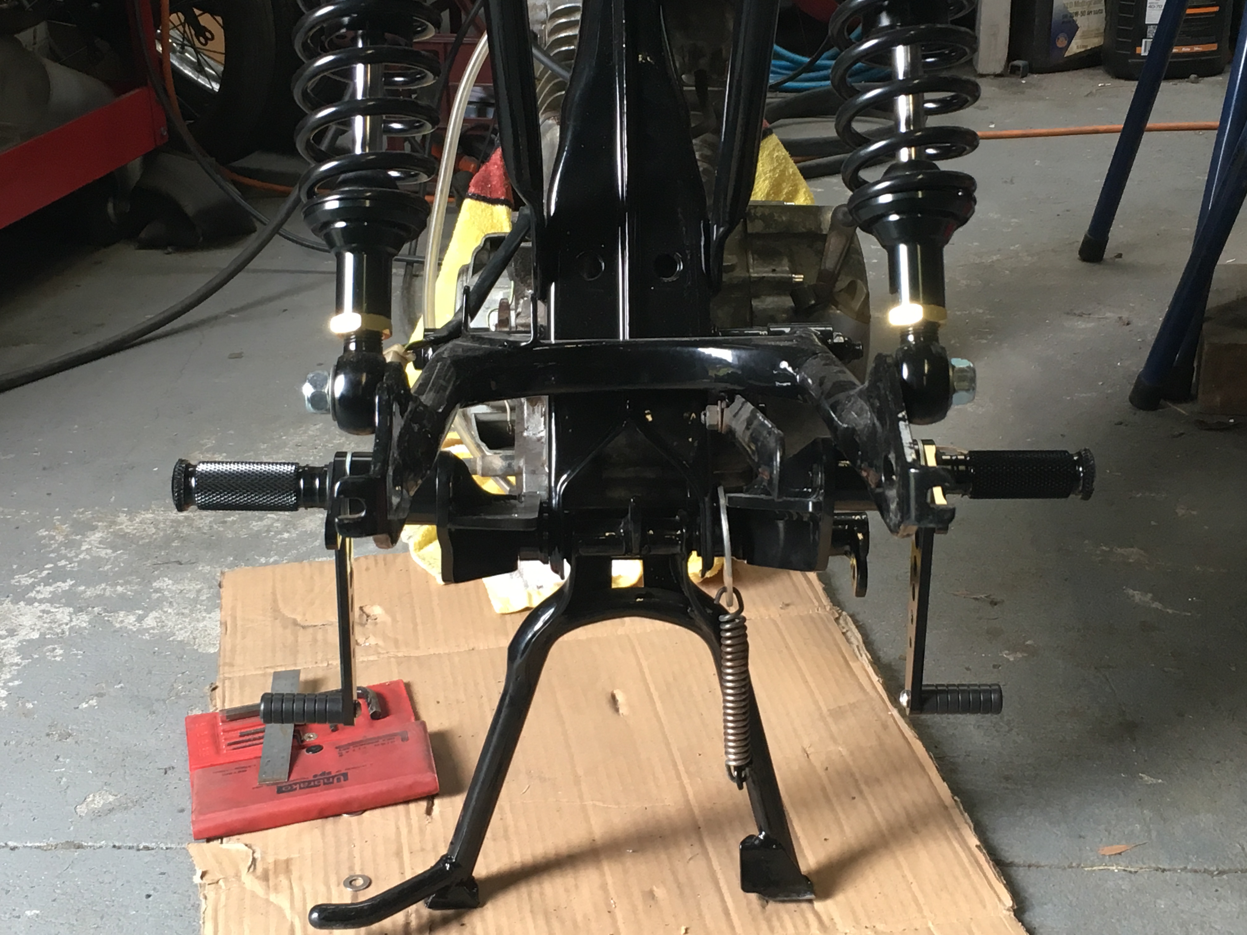

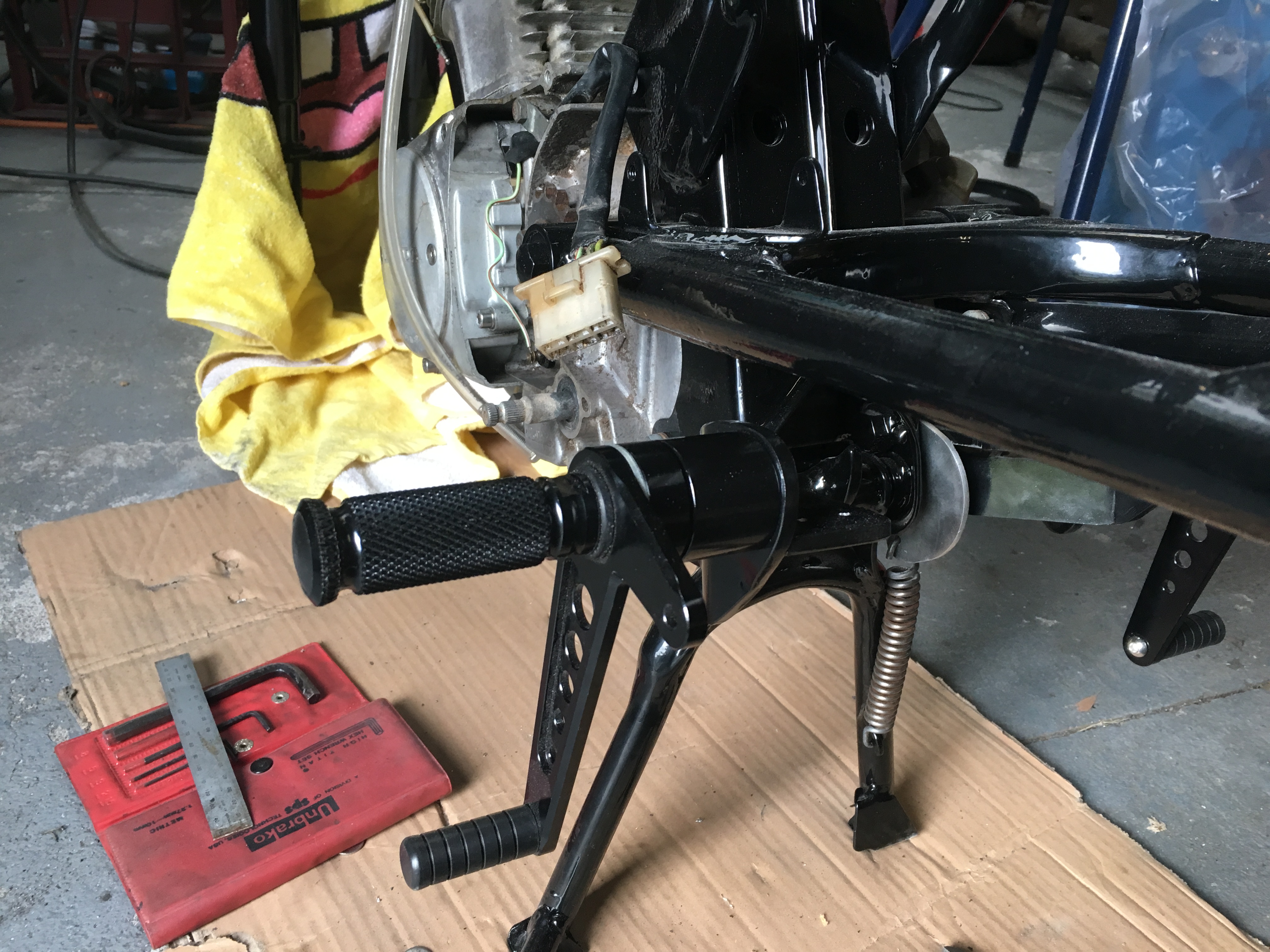

some pics of my rear sets.
still need to make the spacers to move the pegs out a bit further.

Weather has warmed up, so we are getting on with the Honda project.....this has just been loosely put together, but you get the idea.

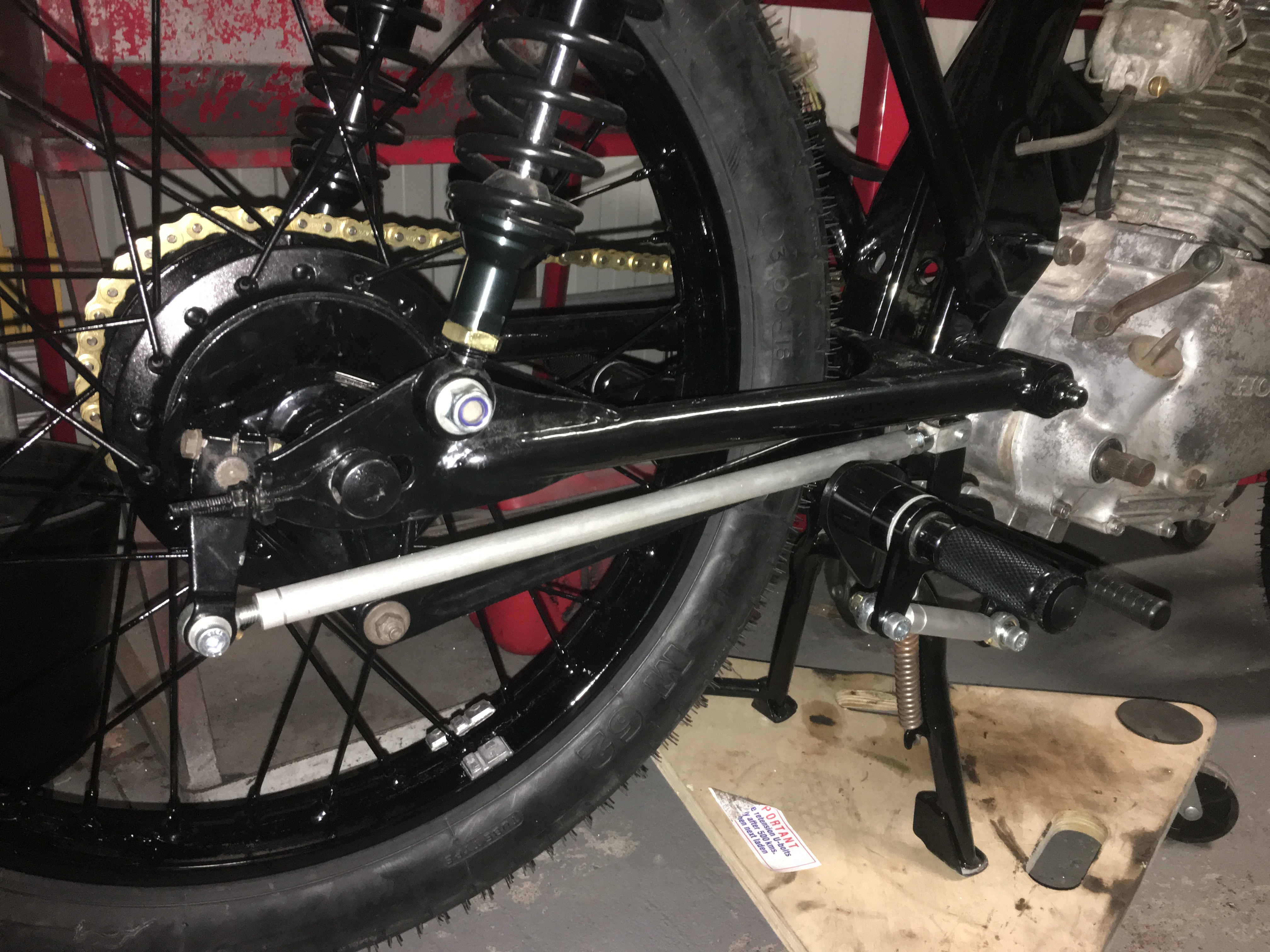

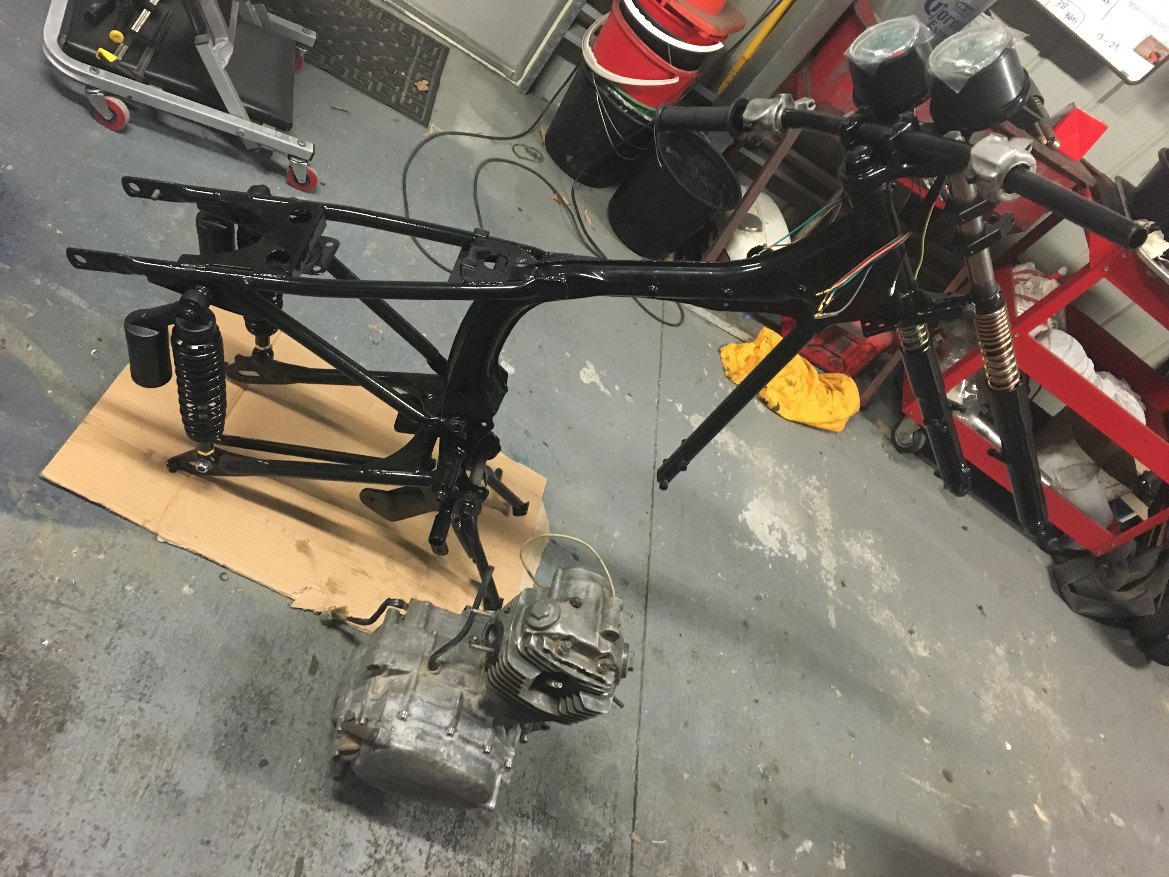

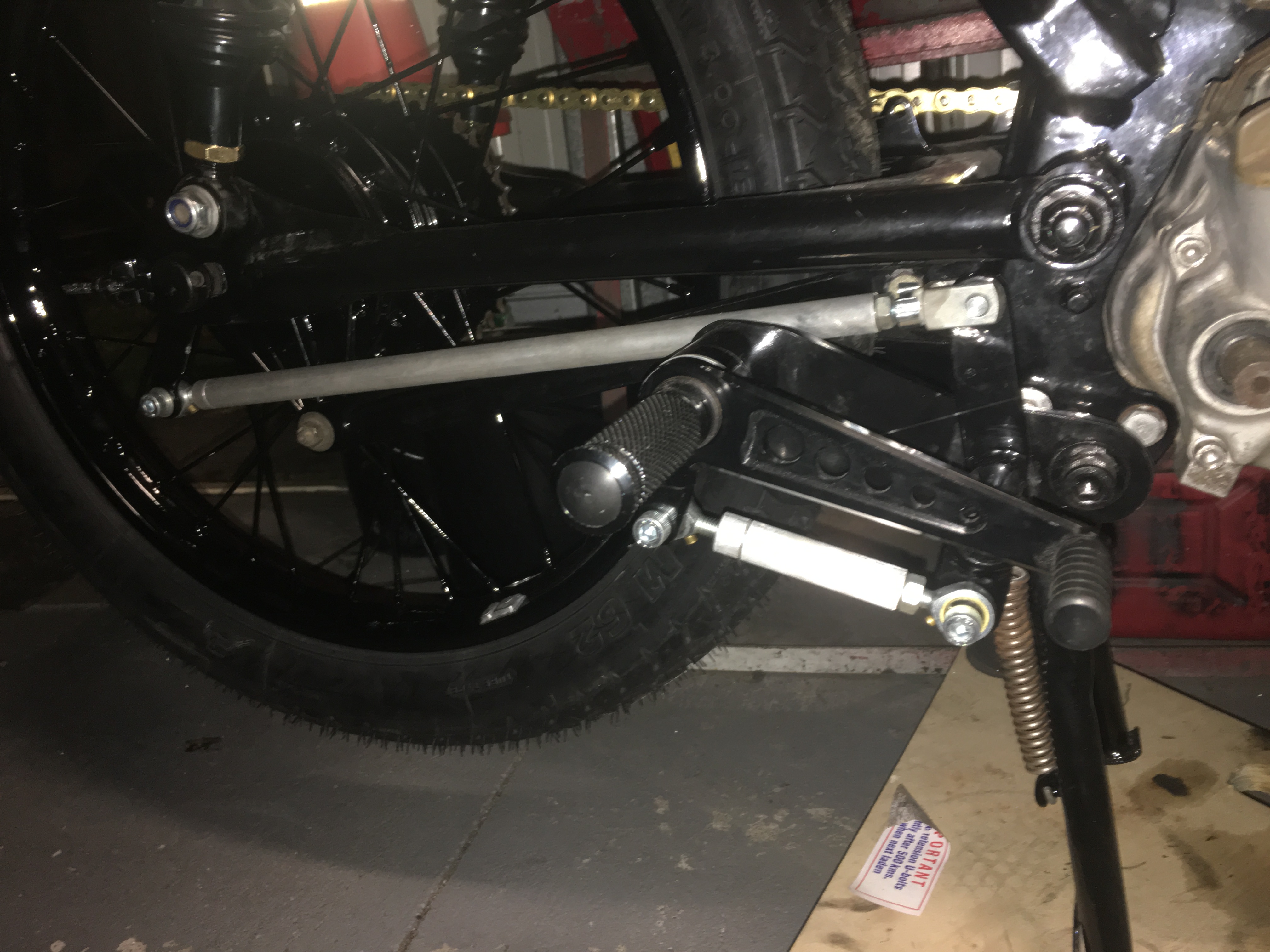

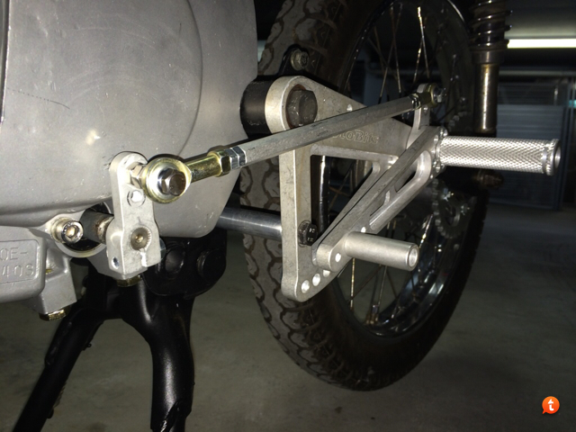

Finished result.
I'm stoked with them.
Everything seems to work really well. Time will tell how they perform and last.
