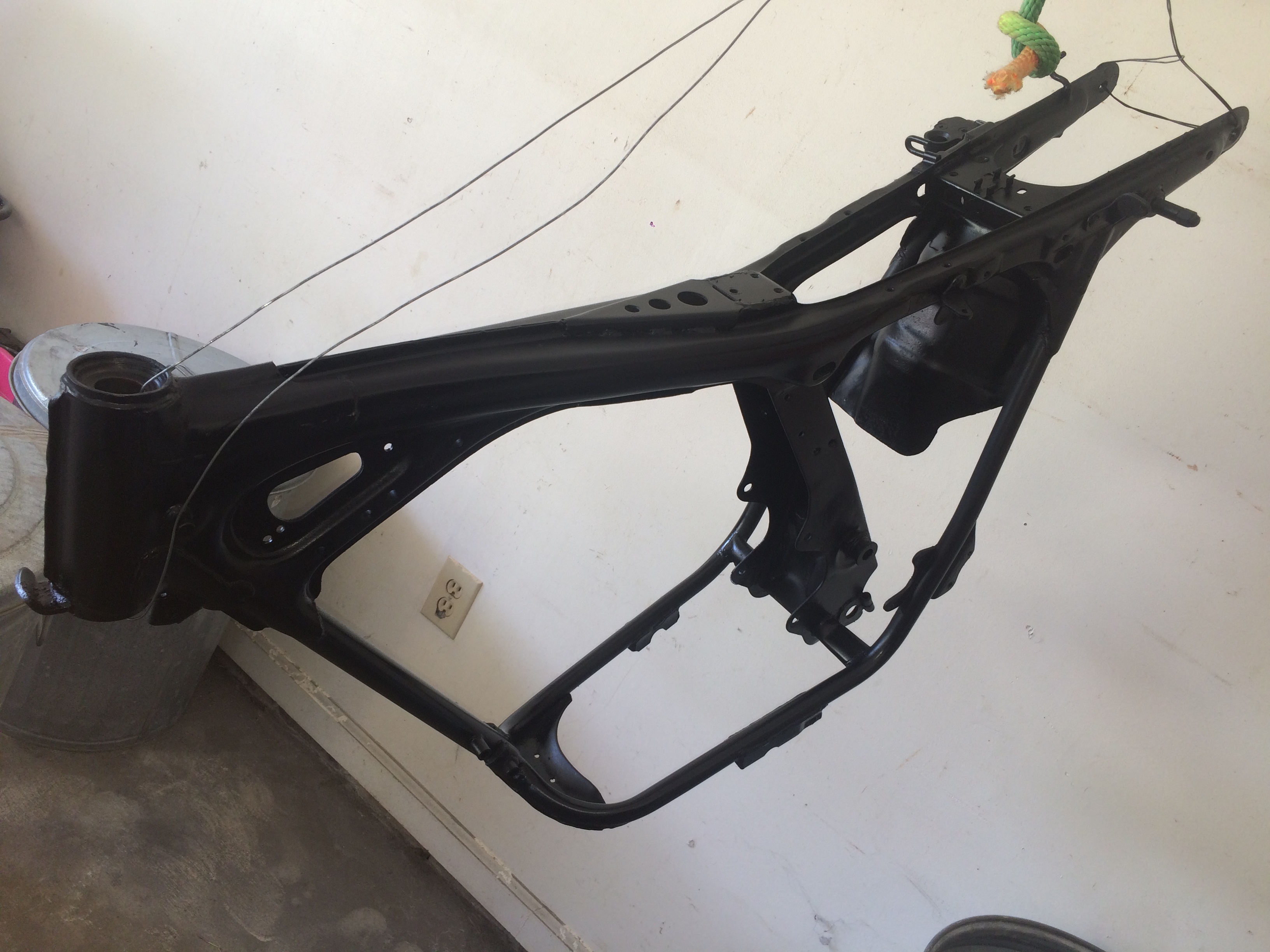

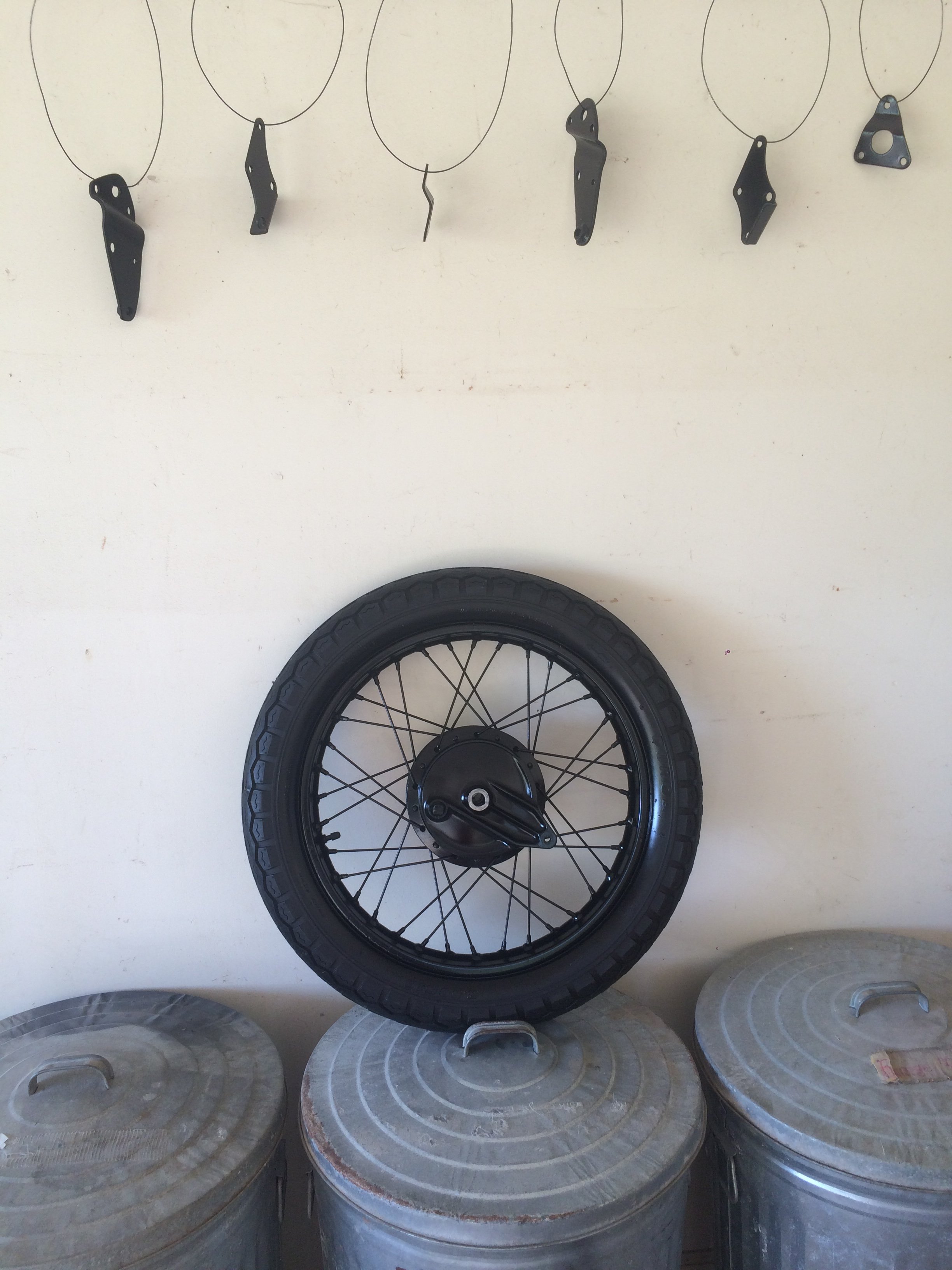

I am in the process of replacing the swing arm bushings in my 72 cb175. I'm looking for a bronze alternative if this exists for the pivot bushings. If anyone has any information as to where I can find some please comment. Thanks in advanced! I attached a few pics from a week or so ago.
