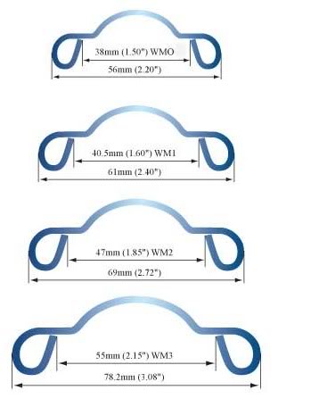

You are talking Rims, right?
then the answer is yes...

that's why I posted the sizes, you can see the rims are only a little wider....You can check your present clearance with a ruler and verify....
