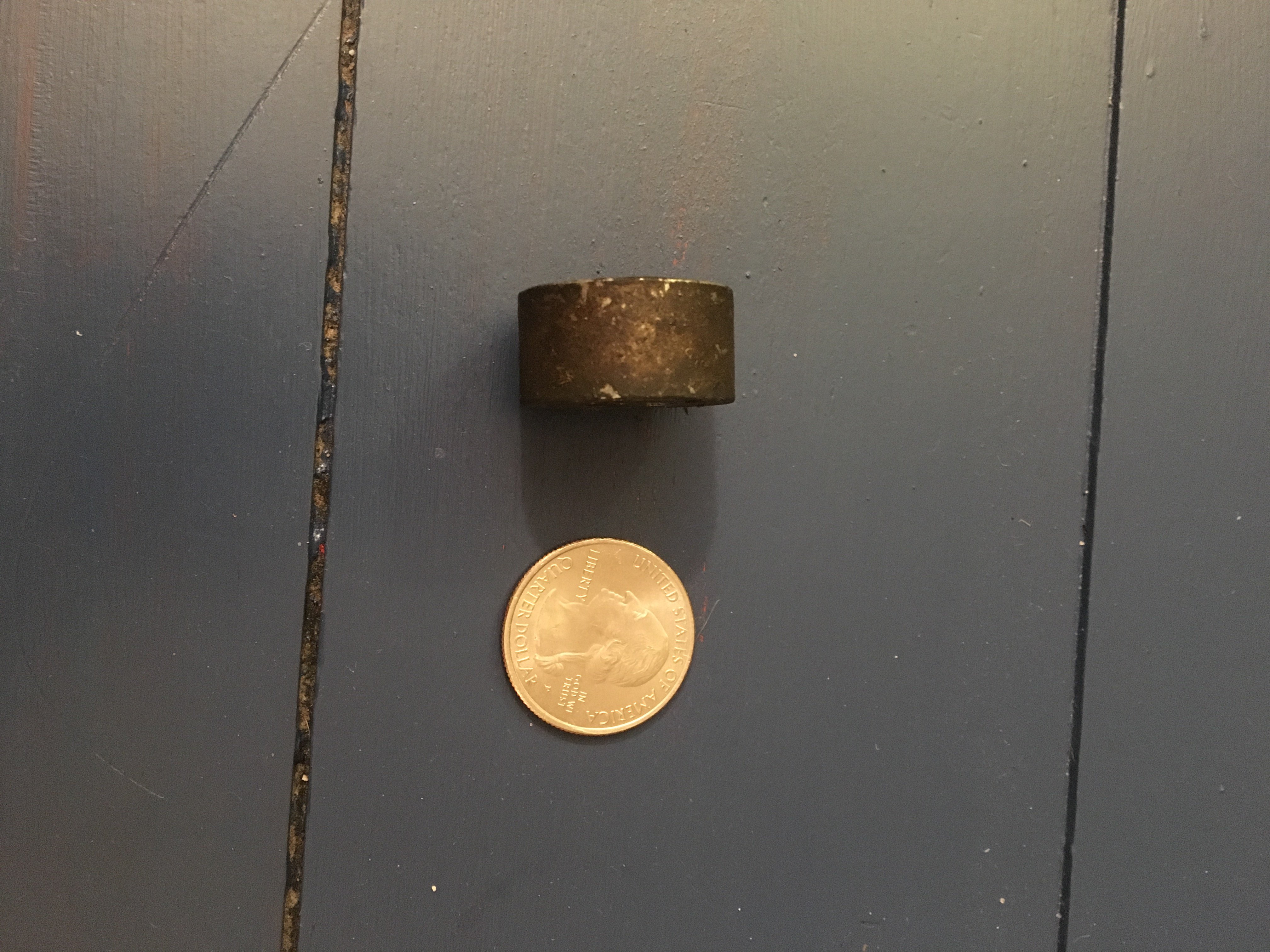

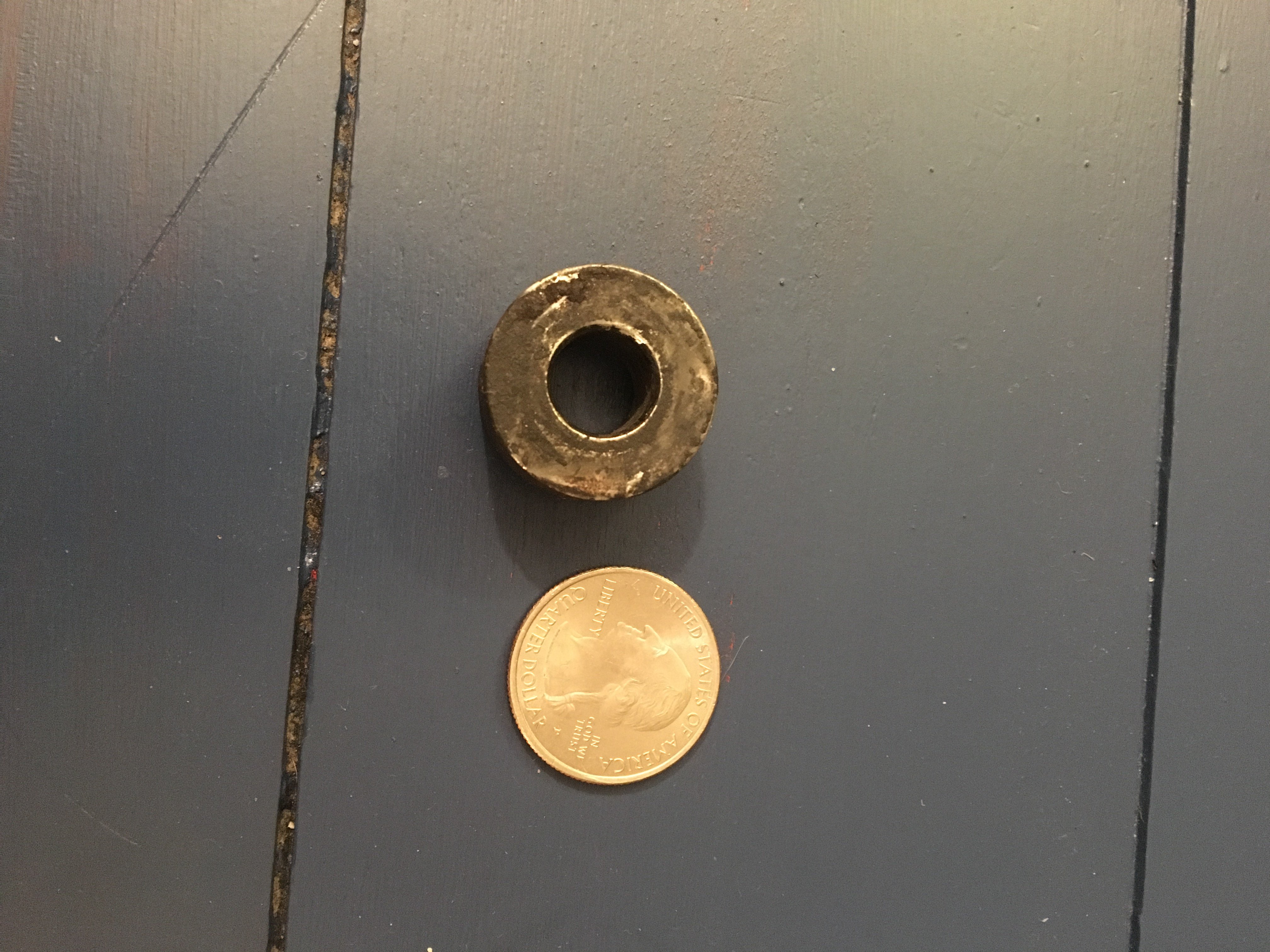

I was recently working on my 76’ CB 360t. As I was removing the motor (rocking it out of the frame) this piece fell from the bike. I have no idea where it goes, please help. I’m thinking it has to go with the mounting of the motor or the rear brake pedal...? It appears to be a heavy spacer or washer.

That one gets guys al the time.
Its a spacer that was on one of the engine mount bolts.
You can find it on microfiche.
Ha. That one got the PO of my current 360, too. I had to machine a replacement.
Yep, I think a few people here had rear lower engine plate cracked or even broken when that bit got left out then bolt wound down. It's surprisingly heavy for such a small part, I swapped all mine to 6061 alloy as it's only a 10mm hole through a bit of bar then face to length
if I had a lathe I would make one - but I went ahead and got a TTR400 spacer kit - $50 not a bad deal
