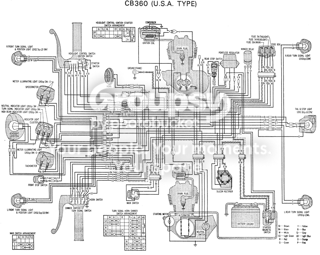

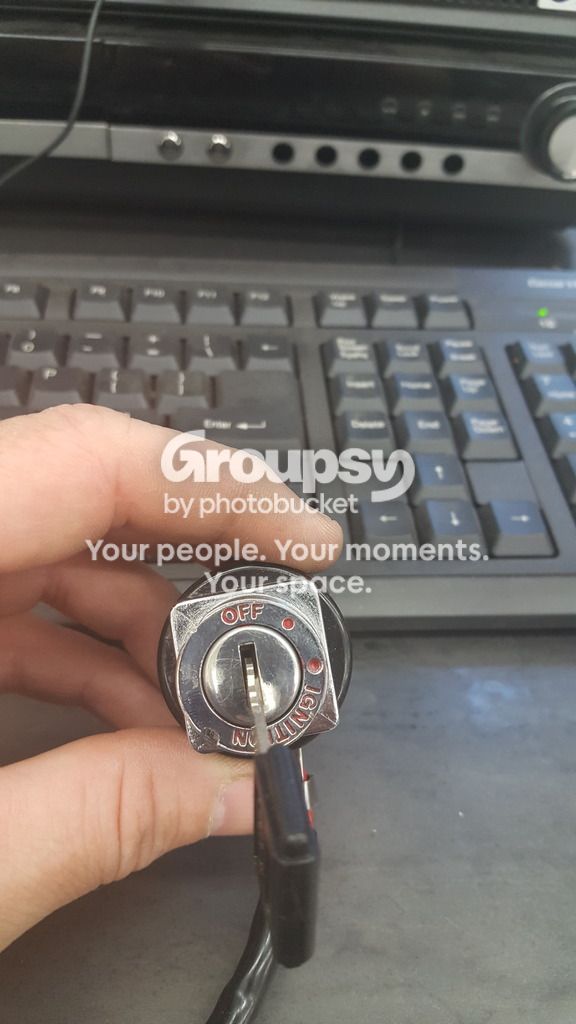

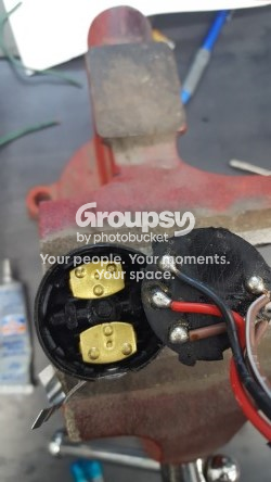

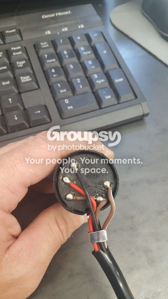

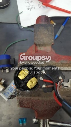

Looking for help/guidance with an electrical issue on my cb360 café. Im using the ignition switch below... fairly common. After getting my build done and going to test the electrical system before start up, with the key in the first position past "off" I would have lights and blinkers like I would expect. BUT...when I went to the next position - where I should just have power to the tail light ... I would pop my main fuse. I began isolating the ignition system from everything else to trouble shoot. I am/was trying to run the solid brown as a running lights while driving - that's my intention any way. SO... I thought there might be an issue with the ignition switch so I started looking at that... (See 2nd pic) here's one of my head scratchers: in the 1st position on, I have power to the red and black wires as expected.. in the 2nd position, I get power to the brown wire -but the main fuse pops. AND... there is never any power to the brown white wire on the switch in any position!!!
When I unplug the brown wire from everything - no fuse pop.
did these bikes have running lights originally? How would I run it for running lights? All my brake and turn signals are 3 wire for using running lights.
Am I missing any other needed info to help diagnose?
