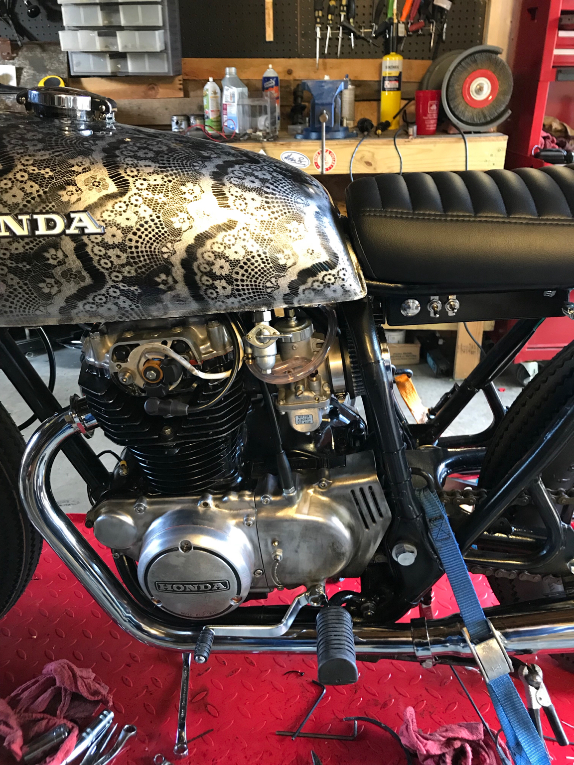

Ya they are vm30s
The pods are the ones sent with it from dime city. They don’t look like they cover the holes. Also it’s flat just revving it without the pods

MiniatureNinja said:
VM30s really are much too large for the CB360. that may not be your issue entirely but it's contributing

You need to go through carbs and check things like float levels, etc.
There is a ton of (mis-) information on VM30's. If you fit new plugs and just let it idle, they will be black within a minute or so, pilot is probably too big Plugs are almost always 'dark' but shouldn't be sooty.. A major issue is the slide cut-away, it's too big in stock carbs so air speed drops as throttle is opened. Low airspeed means you don't get fuel drawn up emulsion tube and motor cuts out.
'Conventional' carb tuning doesn't really work when your pretty much starting from scratch (normally you fix main jet size then work backwards, fine for racing but not so great on the street where you need low/midrange~80% of the time)
Super helpful. Thank you I will try that. Would you say it’s possible to get the vm30s tuned for regular street riding?
