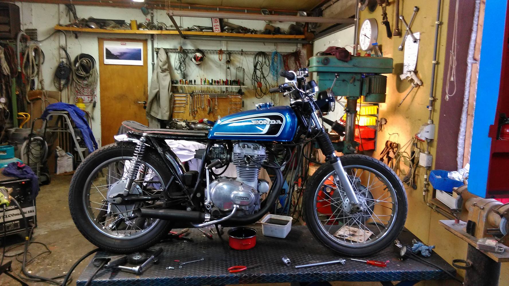

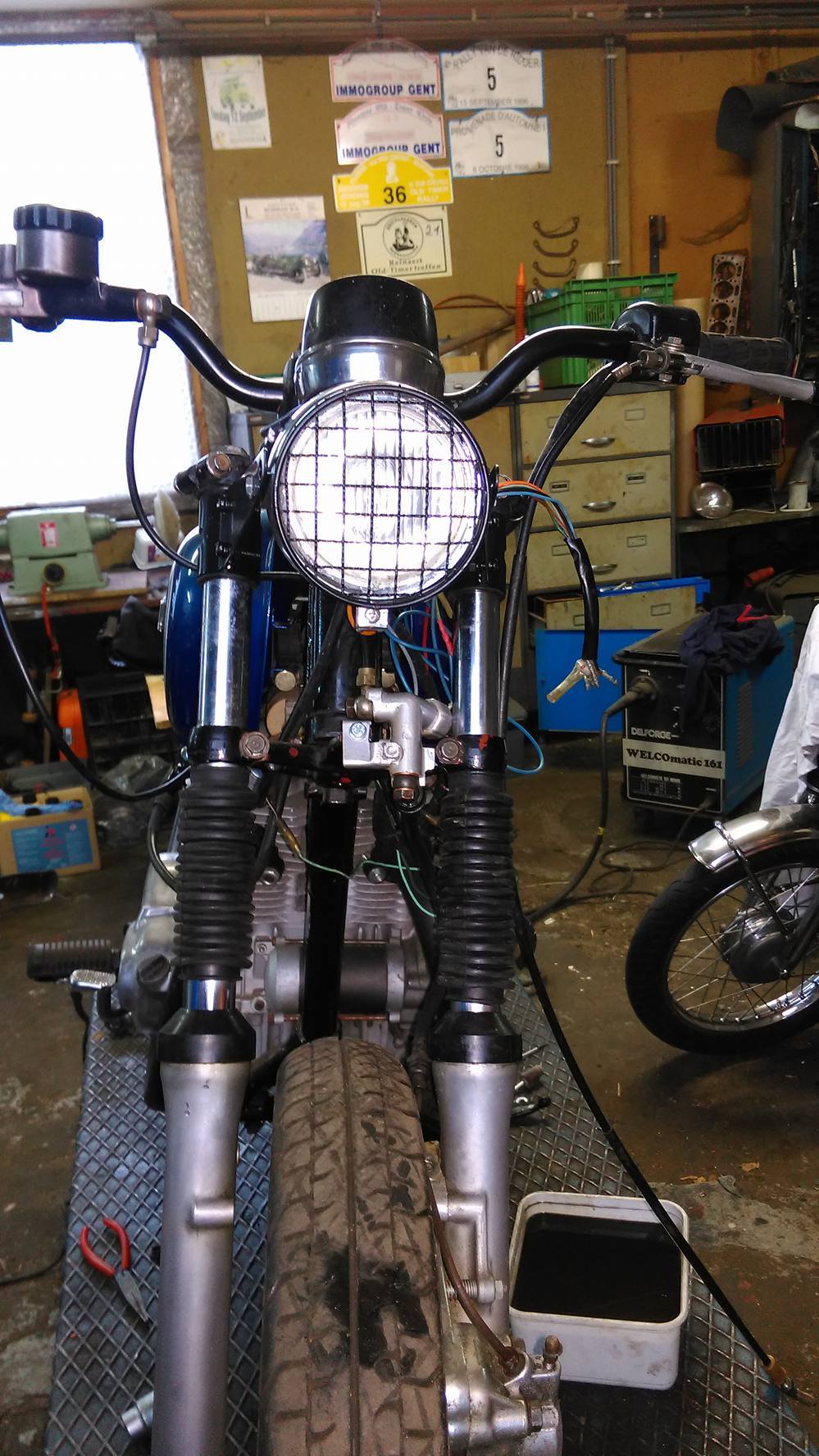

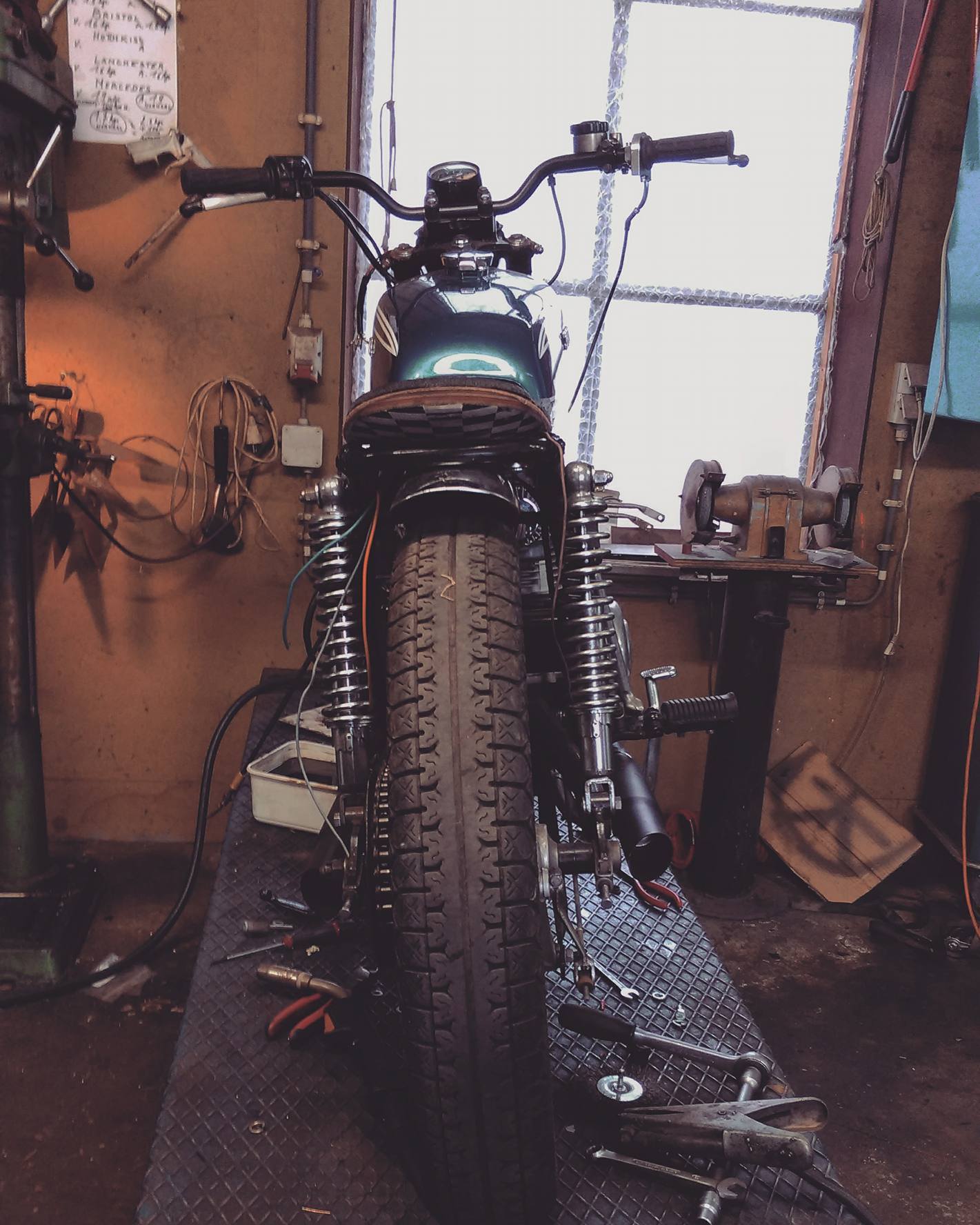

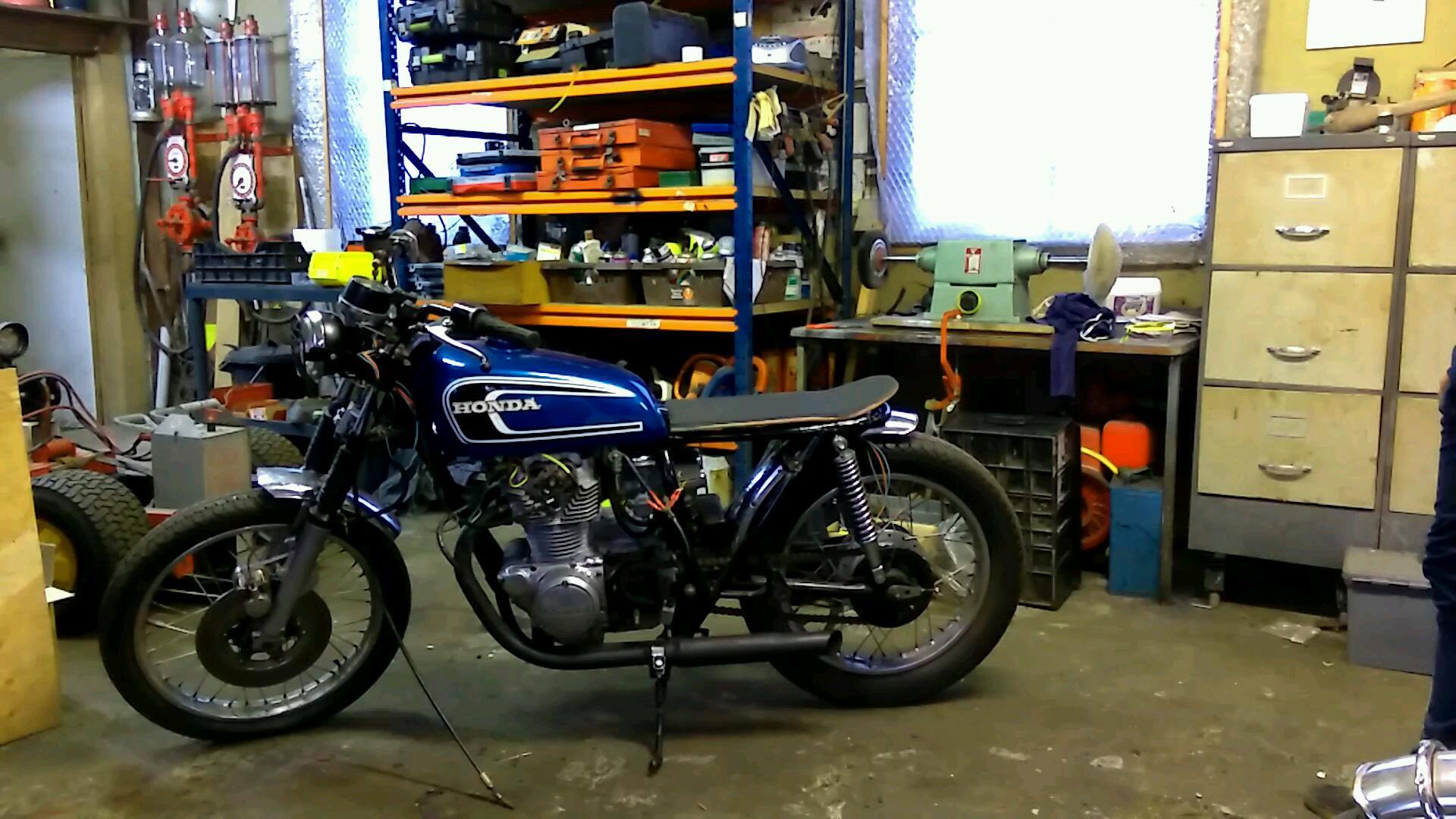

A little bit closer, some will say rough around the edges, then I will say yes.

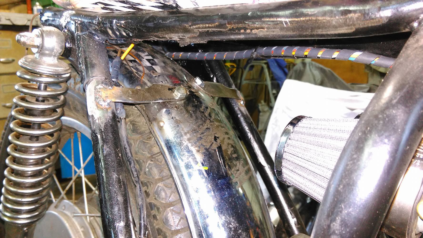

That fender is toast first time you hit a pebble. Heck that might actually rub if you just sat on the bike. You need to measure the actual amount of travel you have to full bump. Remove one of your shocks and then compress the remaining one with a ratchet strap through the rear wheel and over the frame rail. You will quickly see the mistake you're making.
As for my rear loop and the distance between the tire, I can heighten my stock shocks still around 1 cm. Do you think this will be enough?, thx for the advice to strap them down, certainly going to try that.
And yes is is a stock tire, going to change them probably with a more offroady one.
1cm isn't going to make a difference. You'll get a proper idea for it when you ratchet strap the loop and wheel.
I made the same mistake as you. Untold numbers of people have made the same mistake, but it's a learning curve fam.

As a response to the previous question, I have ridden motorcycles but I'm far from an experienced driver. I'm glad I joined the forum as I genuinely like to play around and modify the bike but I don't know much about it. Probably the thing I'm going to do is making the rear loop curved upwards so I will gain 3 to 4 cm's of extra space between frame and tire.
