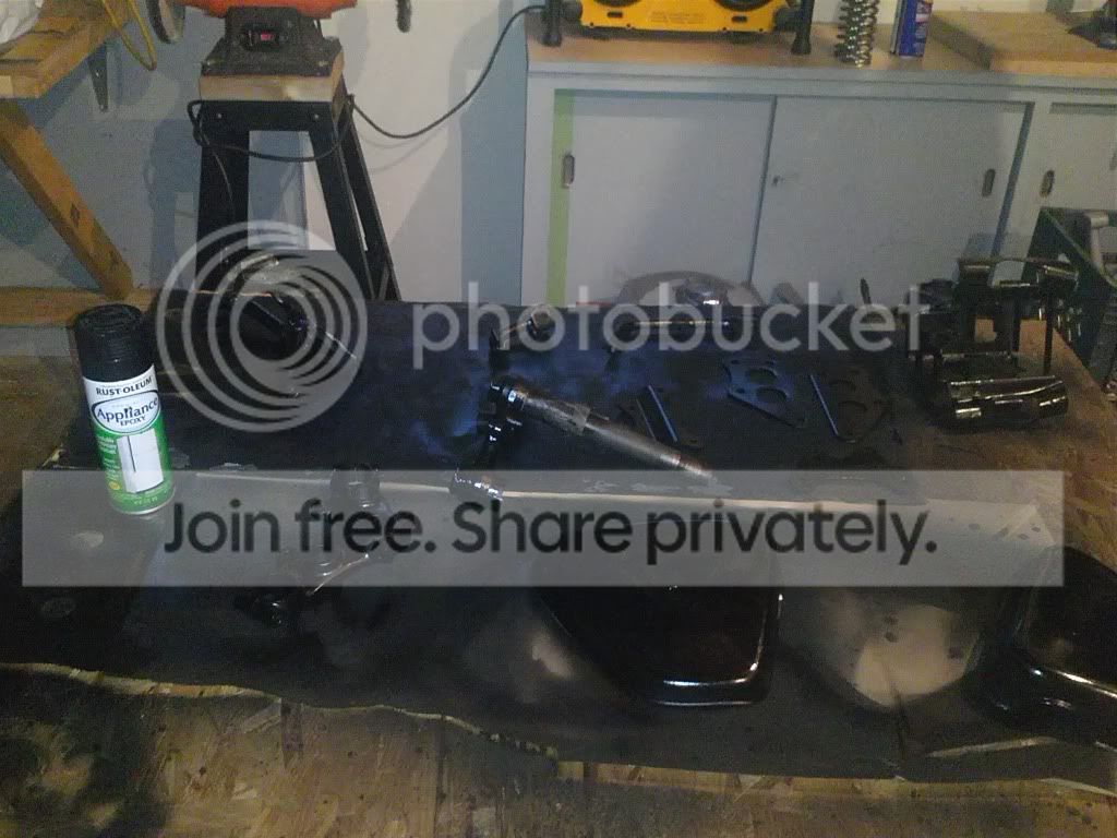

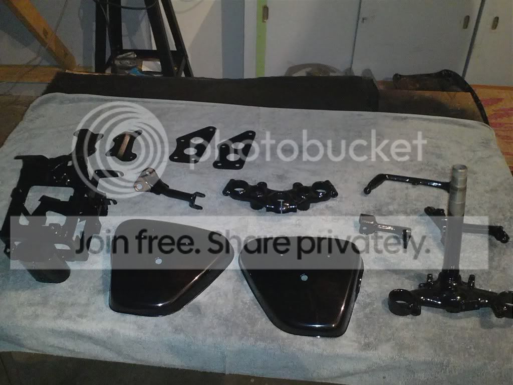

Painted part turned out ok but not next to the frame. So I got a deal on powder coating the rest of the parts. Will post pictures later.
