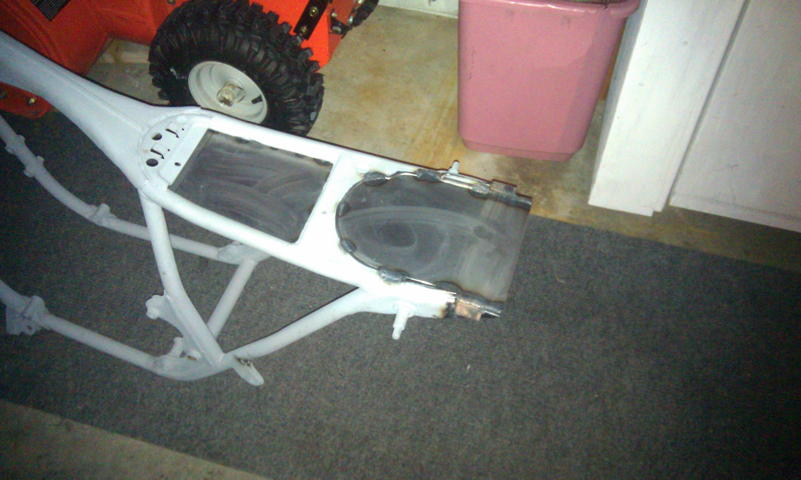

This weekend I made the electronics trays and cut up a piece of angle steel and some gussets for the rear end. I thought about hooping the back, but it didn't look like it would work with the seat I have. I cut and ground an arc in the angle for wheel clearance. I brought it over to my cousin and he did the welding for me.

Side view of the gussets. These shitty cell phone pics don't do it justice, it looks really nice. I post a few more after I get the seat fit and some final shaping done on it.
