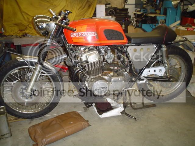

the tank was marked gsx 250...the front mounts had to be raised 2 inches, the bottom lh side bottom had to be profiled (recessed) for linkage clearance to allow the throttle to open fully and a rear mount added... hopefully it will all come together and look good in the end...joe@ v cycle
