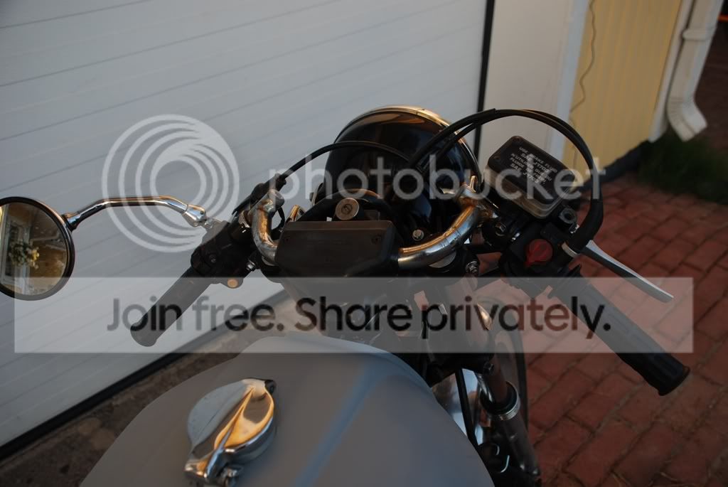

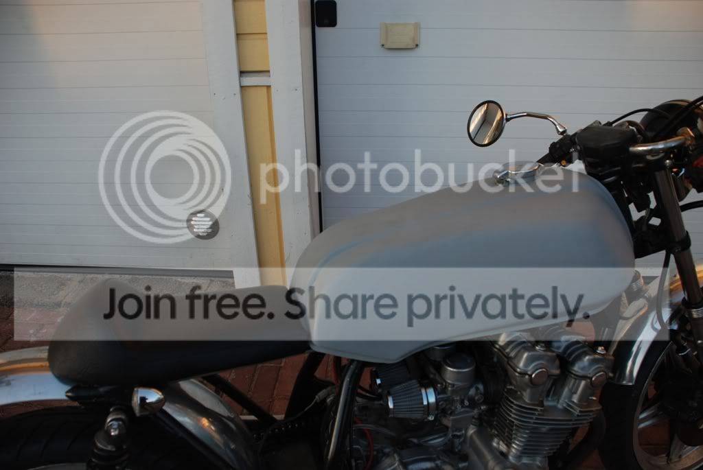

The tank got a little extension to the back, my bodywork really sucks. The tank is very uneven and rough. The fillercap is of an CB125 tank. And the instrumentation is also quite basic ::).

Thank you cbcafe, I suppose you also is building a caferacer out of an Honda CB of some kind :) like those! The tank is of an CB750F, it is about 8cm longer than the K's model. The back of the tank is also raised a little. don't remember exactly how much but if you look closely on the picture of the tank it shows. My friend made that also, got to love those kind of friends :D don't you. The filler neck and cap is replaced with an CB 125 item. The latch on the cap broke when I filled her up last Monday :( . I don't know how I'll fix it yet. I'm dreaming about a alu tank from WBO racing in Germany. It's for the sohc frame so it has to be modified to fit my frame!
