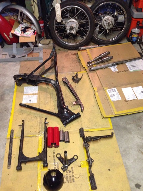

Been a bit slow with progress lately.
Got the tank mounts welded on last week. So was able to completely strip it down ready for sandblasting and paint.
So here is how she sits now.
Engine has been blasted but no photos. It's at the mechanics in parts. Needs a few new gears. So they are on order.
