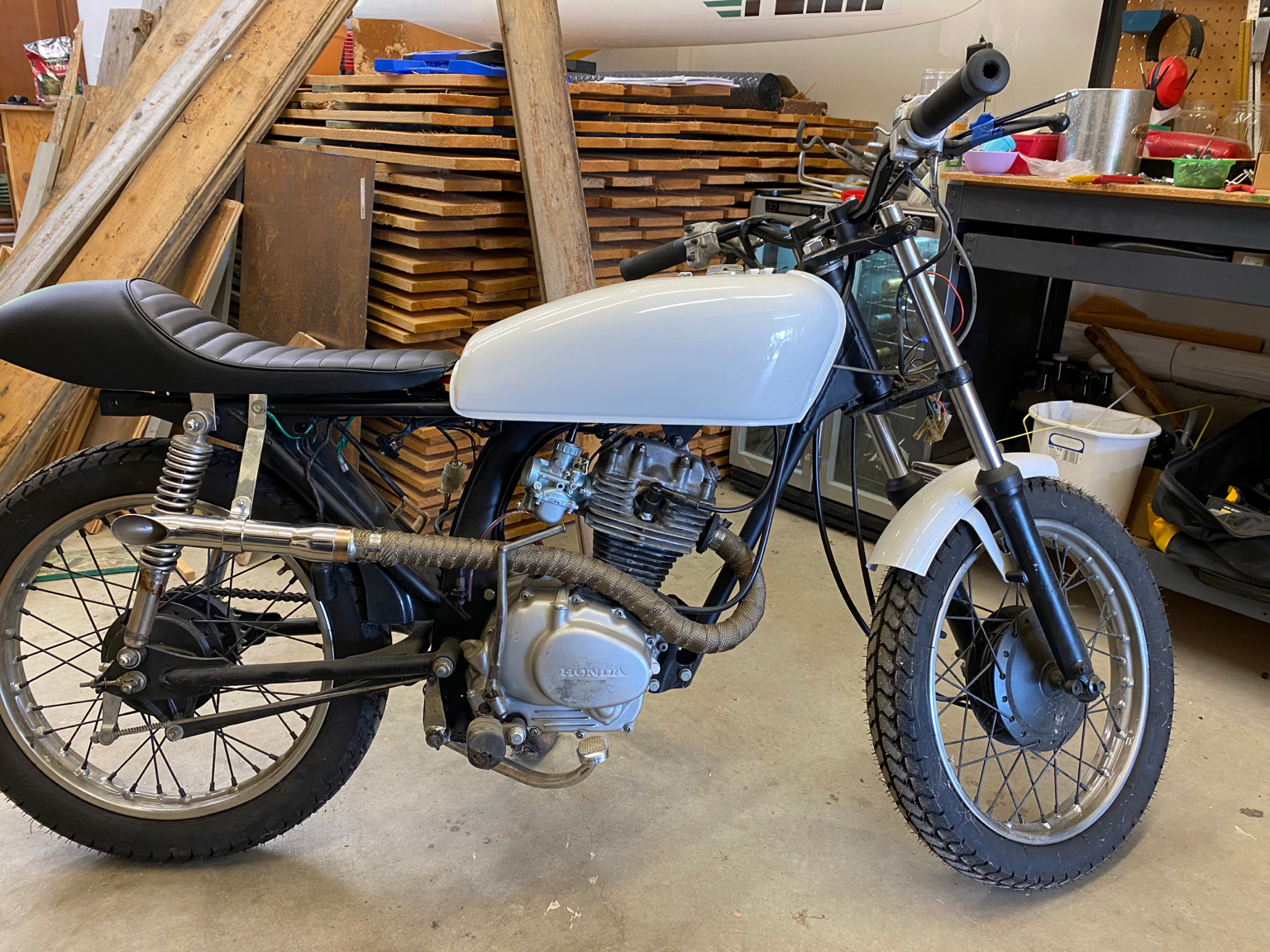

Well, Memorial Day didn’t happen due to COVID, but I did get a week off so I’m back home and trying to get some work done. I bought another carb, seems like a much better VM22 copy so we will see. I did notice the float was bent on the old one, maybe that was the problem.
Today I got the new seat mounted, I liked the eBay seat on the Twinstar so I decided to buy another one for the 125, and I’m pretty happy with it.
Now that the seat mount is done, the tank is soaking with some CLR and water to get prepped for RedKote. Once that’s done I’ll brim it with gas and try to get it started using the new carb. In the meantime here’s the latest pic!
