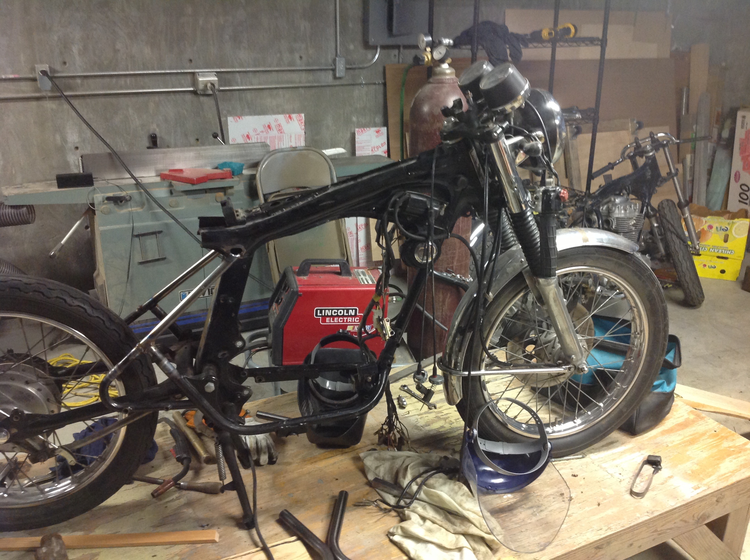

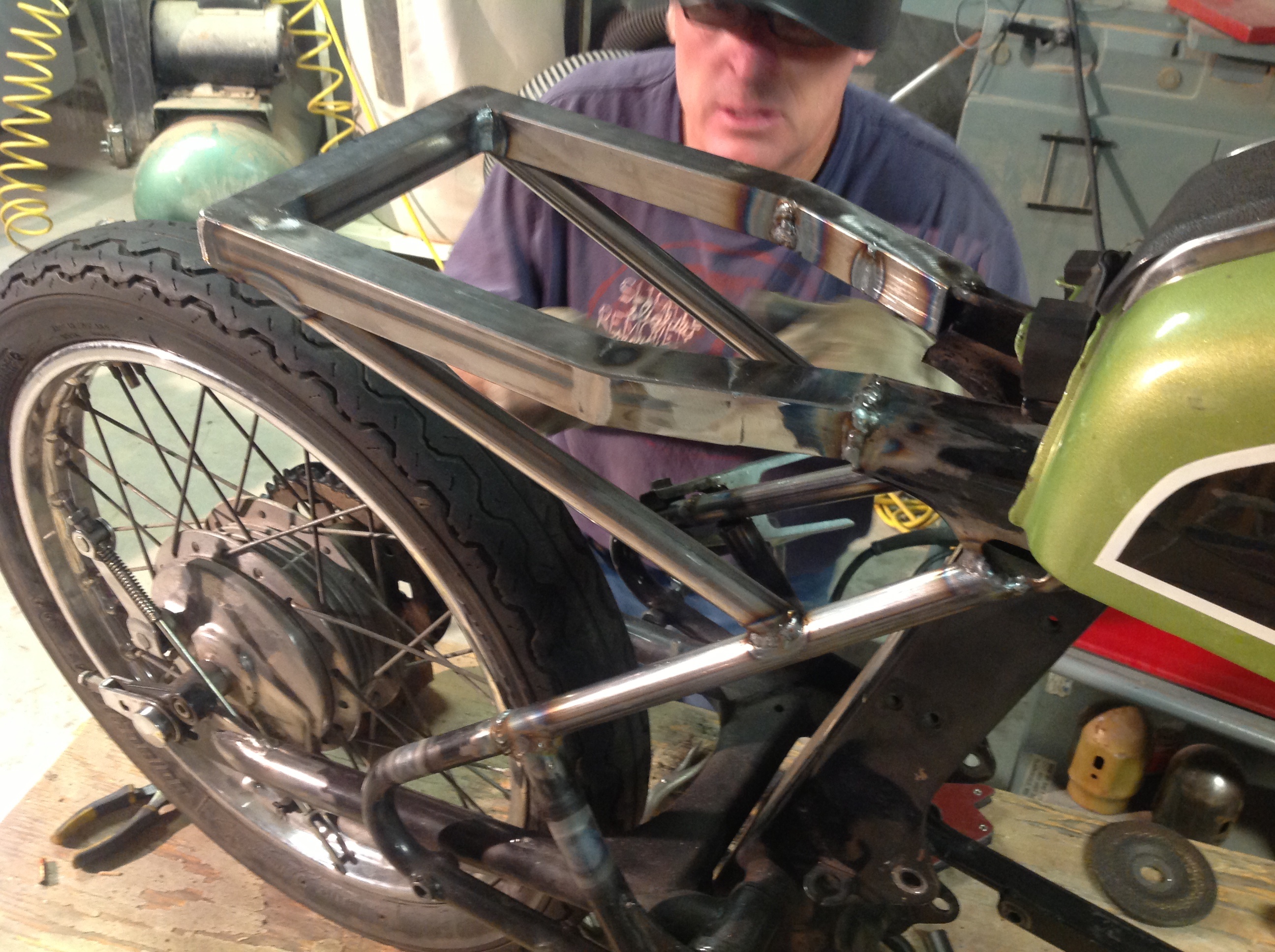

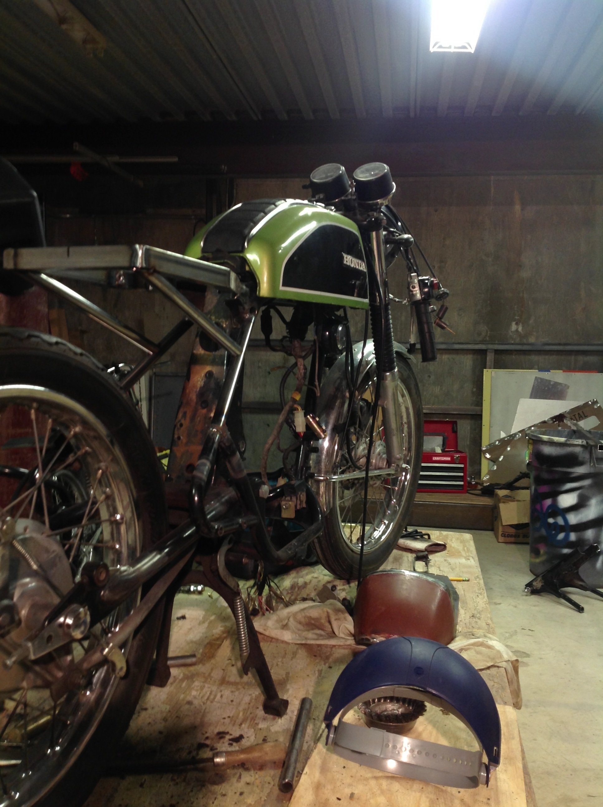

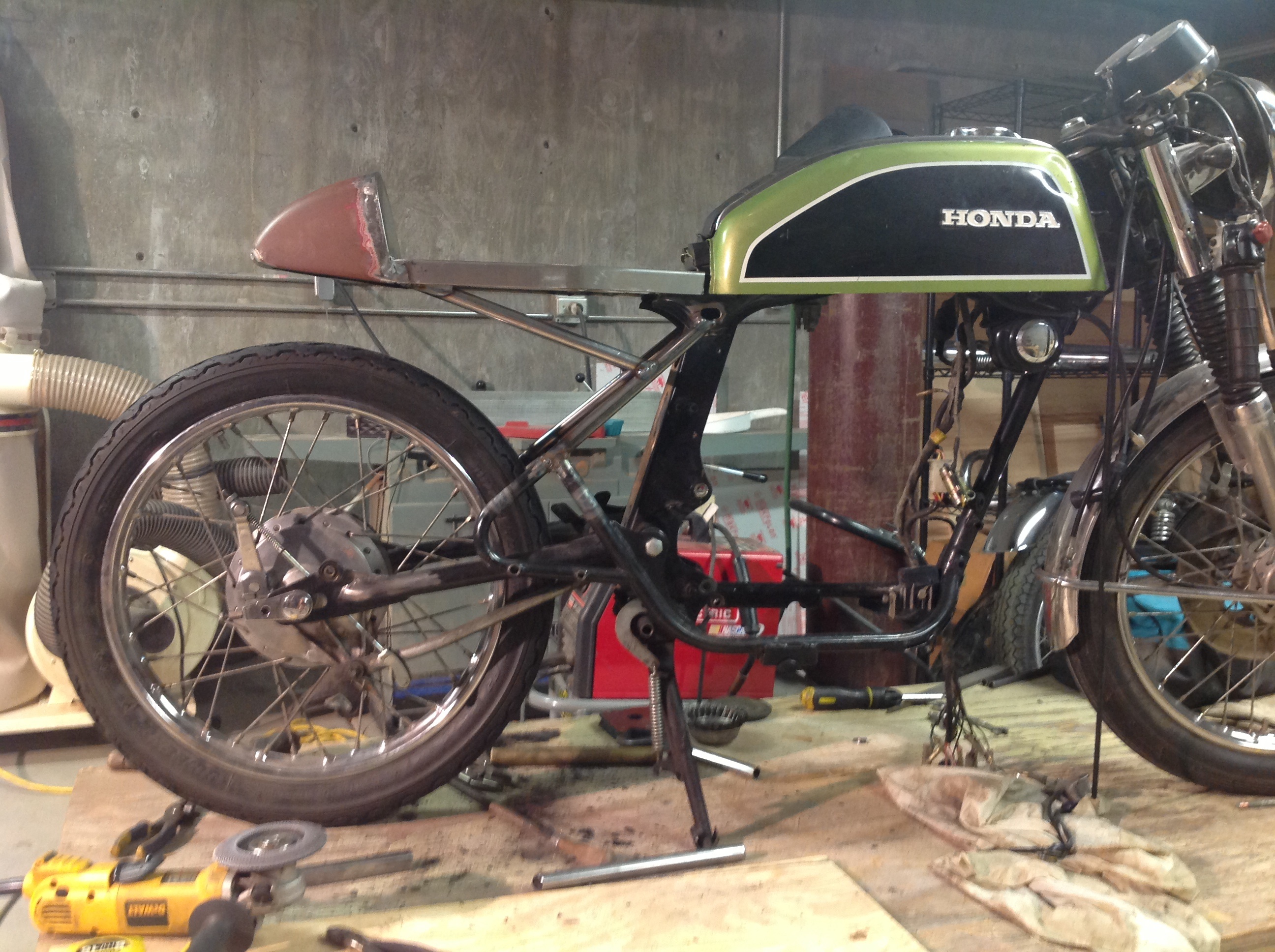

Getting stuff done!!!!!! 3/4" tubing and 1" square tube.

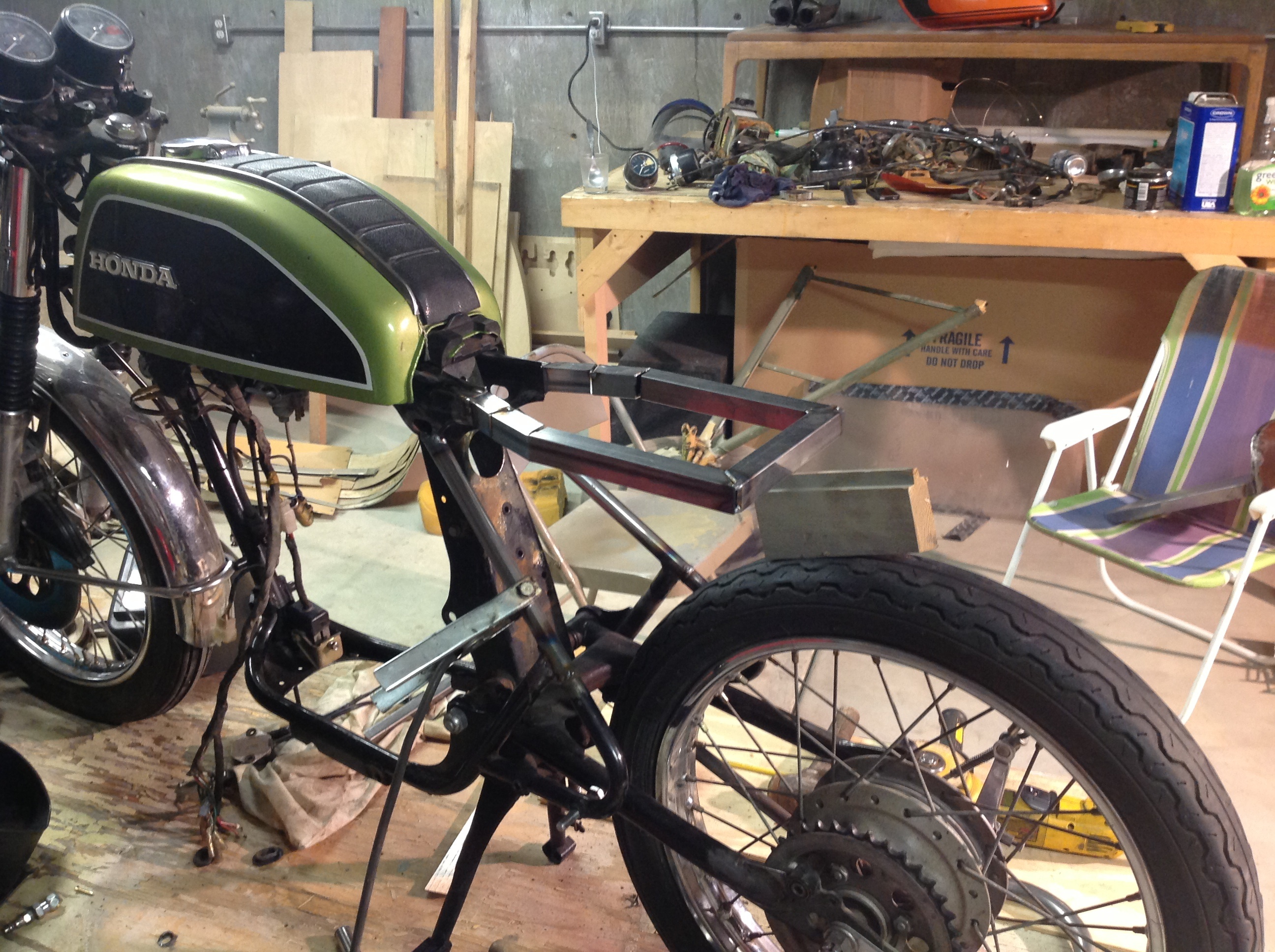

A few ideas/ mockups.. I need a shorter shock I think.

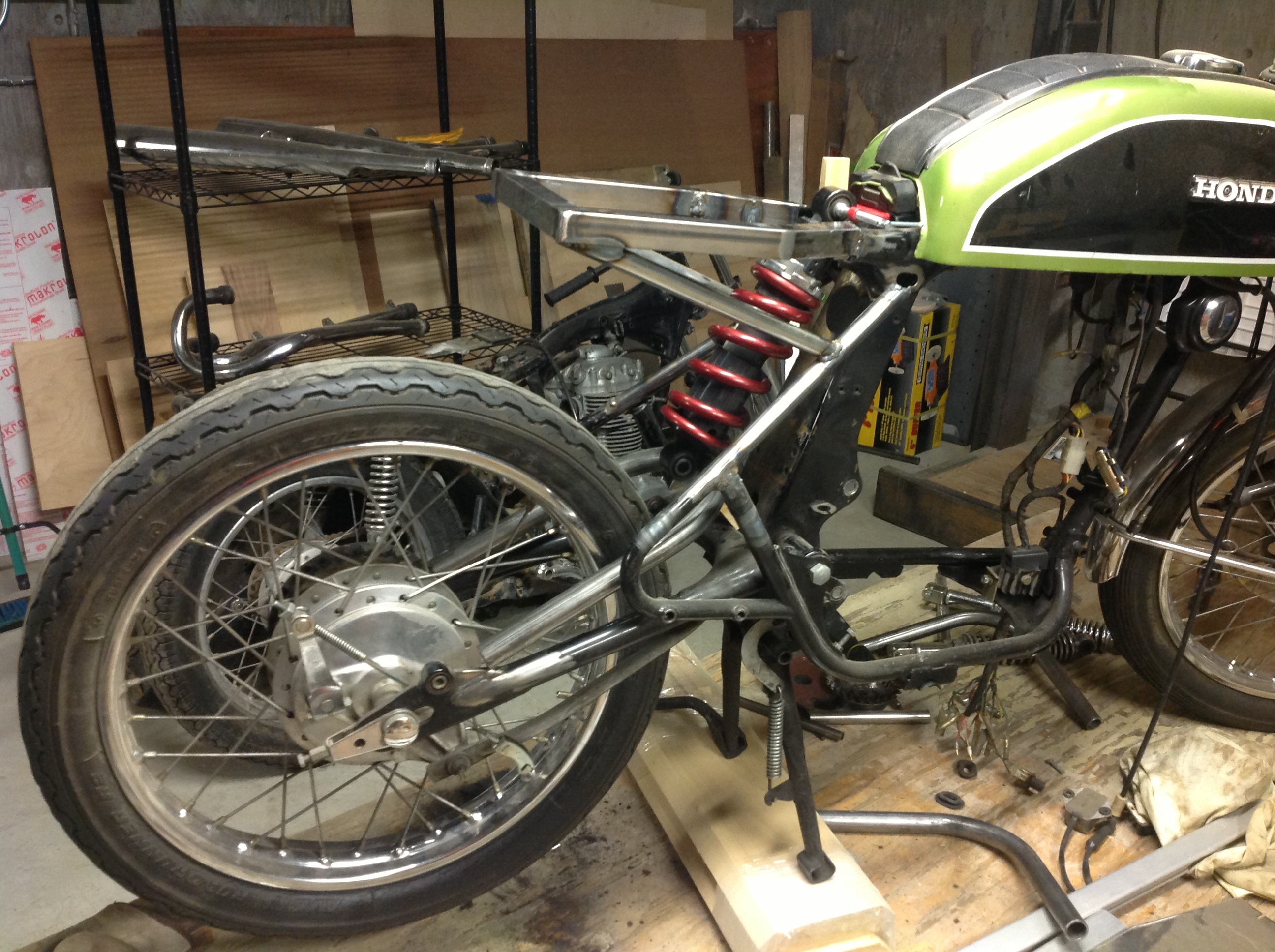

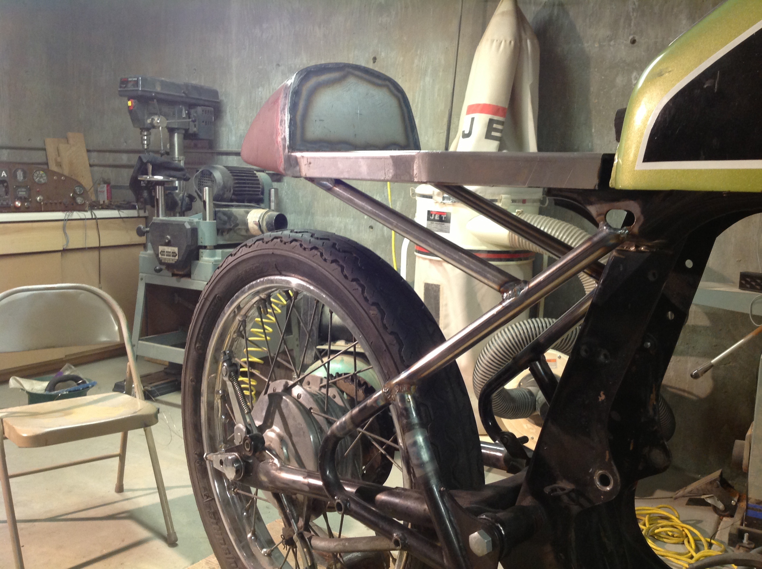

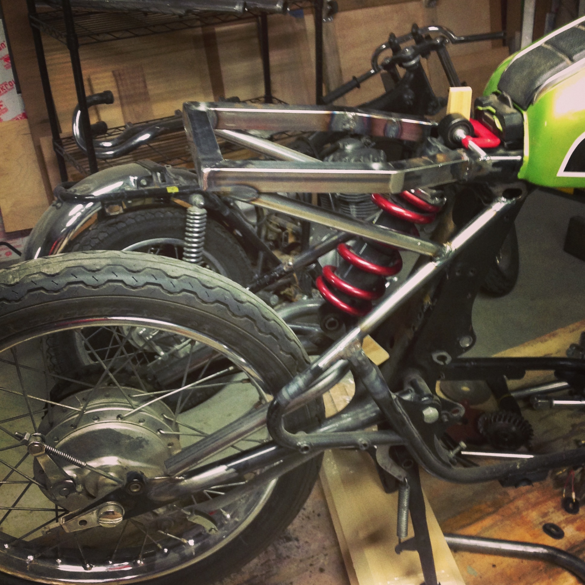

So I really owe everybody an apology, it's been my responsibility to keep up with this post, but my schoolwork has been piling up as well as my actual work. So the bike had to sit, until last night when the warmth reminded me why I was building in the first place.
So I finished up my whole rear suspension!

I can't see the front triangulation on that loop. Please explain how the rear suspension works.
