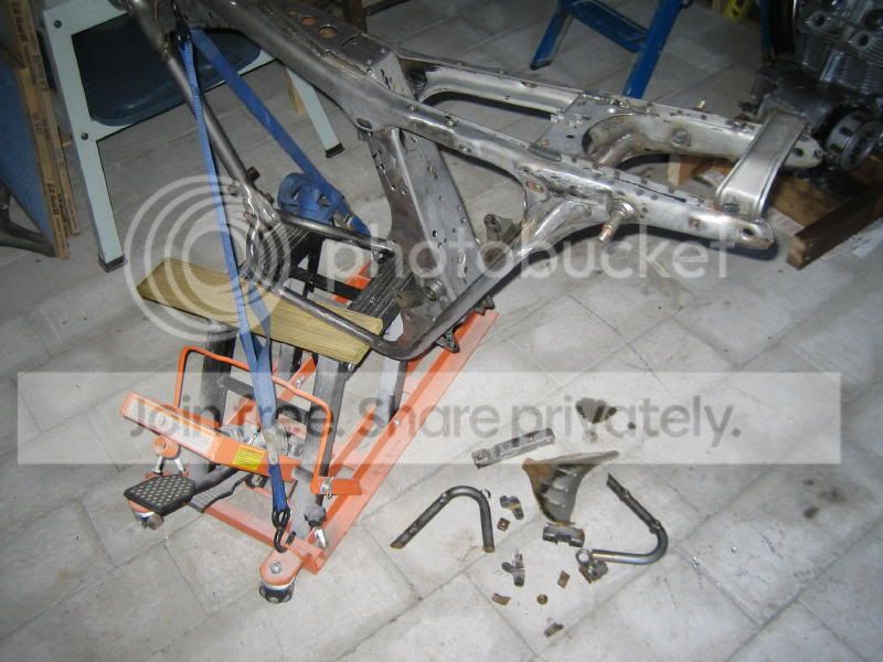

Well here we go, this is the before shot. hope to be finished in a different color and rebuild the motor etc.

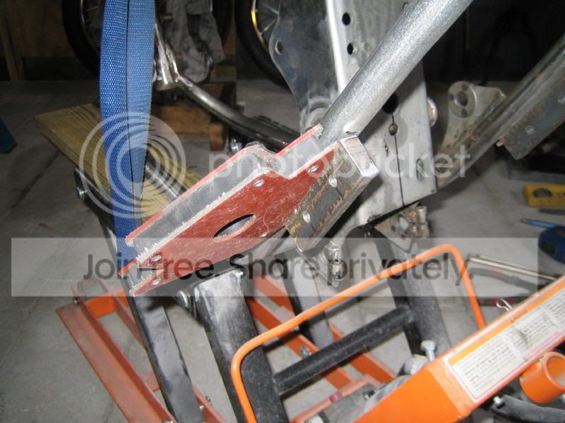

Having fun with the cutoff wheel.
fabricated rearset mounts and tried out some hole saws on the frame.
with that completed, onto frame bracing with a detachable stone guard.
Thanks for letting me know about this site Brent!
I see in this photo of your "before" that you mounted the rearsets on the original rear foot peg arms? You welded on the tabs & cut that stuff off just for looks?
The way my rearsets attach required a tab like the one I fabbed. The before shot shows how I "rigged" them up with a acc. clamp and an existing hole. Alot cleaner with the new mounts.
NATE
dont get me wrong, the mounts look clean, but dont you think they are a bit of overkill? I only ask because I just finished fabricating some tabs to hold my rear sets and in comparison to yours they look absolutely flimsy. That being said, I feel like my tabs made out of quarter inch bar will be more than sufficient to support my weight, but I have to admit looking at your tabs makes me question my design.
One reason mine are thicker is because they are tapped so I woudn't need a nut for the mounting bolts. To me 1/4" sounds a little thin thinking about someones weight on them and especially the braking side. Might flex under hard braking.
NATE
ya, Im welding the nut in place on the back side since I dont have a tap and dye kit. As for the thickness, I def think anything thinner would be a bad idea, but Im like 135lbs soaking wet, and I put 90° bends on the tabs to help brace them against any flexing (Im using two tabs per bracket instead of one big long tab).
I think its important to think of the next guy when you are building these things. I'm 235lbs. soaking wet. Are those tabs going to stand up to me standing up on them? I'm not criticizing here, just food for thought. I like to think the bike that I have that is 40 years old will be around another 40. Who's going to own it next?
