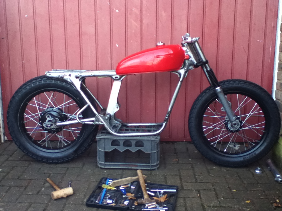

Progress so far, new rims and tires/ cb175 tank, next job a few frame mods.
can you share what tires and sizes those are? Really like how they look.
Cheers! Its the stock rim on the front with a 3.50 Cheng Shin C180 tyre and then a new wm3 rim on the rear with a 4.00 Cheng Shin C180. Think clearance is fine probably 5mm at least at the front with the front forks either side and as far as i can tell loads at the rear, probably as large as you can go without major mods as far as i can tell. Liking the progress on yours sbaugz
