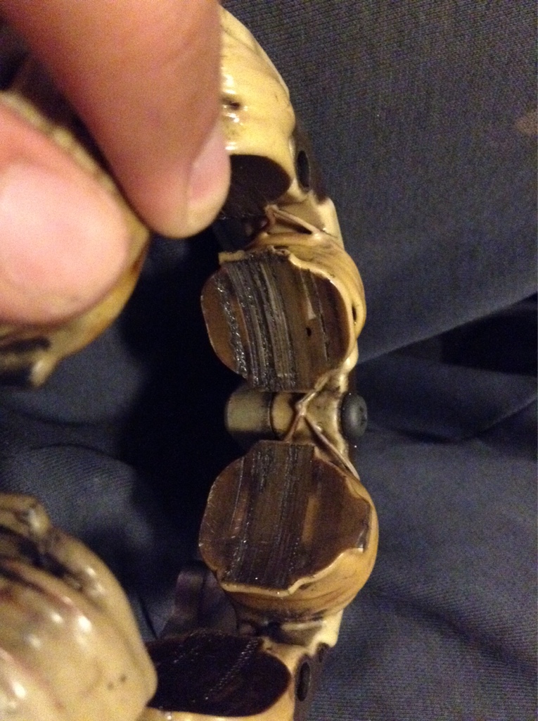

Here is a picture of the alternator coils

Unfortunately i just watched the video and your stator is not spinning concentrically. It is minimal but will be extreme when running. The bike was wrecked or laid down hard at some point.
Yes, i would look for a bottom end. It can be fixed but it usually takes as much or more in labor to fix that as the cost of finding a bottom end does. Not to mention tou're gonna need accessories. Maybe watch for a whole engine.
