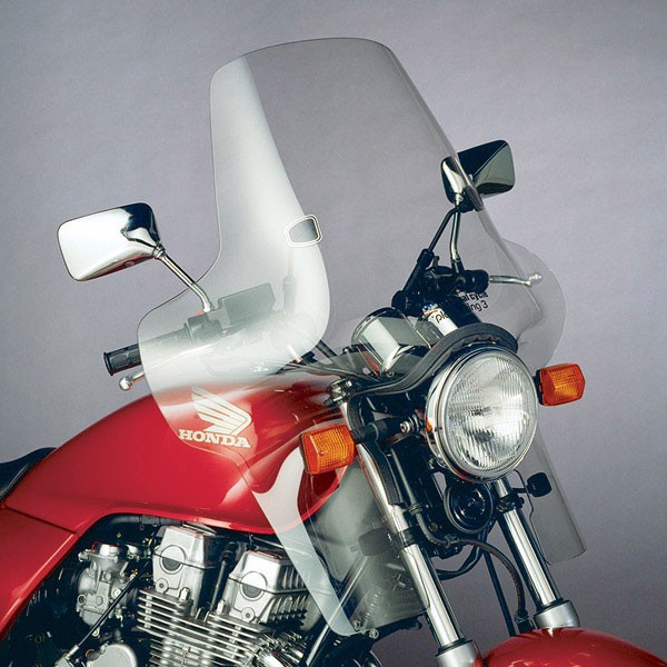

I wonder if you could take something like this, and paint the bottom half to match the bike and look like the fairing and leave the top half as screen?
make your own style without a fairing......it just doesnt look right with the fairing
