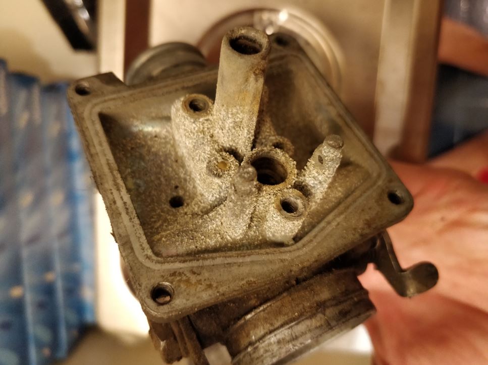

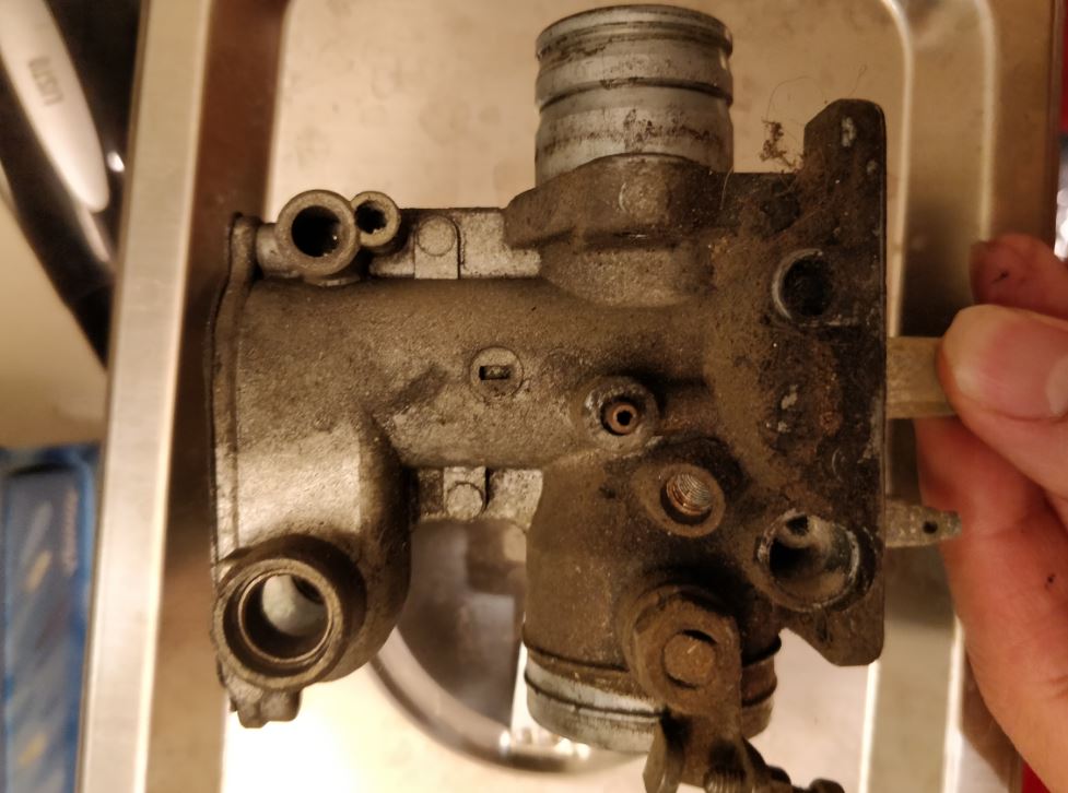

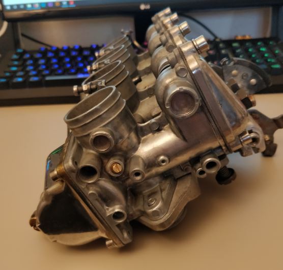

Anyway, I've finished rebuilding the second set of carbs, god I love my ultrasonic cleaner.

If they run as good as they look, you've done excellent work on the carbs! Keep a lookout, ask around, and you will probably find some small one-man shop that will true your wheels quickly for little money. I found a shop that ground all of my GL1000 valve seats for $10 in 10 minutes. Also, make sure the tires are true. Every so often, they can be really out of round. I had a set on a Suzuki SX4 (4WD version of a Swift) that went from awful to great just by mounting new, round tires.
Thats great news on the carbs.

Thanks! will have to wait to rebuild the engine to try them. But I've cleaned each carb individually with 4 ultrasonic baths per carb, then fined cleaned the residues with a dremel then rebuilt everything with rebuild kits.
