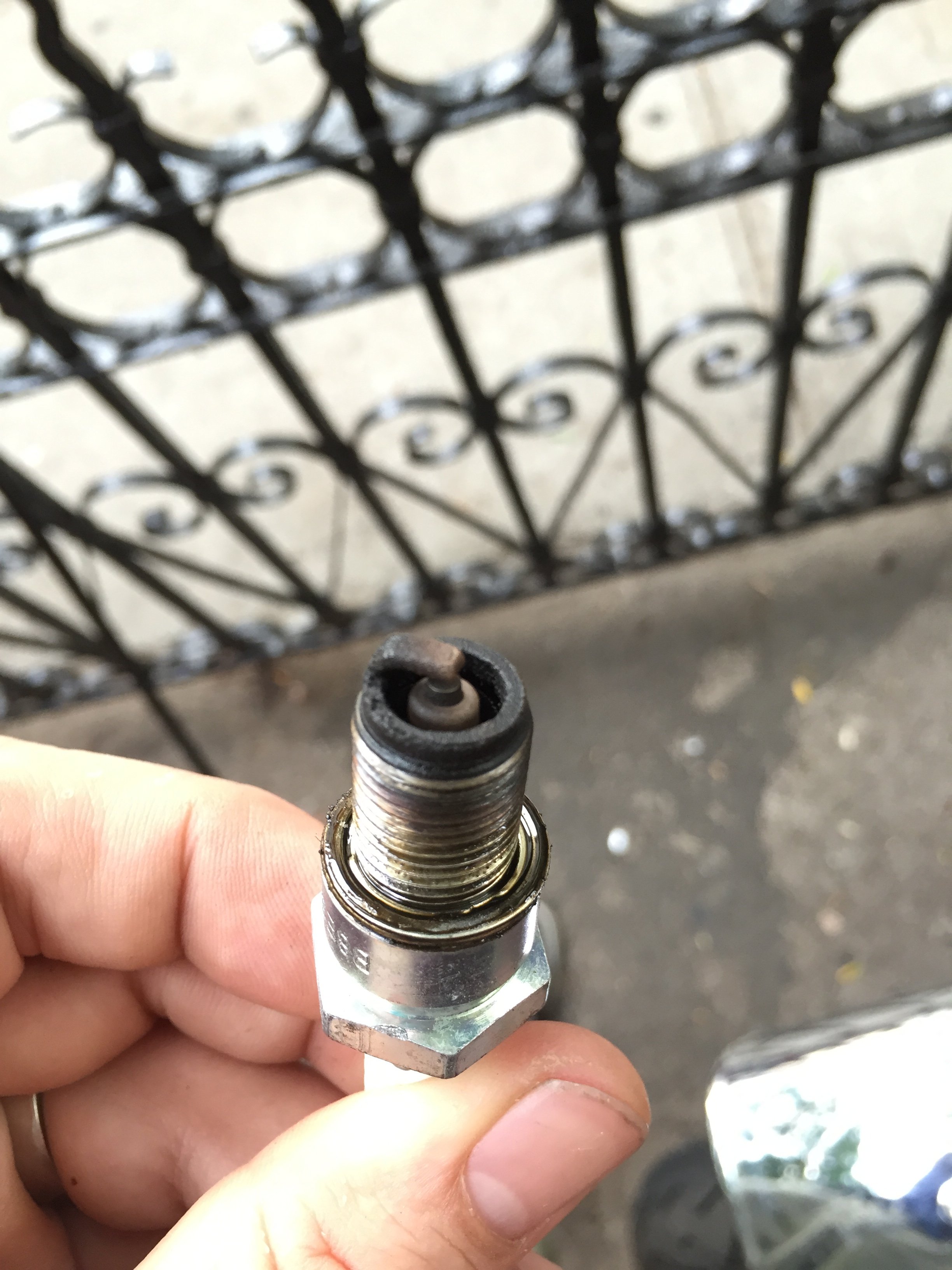

My 73CB350 just turned over 7k miles (1000 of which are mine). Overall runs pretty well, but it's still not perfect. Last weekend I had it out on a ride about 130 miles. No matter what I did, I couldn't get the bike to turn over 8k RPM in 5th gear, so I was topping out about 80MPH.
Additionally, when I really crank to WOT, sometimes I feel a little shudder. Motor is close to stock with shorty mufflers (stock airbox etc.) Carbs are rebuilt with stock 35/68/105 jets, slides were polished, etc. Compression is perfect, and while I have had some gremlins in the past it currently idles very well, and starts every time without any choke. Attached are some shots of the plugs.

those plugs look pretty decent except the top one looks like it has some moist goo around the threads . . if so, it is burning oil . . if it is dry, then it is too rich.
