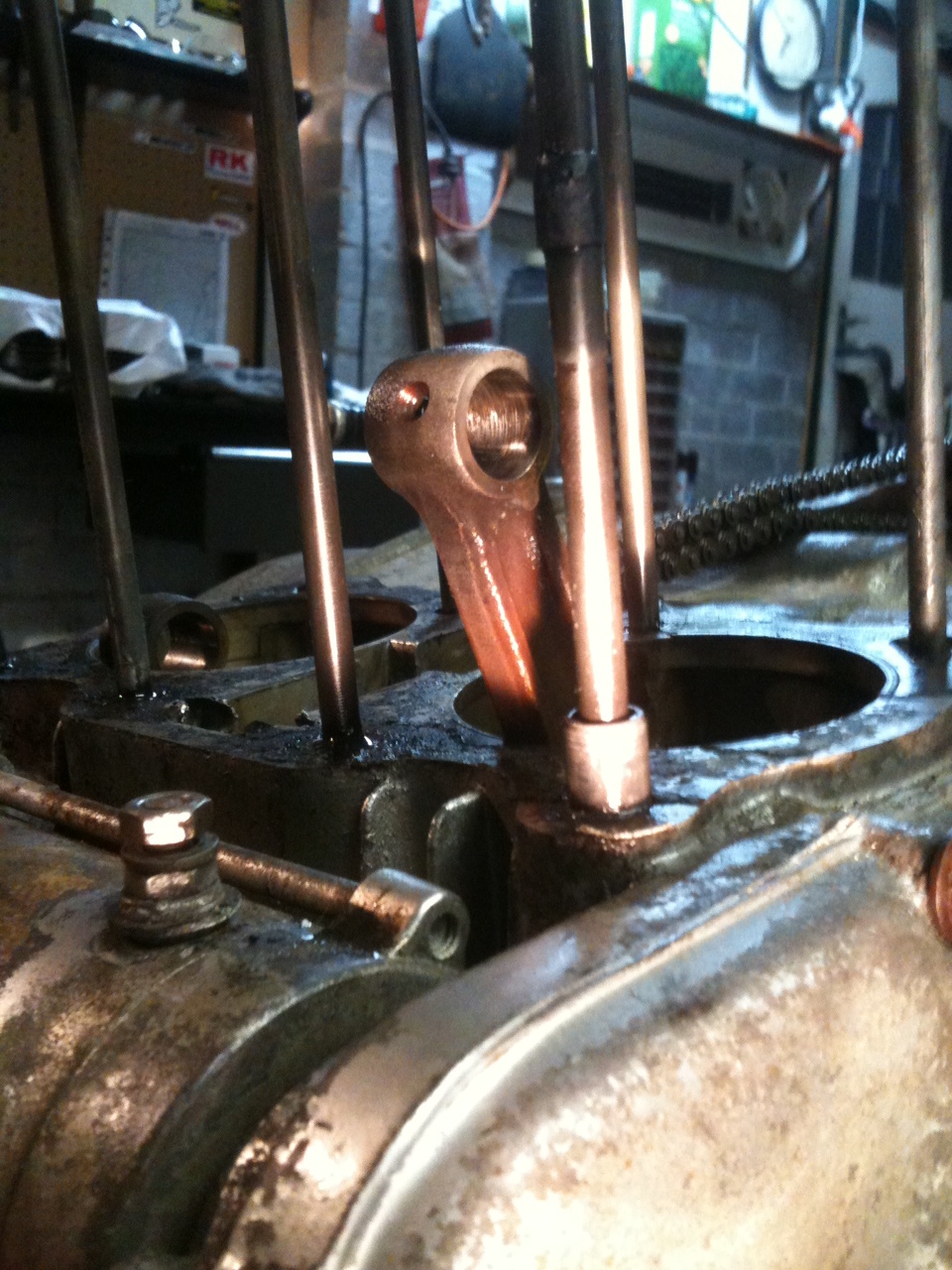

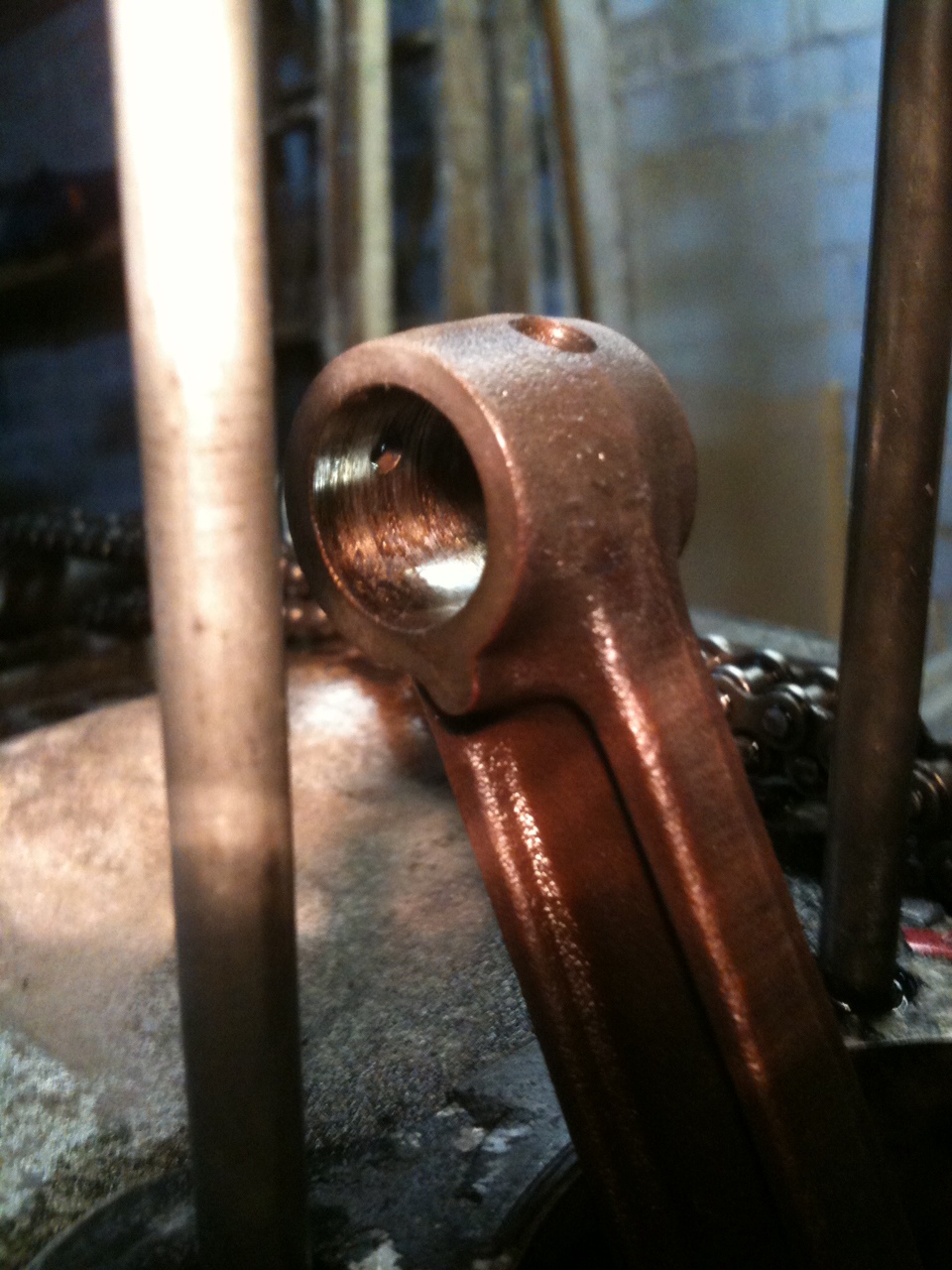

I have been getting into my first bike restoration project, and getting assistance from a friend along the way.
We have the CB350 engine apart to replace the broken up cam chain tensioning parts..
My friend called today to say that he was inspecting the pistons and conrods and he is concerned about the wear shown on the small ends where the wrist pins go through.
I think also he was surprised that there is no bearing used on that end (which I think he said his CB750 has in that position).
So, do the connecting rods need to be replaced, or can they be modified or upgraded with a bearing in the small end to repair or even improve reliability in the long run?
Thanks in advance for any light you can shed on this topic.
Re: cb350 winter maintenance (conrod pic's)
My conrod ends (pics attached)
My friend feels they look to have been starved of oil flow?
More likely wrong oil was used, probably 20/50 or straight 40wt?
majority will tell you they are trash (they really don't look good)
You'll need a new piston pin to check how much 'rattle' you have, unless you have equipment to measure inside the small end bore?
May be looking for a 'new' crank :(
Thanks PJ.
I don't know what oil was used in the bike before I got it recently, and I haven't run it.. I just got it to fix up and (hopefully!) ride soon.
So, easiest solution may be to get a complete replacement crank and just swap the whole lot over, with conrods and the rest?
Yep.
It's possible to re-build crank but a used one will probably be cheaper.
I wouldn't toss the old one though, never know if someone else has a worse problem and it could be used for parts
You need at least a 20 ton press to separate the parts and pieces (plus various fittings and adapters)
I've done hundreds (maybe thousands?) of pressed and bolt up cranks, would be a couple of hundred minimum to split, replace and re-true damaged parts, OK if your racing and fitting expensive rods, not so much for a basic build
Honda do not bush the small ends of those pressed up cranks and the only lubrication is oil mist. There are no oil jets AFAIK spraying oil up inside the piston which is a design that is used more now. Small ends are never well lubricated but they also don't rotate/oscillate much and are not revolving, so they don't need a lot of oil.
As PJ suggested, while they look "bad", what counts is play. If the pin is a good sliding fit in the rod, they are OK to use. I have had really oval small ends bored out and bushed, but that's a lot of work if it's not needed. I have also had rods bored to take 1mm longer piston pins in a CB160 frankenmotor with CB500 pistons.
More important that the small ends are teh big ends and main bearings. How much play and rock is there in the rod? And how smooth are the mains?
