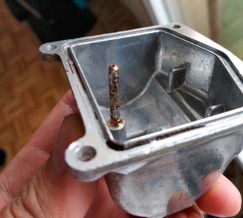

Anyway, I tried soldering the "worst" tube I have, it was cracked all the way, really all the way.
I used flux and my butane torch lighter, I was surprised with how "easy" it was on the middle and upper section of the tube, however, the crack a the bottom neat the bottom of the bowls still isn't fixed and I can't get solder to stick down there, plus it is difficult to reach with the torch & tin wire.
Probably just need more heat on the aluminum.
As the aluminum acts like a heat sink, drawing it out fast.
and Clean the residue out of that O-ring groove.
Yeah that is probably the problem, I've tried soldering another bowl, even with a ton of heat on the bottom of the tube I can't get solder to melt down there. Which is sad because all the tube is perfectly soldered and looks really nice.
I think I'll just JB weld the bottom of the tube and keep the solder on the tube itself.
Yeah I have cleaned the bowl itself since I removed the oring yet, I will.
