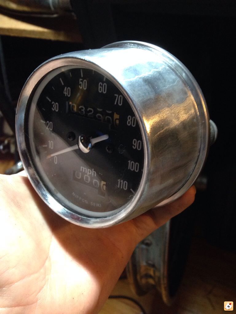

And all of a sudden there's no more paint :)
I'm thinking about leaving them bare and just putting a clear coat on...
Re: It came in a box... First build 1974 CB360t
Nice the bare metal looks great.

Pretty cool with the guages. Do you remember what model LED lights you got for that mod?
Personally I'd go with paint over bare metal, but I'm just not a fan of that "raw" look (unless it's aged well).
Yessir, http://www.amazon.com/gp/product/B007VLFBX2/ref=oh_details_o06_s00_i00?ie=UTF8&psc=1
