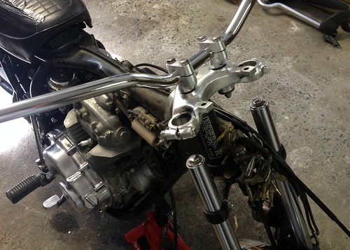

First things first, controls off, tank off, and lets get these goofy bars off the bike. Note the upper triple clamp and bar clamp color.

Sidecovers, polished. Next up ... the triple clamp. This is the stripped aluminum look with the new bars.
And finally all polished

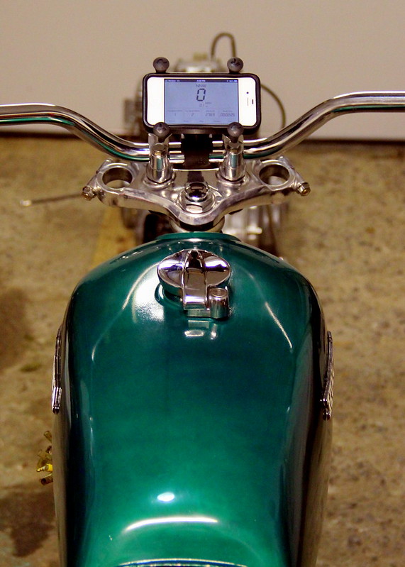

I wanted to change up the speedometer too. The 72 CB350's speedo bounces like crazy. Originally I was leaning towards the typical 2.5" small, black faced gauges you can find on DCC. Then I got to thinking a little more. I want to use my phone for GPS when I ride, I also sometimes like listening to music - I wonder if they have a speedometer app ... damn right they do!!

Shes looking great. Did you try the App while driving the VW to compare?

I wish I lived closer to the Midwest as it seems that's where the good riding is ... Unfortunately, I wont be making it out that way this October. The app is pretty accurate. I've had it on the VW, and the CB350. The only problem is it lags a couple seconds while the GPS works. So although you're going 60mph and let off the gas - the VW says 55, and the phone lags for a couple seconds before catching up and displaying 55. Realistically though, how many of us are glued to our speedometers every second?

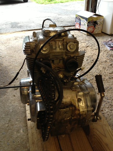

Engine is finally back in.
