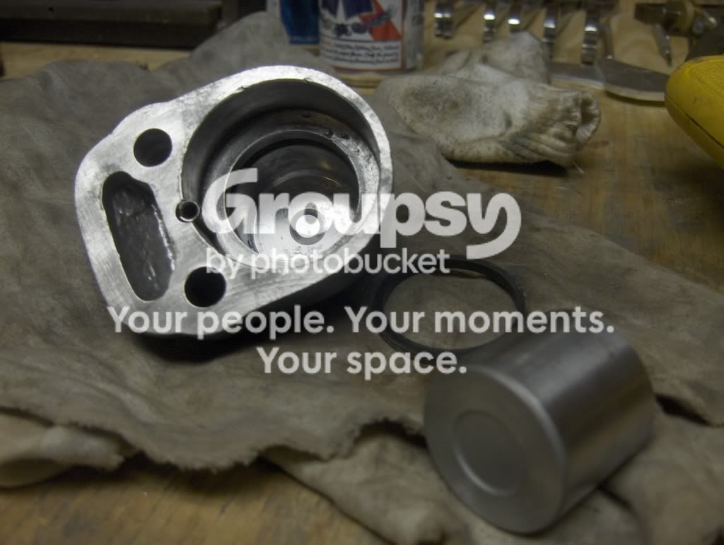

I got the grease fitting in the mail yesterday and was finally able to give it a shot. The grease fitting was not the correct thread, it was a 1.0 pitch as opposed to the correct 1.25 pitch. I wish I would have known that before, because the M10 x 1.0's are available just about anywhere, but I do appreciate the help from mitchellsk. So, using mitchellsk's advice, I just treaded it in until it began to cross thread, and went from there. I did boil the caliper for about 20min before I filled it with grease; and what do you know, it popped right out!
Ordinarilly I would not recommend intentionally cross threading anything, but if you're in this same situation, there aren't to many other alternatives. Like I said, just threading it in until it stopped threading was enough to do the trick.
All cleaned up.....
I cleaned the piston up with a brass wire wheel on the drill. You can see some pitting, but this was the worst of it. I think all in all it looks decent. At least not bad enough to spend $90 on a new one.
I ended up putting it all back together to test the whole system and it worked great. The o-ring was not in bad shape, but I will replace it for good measure next time I place an order.
Thanks for everyones advice.
