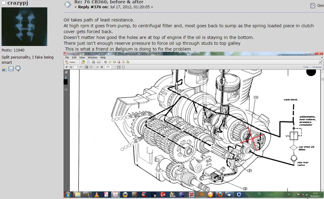

He started with some info of CrazyPJ
My buddy than altered the idea a little bit.
He disconnected to centrifugal filter, he rerouted the inlet to a oil filter and oil cooler, and connected the outlet of the cooler to the oil rail just behind the cilinder in the carter. Than he connected another piping to that rail, that feeds into the camshaft. He drilled a long channel in the camshaft, en drilled radial holes in the camshaft where needed. So in the end, the oil bypasses the centrifugal filter, goes trough a normal filter, gets cooled, and gets forced into the camshaft bearing and lobe contacts trhought the camshaft itself, ensuring lubrication at all times.
(The pics with the steel braided lines are not those of my friend, can't show any pcitures of his engine block because he is not finished yet)
