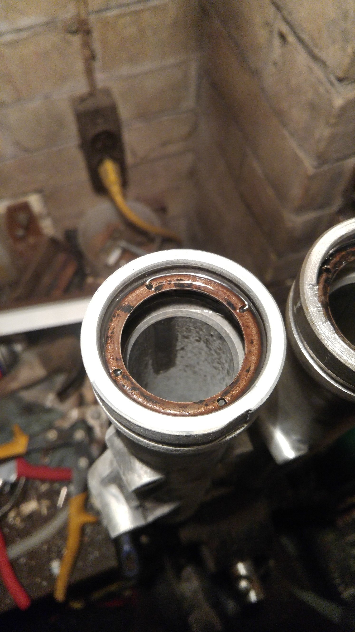

I've read about many other peoples struggles about getting out old fork seals, but mine seem to be a real bastard. I've got all the rubber out through picking at them and burning them, but these metal rings just will not budge... the can be removed right? I've tried prying, tried heating with a torch, tried freezing them first, etc. to no avail. Any suggestions?

judging by the marks on top of the fork tube in the pic, he has been prying on them. This can happen occasionally where a seal is glued to the tube. If you have the ability to place it in boiling water for a while, this will help to release the seal from the tube + the tube will expand slightly .........then pry them out while still hot, and place something on the tube for your pry to rest on and not indent the aluminum
The one in the picture I haven't touched. The other one, half out of frame, is what I was working on. I posted this after I gave up trying. I heated it, tried prying with a wrench and a welding glove under it. Hammered on it enough to leave marks on the fork upper, even tried using an air duster upside down to spray cold shit on it.... no luck. I've got them soaking in WD40 beside the woodstove now.
