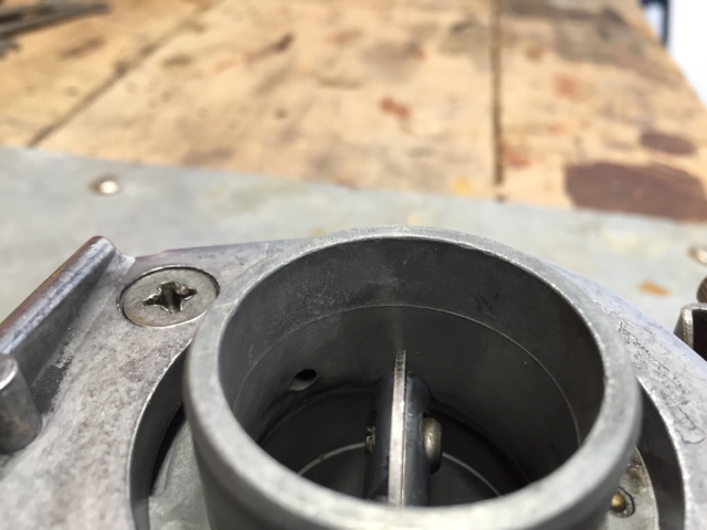

Do the butterflies close fully? You'll be amazed at how little they need to be open at idle.
Here are pics of the plates w/idle speed screw backed out all the way, left and right respectively.
I've always bench synced with a paperclip and then backed it the idle speed screw all the way out before starting. I've always had decent success with this method (until this bike).
Those are definitely not closed all the way. I'd pull the plates and double check that they're in correctly.

In the pics, the cables are not connected to carb?
Throttle plates can sometimes be a bit tricky to get just right. They should "look" like they have an air tight seal to the bore when fully closed. You can remove them and observe the available rotation of the shafts to be certain that the throttle plates themselves are in fact the component keeping the throttles from closing any further. Since you are having issues it is a good thing to check that the shafts can rotate farther than needed to be sure that there is in fact not some other issue. Assemble the throttle plates very loose and allow them to seat perfectly within the bores so they are as closed as possible before tightening the screws that clamp them in place. Might take a little fussing. Most throttle shafts are brass, and quite fragile and very easy to accidentally damage. The chrome plating will fool you into thinking they are stronger than they are, so a super careful examination is recommended. Looks like there has been a bit of harsh treatment handed out to the plates at some point judging by your pics, so a close look is important. The dents and scratches themselves are not a problem, but may indicate damage that is. They need to be dead flat or you will have difficulty. You can rub them lightly on a piece of glass and some very fine (#1000 grit or more) wet sandpaper to see any deformation. You will also see that the plates have a bevel cut into the edges that should fit very precisely in the bore when the throttle is completely closed. If this is damaged in any way, you will have trouble. It won't be light tight, but damn near. If it isn't there is trouble somewhere.
There is a stop screw to prevent shafts over rotating in 'open' position (and acting as a 'closed' throttle)
I know it is set to within a few thousandths of an inch of 'dead centre' when throttle is fully open. For fully closed position, the linkage has 'over travel' capabilities.
It is a PITA to dismantle everything in linkage but the plate is the only thing stopping shaft rotating.
The only real alternative check is to find a new/undamaged throttle plate and swap it out for the damaged/straightened one. I checked the edges as best I could, they were damaged so I think I radiused them which gives impression plates are further open than they really are (wasn't possible to re-machine the angle on plate - it would become too small for opening at an approx 27 deg angle)
If you remove the plate again, you will have to carefully file down the screw thread as it has been compressed to prevent backing out. You then need to source new screws and remember to crush the ends.
I modified a set of lineman's pliers to get inside carb bore you can see 'teeth marks' on screw heads, (another PITA grinding project) I guess I didn't remove second throttle plate as there are no obvious marks on screw heads

You don't need to remove throttle plates to check angle on the edge, just open throttle and take a look. I know the repaired one has pretty rounded off edges from being fitted 'backwards' then pried open or something which bent it 'Z' shaped.
I flatted it out, polished it a bit to remove worst of gouges then fitted it correct way around.

Upon close inspection of the plates, I see a very slight angle on the edges of each plate. The angle is sloping in towards the interior of the carburetor (the slightly larger radius is facing engine side, slightly smaller radius facing into the carburetor. The repaired plate has slightly less thickness than the untouched one, but the bevel is facing the same direction
