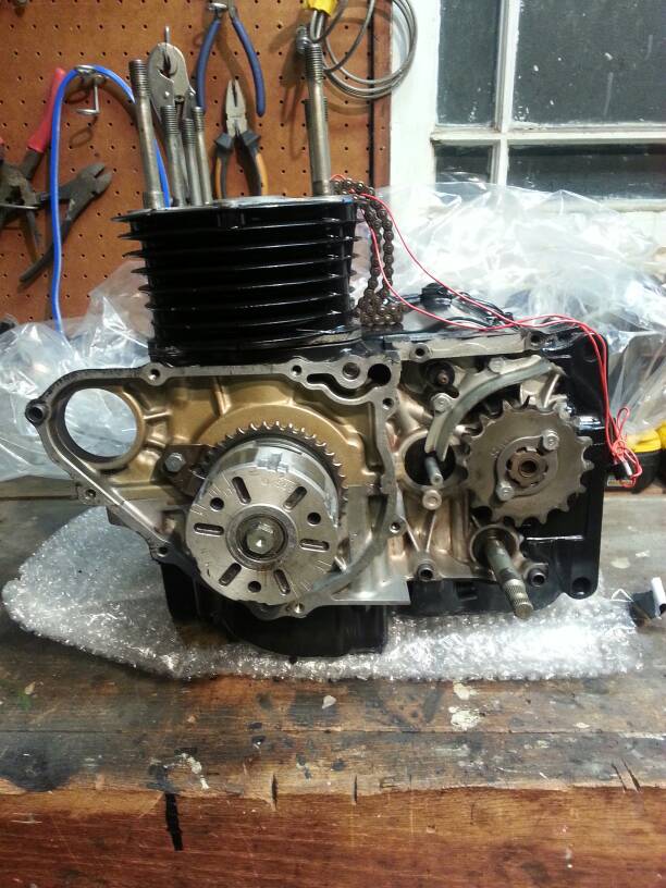

After the holidays and I'm really itching to ride. Back to work on assembling the motor. New piston rings and gaskets. Starting to look like a motor again after sitting in pieces for months. I really hope this thing works...
I should have checked this gasket set I purchased a long time ago...it had the valve stem seals that I needed and ordered several weeks ago.
This weekend I'd like to finish the motor as much as I can and paint the frame and swingarm.

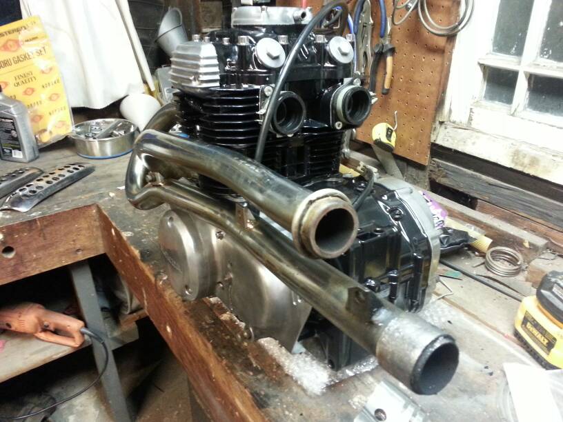

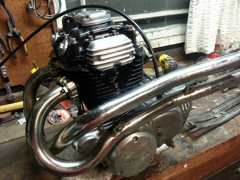

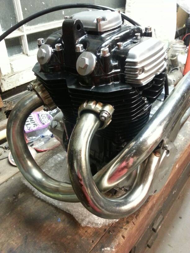

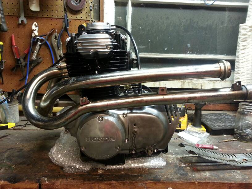

Finished the motor assembly today. Need to work on ignition next. I think I'm going to go 2 into 1 headers out to a 12 inch Shorty muffler.
I need to reinforce my seat hoop next. Paint the frame and swingarm. Black out the wheels and get some new rubber. Need to start thinking about wiring shortly there after.

oh my gosh dude, i TOTALLY forgot to get you a pic of my 2-1 coupler! seeing this sparked my memory. i'm sorry, i'll get that to you asap!.
I've enjoyed following your thread. You are doing some interesting things. The placement of the monoshock proves you are a braver soul than I, but I like the creativity!
I'm a huge fan of the length of your seat. I love when the frame is balanced over the rear tire. It really gives the bike an aggressive look.

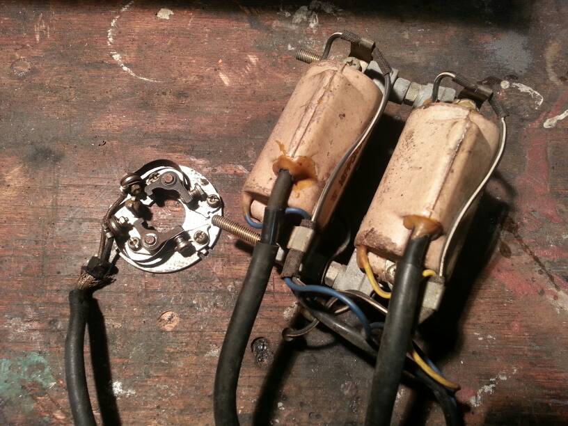

Started digging through the electronics box tonight. I recovered the regulator, rectifier, indicator lights, right hand switches, top half of the kill switch, flasher, some octopus looking thing, rear brake light switch, points, coils, condenser, and a whole mess of wire harness.
Now I need to figure out whats worth keeping and what I should just go ahead and replace.

Octopus thing is the solenoid for the starter. A smaller switch inside the solenoid triggers a bigger switch so you don't have big current pumping through your wiring harness when you fire the starter motor.
Thanks Neevo.
