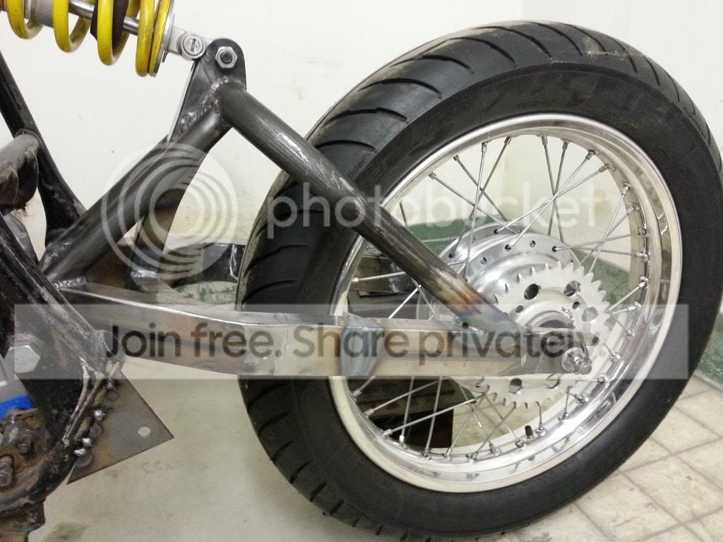

First order of business is to add 3" to the swingarm...which pretty much means, make a new one. After staring at her way too much, she is too squatty.

Happy to read that you will be lengthening the swingarm! I was looking at it saying , man that needs a 3-4" SA stretch! :P

Welp, I have ever so slowly been making process. My wife has become tired of here me complaining about not having a bike to ride so she has instated "Motorcycle Monday's" where I am forced to work on Penny after work....some motivation is coming back, but it's not like it was 3 years ago!
The rear shock is now much softer with the extra leverage, which is great!
Here is the swingarm with another 3" on it.
Removing the old coped round tubes (fun!):
I added a 3" box section to the arms, and made new little ends for the round tubes. Welded it all back together, and this is the result:
I think it looks better, not nearly as squashed:
