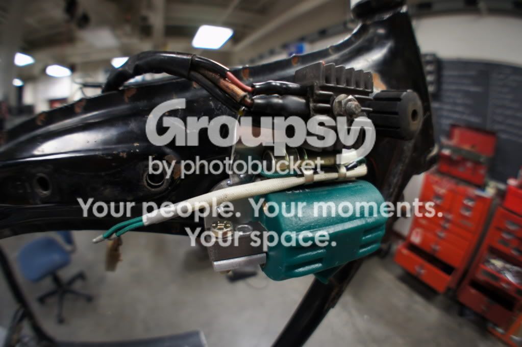

I made some pretty good progress yesterday. Fabbed up some mounts for all of the electronics and started on the gas tank.

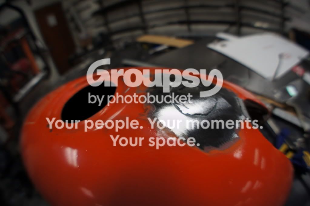

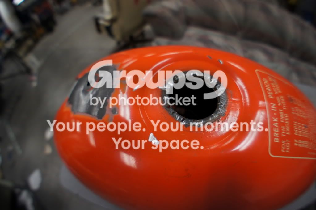

Cut out the old gas cap
Opened the hole so the new gas cap fits in
Welded the old mounting hole closed
Ground it clean. It still will need some bondo, I went back and forth a few times welding and grinding and I couldn't get it to where I liked it, so I will smooth it all out with bondo.
Welded in the gas cap, my TIG-ing still needs some help, but it is water tight on the first pass. I had cut an "O" out of sheet metal and was going to fit it over the tank and make everything flush but that I am pretty happy with how this came out. I will need to clean everything up more and probably use some bondo to shape it to where I want it.
I tried welding it from the inside the first time, but there wasn't enough room to maneuver the torch around.

Wooooooooooo! Hard at work man. Love it.
What fish eye are you using to shoot?

Thanks! I am using a Sony NEX-5 with the 14mm pancake lens and Sony's Fish eye that screws in to that lens, its a reaaaal nice set up and super easy to use!
Here is a blog with a little info on it: http://sonyalphanex.blogspot.com/2010/10/sony-nex-vclecf1-fisheye-conversion-and.html

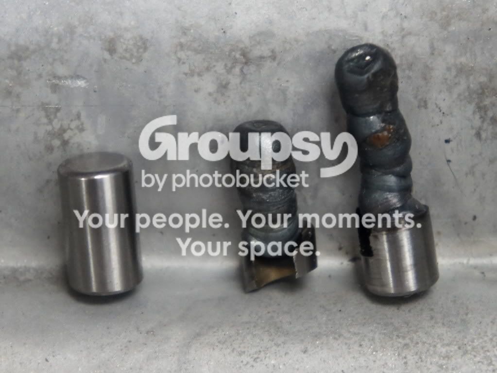

I GOT THE ENGINE HALF BACK! The first machine shop held on to it for a week and half then told me they weren't going to touch it >:( they then referred me to a guy a few block away who was able to get that stupid pin out in a day! He did what I was about to do, but wasn't sure if it was safe, he welded a blob of weld to the pin and then used vice grips to pull it out.
The pin actually sheared in half the first time so he had to weld deeeep in the hole an even longer blob and was finally able to get it out... $20, two weeks, plenty of frustration, but its out and I can now re-assemble the engine! I still don't understand why this one was sooo stuck though, the new one slides right in and out ???

Here you can see the sheared pin:
New pin, top of pin with weld blob 1, bottom of pin with LOOONG weld blob

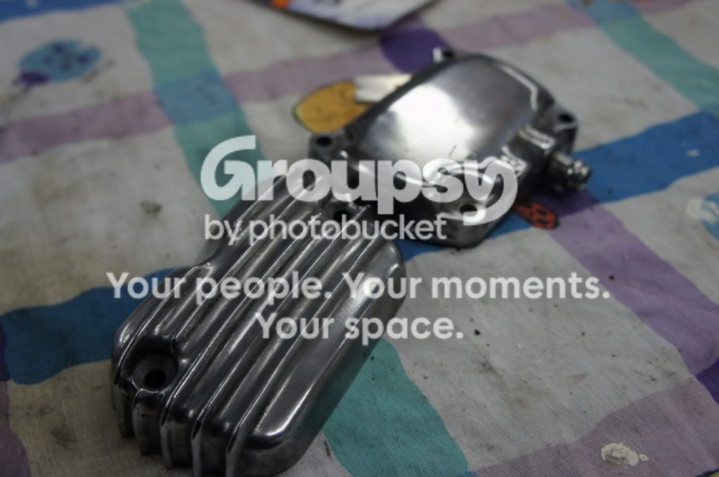

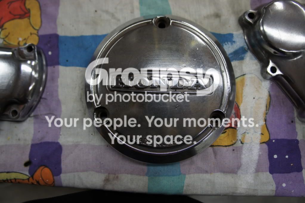

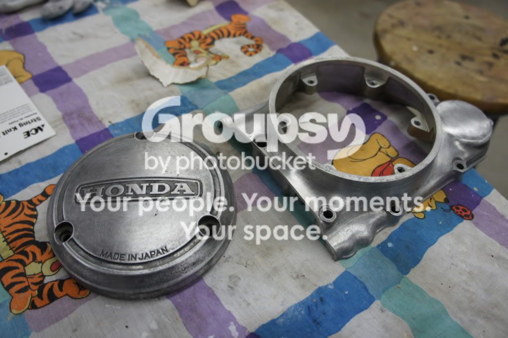

Started on polishing. After making it through the 3 recommended wheels/compounds, I realized that I did not do near enough surface prep. There are still a bunch of scratches all over these things and the shine isn't what I was hoping for...sooooo I will have to go out and get the proper grit sand paper and re-do most of them, if not all of them.
Before
Points cover Stage 1, Breather cover stage 2:
Stage 3:
Tried to capture the scratches:
The mess behind the grinder
I wore a towel around my mouth...didn't wet it and now I am regretting that. I had chemical tasting burps for a few days after and my snot was black...definitely going to get a proper mask next time around!

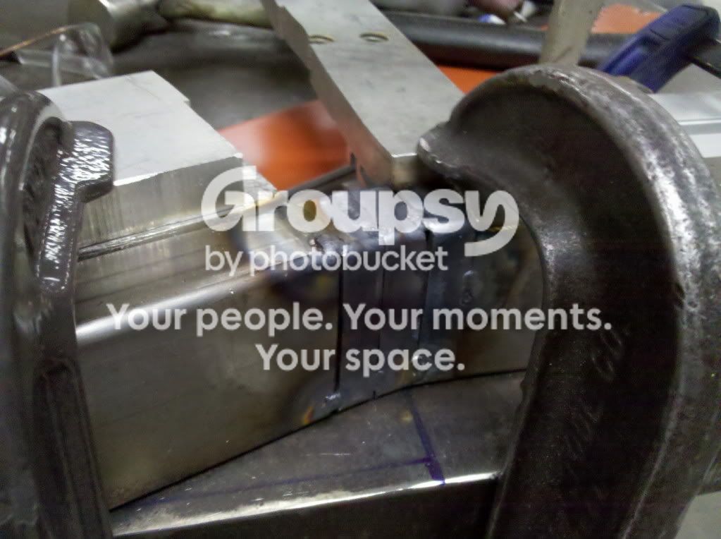

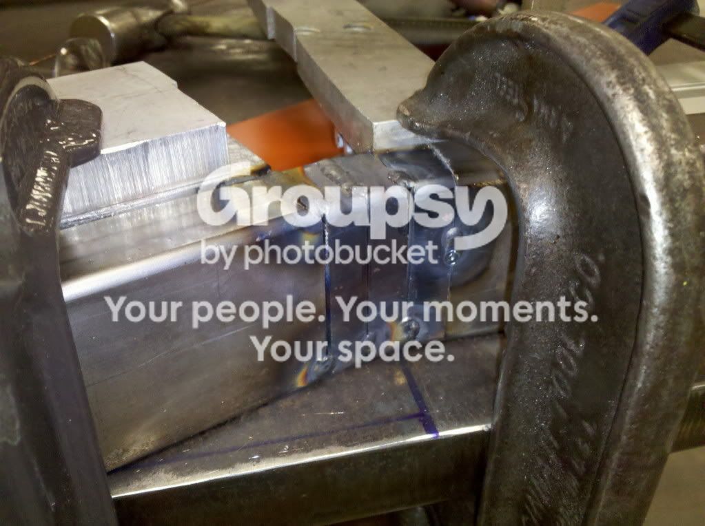

A bit of a baby update...I started work on the swingarm. Its using 2 " x 1" x .0625". These will bill the main legs that get welded to the old pivot. I just need to bend up a hoop and make a few support bars. I am snowboarding for the next week, so it will have to wait :)
You can never have too many clamps! These were intended to be a 19* bend, but after welding came out closer to 20.5* which is a pretty decent tolerance in my books.
Cut some slits and bend, then re-weld. Some welds definitely better than others...
Squezzed in a vice in an attempt to relax the weld a little closer to 19*...didn't do anything...I guess that means it stiff!
Welp, I hope you guys enjoy the baby update for now! Thanks for looking
Cool I like the baby update. I like the idea for the swingarm. I would recommend running another pass over those welds. They look good but you did have some pretty big gaps. Just what I would do. Keep it up love this bike.
Thanks, I'm glad you like it! That's is a good idea. This was just a first pass. I'm going to grind it down smooth because the welds look like poop. Then I'll probably have to add some more weld in the sinks. I'm not worried about strength, those legs won't be as highly stressed as the round tubes that support the shock. I had full penetration on the welds so you can't ask for much more. Pilling weld on top won't add any strength, only extra material. Unlike aluminum, a properly welded joint in steel is stronger than the steel itself. Thanks for the idea!
