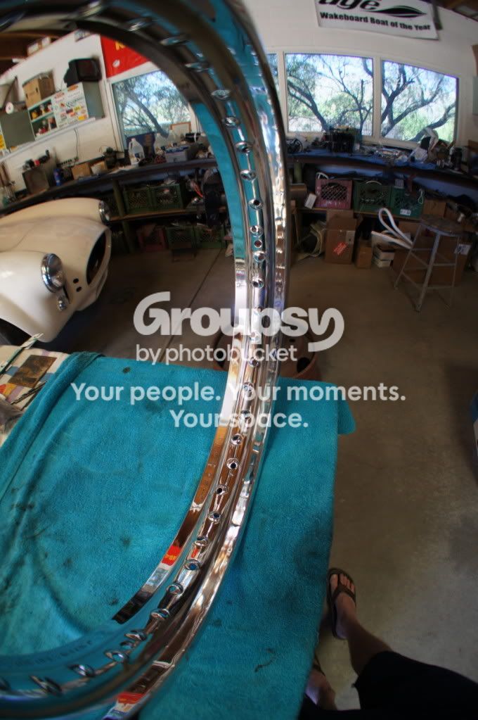

I polished the shiniest thing I've ever made. After about 10 hours of sanding, this is the result:
Aluminum rim on the left (satin like finish)
After

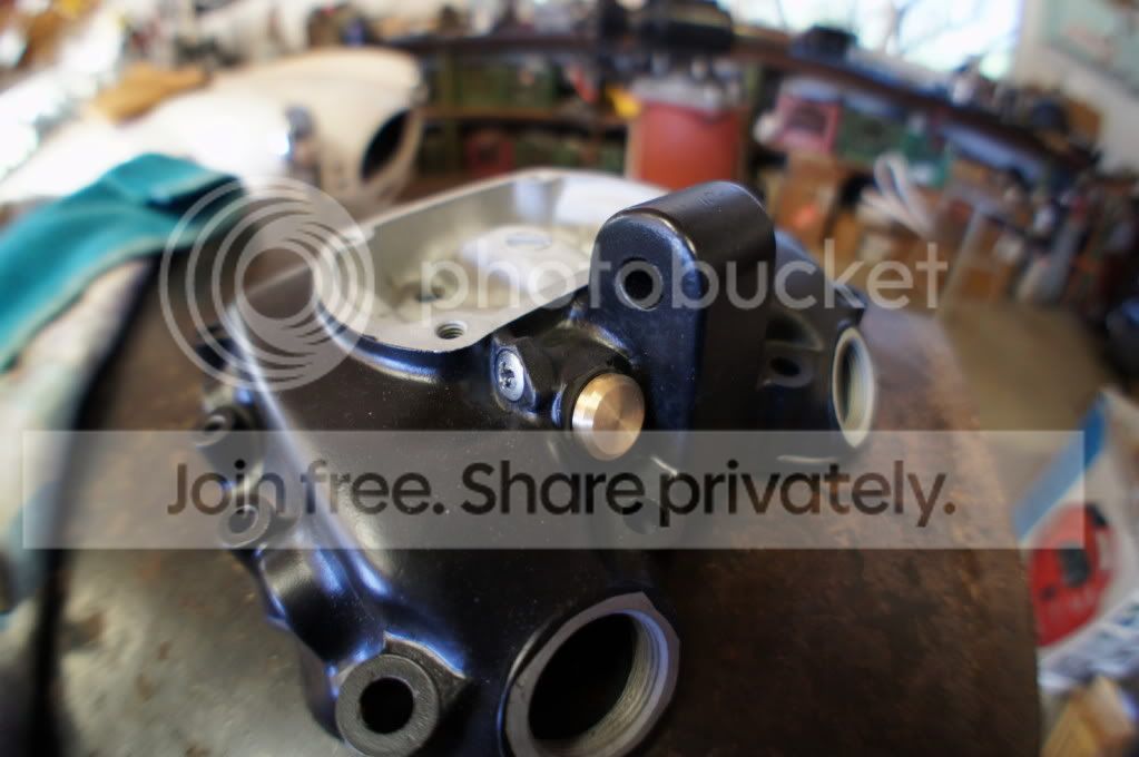

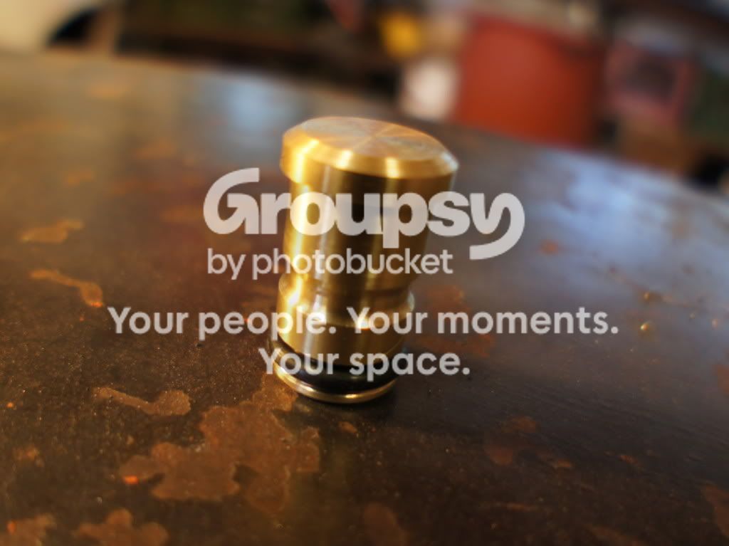

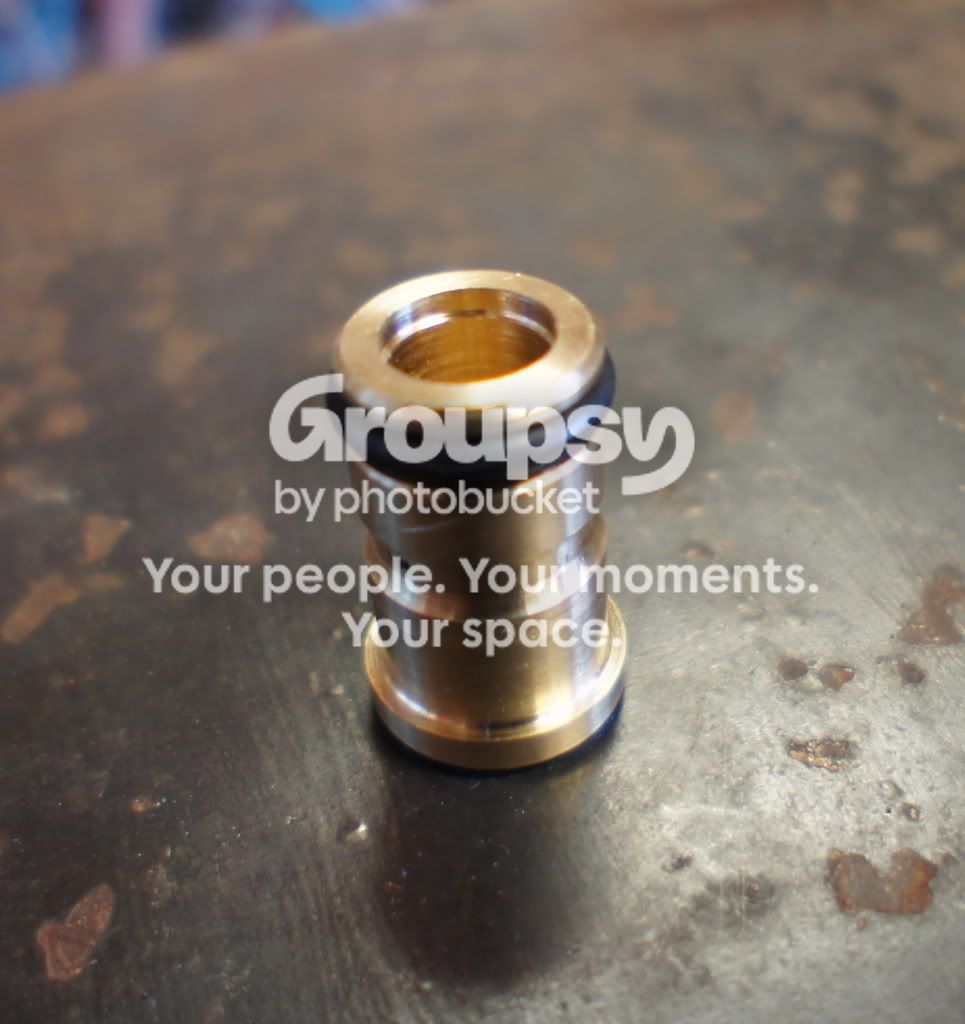

I made a small tachometer block of plug that fits with the internals still inside:

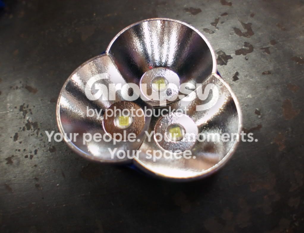

And I started working on the updated headlight. I am going to cut the sealed beam open and these will replace the old halogen bulb. Each of these are capable of putting out 900 lumens at only 2.8 Amps...but I won't be driving them that high as it will create a lot of heat! There will be a disc like piece that these will drop in to and those will fit in to the back of the sealed beam bulb. I milled down the sides of the reflectors so that they could "nest" together:

You want to sell those tach block off plugs? I'm trying to figure out what to do with mine and if they aren't hard to make I would buy one from you.

Those rims turned out perfect! Looks like lots of work shining back at you!
You are the second person to ask for one of these...I'll start a new thread and get an order sheet going. I would like to get atleast $30 (shipping included) for each of them, in your choice of brass or aluminum.

Ringo - Thanks man! That was only the rear rim, the front was newly chromed when I got it, so I had to make this one match, and it does!
