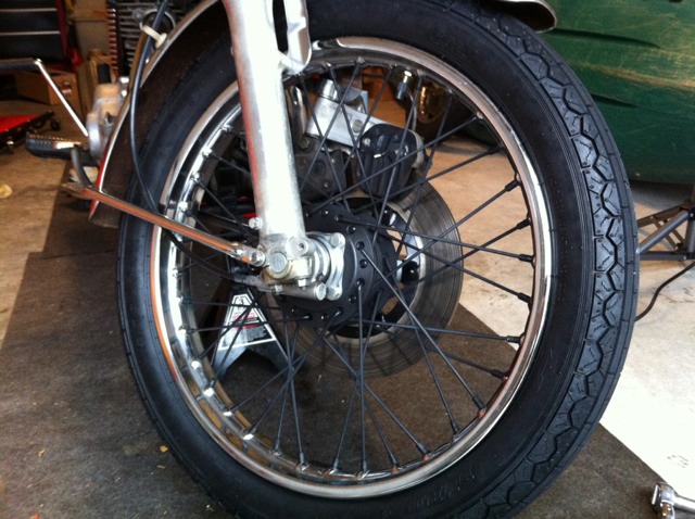

The spokes were pretty rusty so I cleaned them up a bit with some sandpaper and paint.

The front brakes were dragging so I rebuilt them. Holy corrosion, batman.

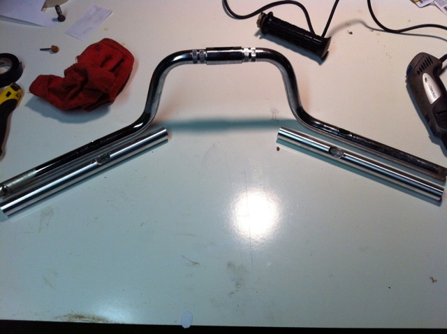

Just scored a set of woodcraft clipons so over the past couple days I was able to put them on. After some thoughts of minimizing the handlebar controls, I came to the decision of keeping the stock controls so I had to make templates of the wire openings on the 360 bars and transfer that to the woodcraft bars. I was hesitant to cut them up but it turned out pretty nice considering I only have a drill and a deemed to work with. Now that the bars are on, I have an issue I overlooked. All my cables are now too long and I need to either shorten them or get new ones. I've never worked with custom cables so I'm looking for any recommendations on what I should do. I'm sure everyone else with lower bars runs into the same problem so there's gotta be a relatively straight-forward solution? Also, don't pay attention to the elephant-sized turn signals, they're on the list. Haven't decided if I want to replace them or just cut down the bars to bring em in tighter though. If I replace them, I want to make sure I pass inspection so the new ones will have to be bright. If anyone has any suggestions for decent turn signals I'm all ears.

After measuring for new cables to work with the clipons, I came up with 3.25" shorter than stock for the throttle cables and 8" shorter for the clutch. Does that sound right? It seems like they would all be around the same amount of change but I'm not sure so I want to check with you guys. The clutch measurement is the one that scares me. But I measured everything twice and moved the bars left and right to accommodate for movement. Thoughts?

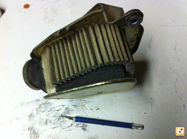

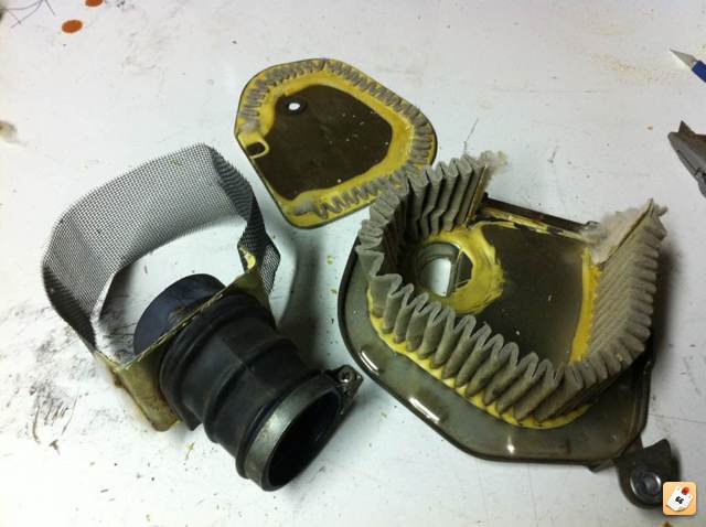

Working on the bike again since winter is here. Decided to rebuild the air filters since replacements cost $50 each from hondacb360.com and the cv carbs dont like pods. Was able to rebuild them for about $3 in parts. Here are some photos of the process i took.
Cut out the existing filter element:
Pull apart the filter body:
Scrape out the remaining gunk. A liberal heat gun is your best friend:
Get the leftover gunk out. I used a wire wheel on a bench grinder:
Use some silicone to put the plates, mesh, and boot back together:
Clamp and let dry overnight:
Cut some cotton padding in a strip to use as a filter element. I got this stuff from a local craft store. Think its used inside blankets or something. Also, no need to glue the ends down. The filter housing holds it down nice.
Thats it. All done. Now when i need to replace my filter i can just cut another strip of the cotton material i got and swap it out. Easy. Also, no need to glue the filter element down. the housing holds the ends down nice and snug once its on.
