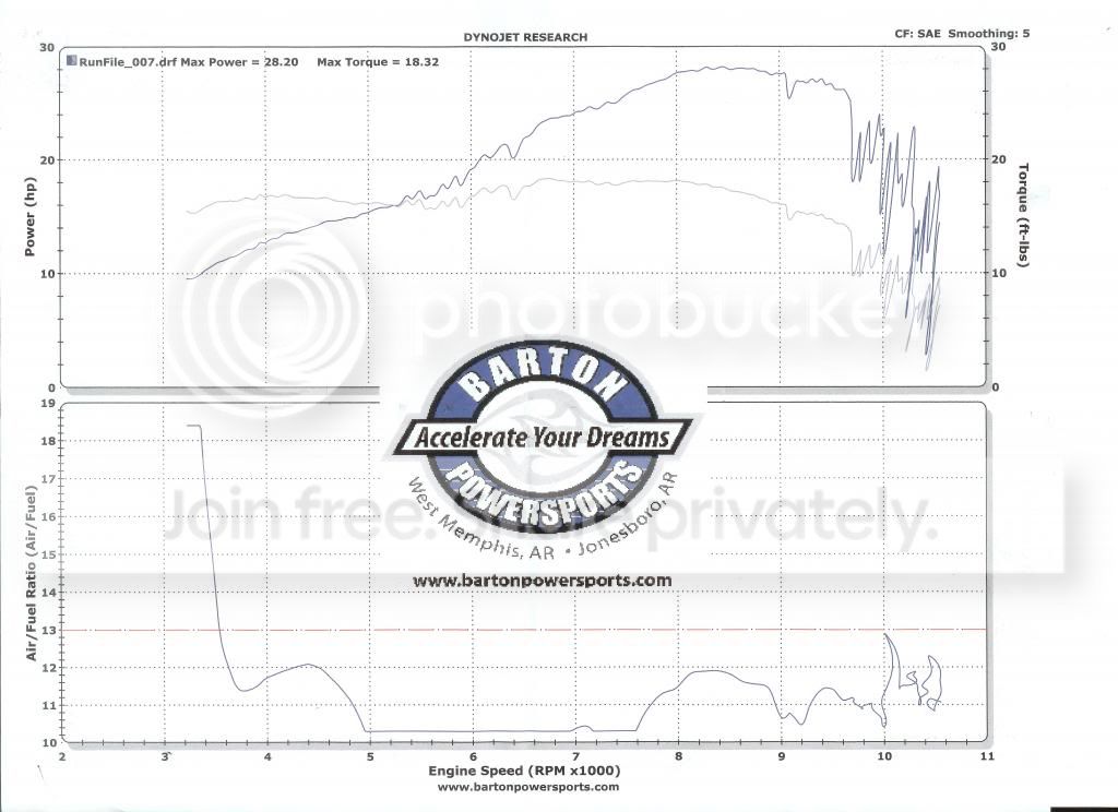

Before you get too excited, the engine is stock and worn out. I've got some K&N filters and pipes. Most of my performance came from removing everything that didn't make it go or stop or pass inspection. My estimate when they pulled it in was 25 horse power and 15 ft torque.
I was surprised on a couple levels. My power estimate was conservative. HP was 28.2 and TQ was 18.3. The most surprising thing is that I'm run super rich. That's surprising cause the way the bike was acting I thought I was lean. Another surprise was that my points are floating about 1500 RPM earlier than they should. Not sure about what to do about the points at this time. future plans are to go electronic.
