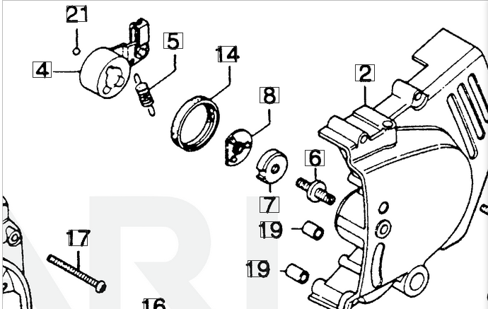

Did you have the single ball bearing installed? They go missing pretty easily.
Item # 21...

You're buddy will need to turn the adjuster ( #6 in the pic above) on the left cover. Its been years, so I can't recall if it needs to turn "in or out" BUT im thinking it seems backwards...so turning it "Left" for more throw??? But the Honda manual explains it all pretty clearly. It all has to be pretty precise, because the amount of spin can also interfere w the 3 ball bearings "thing". Snapping past the "Locking ring". and into the next 3 divots. Which defeats the purpose.

So, use the adjuster #6 to adjust rod "pick". So it doesn't let it "Slip" when clutch is compressed as lever is released. Then if it "snaps" because its got too much throw. Use the cable adjustor to add a bit of slack so that it doesn't pick far enough to let it "Snap". Ensure there is a couple mm of free play in the lever when its released.

Another little point if I may, adjust the cable first so that it is fully slack and then adjust the motor side and then go back and take out excess cable free play. It is almost impossible to adjust the motor side (#6) if there's not enough free play in the cable when you adjust that throwout.
Absolutely. Its been too many years for me. Without actually sitting down w manual and bike and doing it. Thanks my man.
You 'unscrew' the adjuster in chain cover to bring it closer to clutch push-rod then adjust cable.
Part #127 (or #7) moves away from cover moving the entire operating mechanism.
on 360, you can do the cable adjustment before fitting cover to bike . There is a cast 'pointer' inside cover that lines up with the cable operating arm when cable is properly adjusted. You then just unscrew bolt #6 until it contacts clutch push rod.
