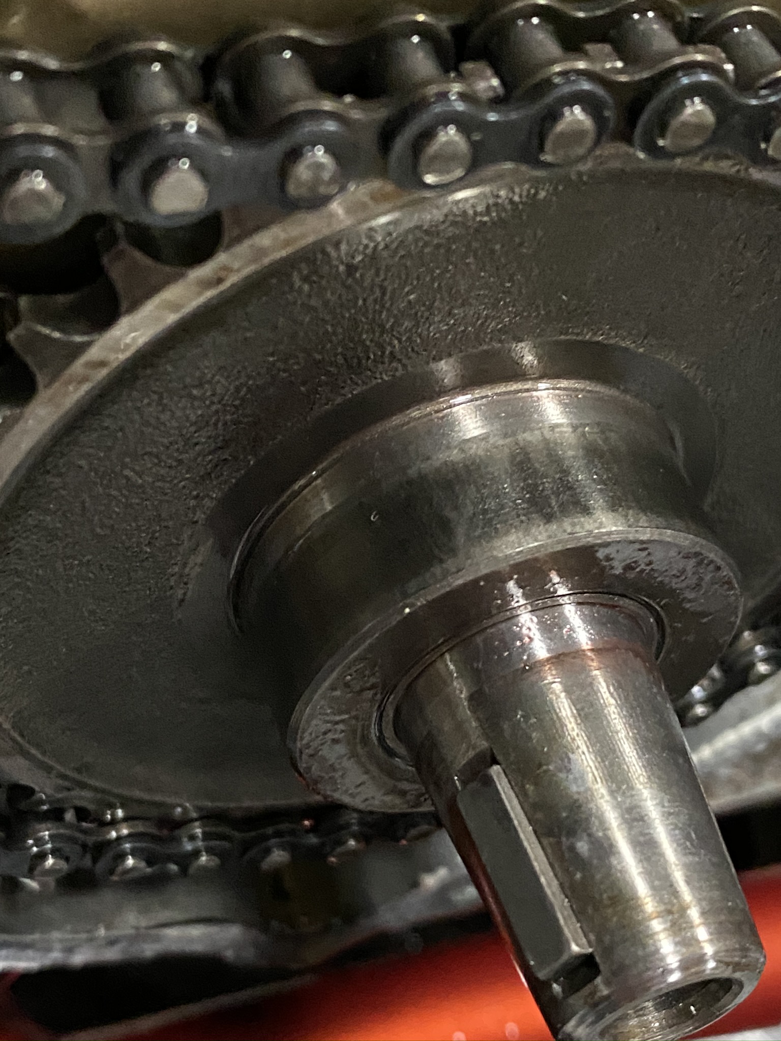

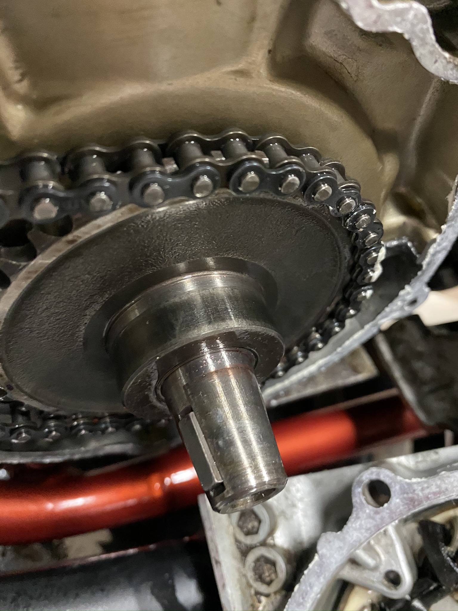

I tried the starter with the case open. see attached video and photos.

Maybe it got turned around backwards in my head, but the clutch looks to be set up to operate in the opposite direction from the direction that your starter motor is spinning the chain.
That isn't even trying to 'grab'
The only way to reverse it is if you completely dismantled it, removing the steel shield which is kinda difficult as it should be 'rolled over' at the edge.
It's more likely the roller ramps are either worn or cracked, you'll have to pull rollers to check.
Only need one crack to prevent the rollers locking on the 'drum' section of the sprocket, usually you can feel a 'bump' on the outer rim.
It's easy to test on the bench, should turn one direction but not the other, if it spins both ways you need new rollers or new housing (should be dozens around as so many people have removed starter clutches)
