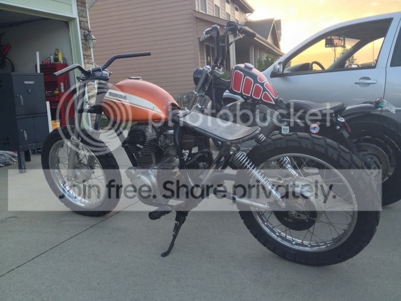

Well... its been awhile. Ive been screwing and around with the Harley all year and now that is cold again Im back to the grind on the Honda.
I just fixed the rear hoop and got the swingarm welded up. Next on the list is to get it rolling and redo the shock mounts. The person who did the mounts put one on crooked as shit so im just going to chop them and do it myself. Also putting new mounts on the swingarm so the shocks are at a normal angle.

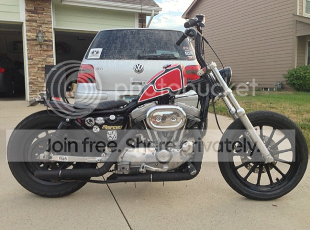

And one of my main squeeze. A lot has changed sense the last photo.

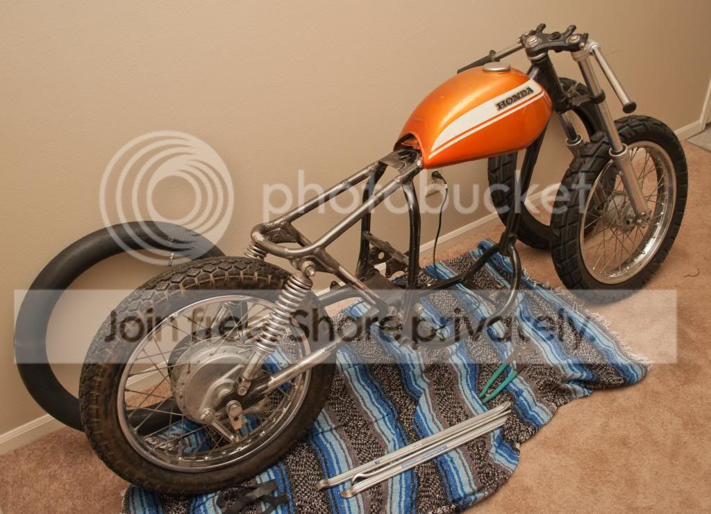

Well, Ive been dragging my feet because Im terribly unhappy with the shock mounts on this thing and I dont have a my own welder to fix them. Ive decided Im just going to suck it up and fix them when the bike actually runs. So... assembly begins.
Should have been on its wheels today but I spaced off and forgot a washer for the neck bearings then ruined it trying to take it off. New bearing is in the mail so it will be rolling early next week I hope.

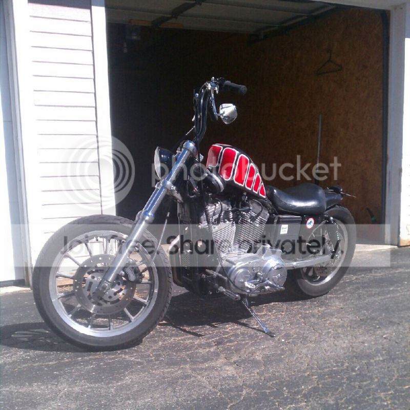

And my almost done sportster to keep things interesting in here.

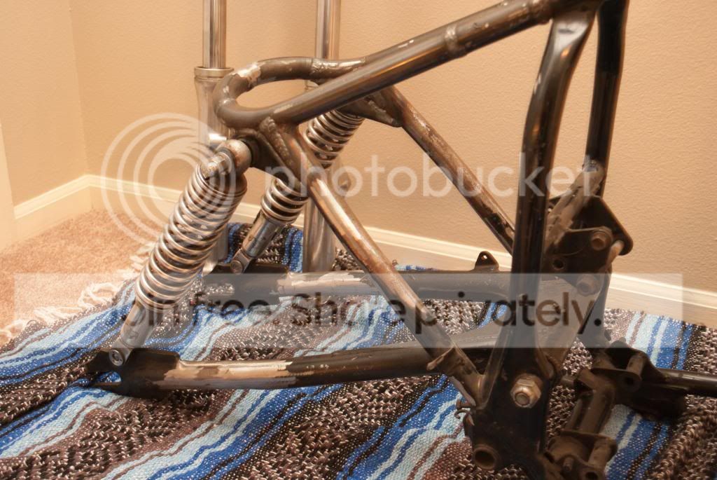

Question... Do yall think I can get away with cutting out the area circled in red? The yellow would be a cross brace but it would be hidden by the seat. I think it would be cool to just have a hole there.
What is that, 2.5 or 3 inches clearance between tire and rear loop, with no engine or rider weight on the back end?
You aren't worried about that?
mlinder said:
What is that, 2.5 or 4 inches clearance between tire and rear loop, with no engine or rider weight on the back end?
Not worried. Ive tried to make the tire hit and haven't been able to do it. Worst case scenario I raise it a tad when I redo the shock mounts.
OK. I think you might find that once the bike is weighted with an engine, you are on it, and you do anything like go over a bump, you will need a fair bit more than you currently have.
Just pointing out a future possible issue. A 16" rear might alleviate a lot of that.

well... turns out that tire hits like a son of a bitch. Not the end of the world Im just going to have to move the shock mounts earlier than anticipated. The shocks themselves are pure mush, feel like Im sitting on a pillow. Anyone know of a super stiff shock? something like the burly slammer shocks I run on the sportster would be sweet because they are rock solid.
