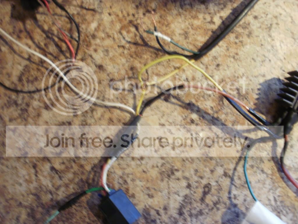

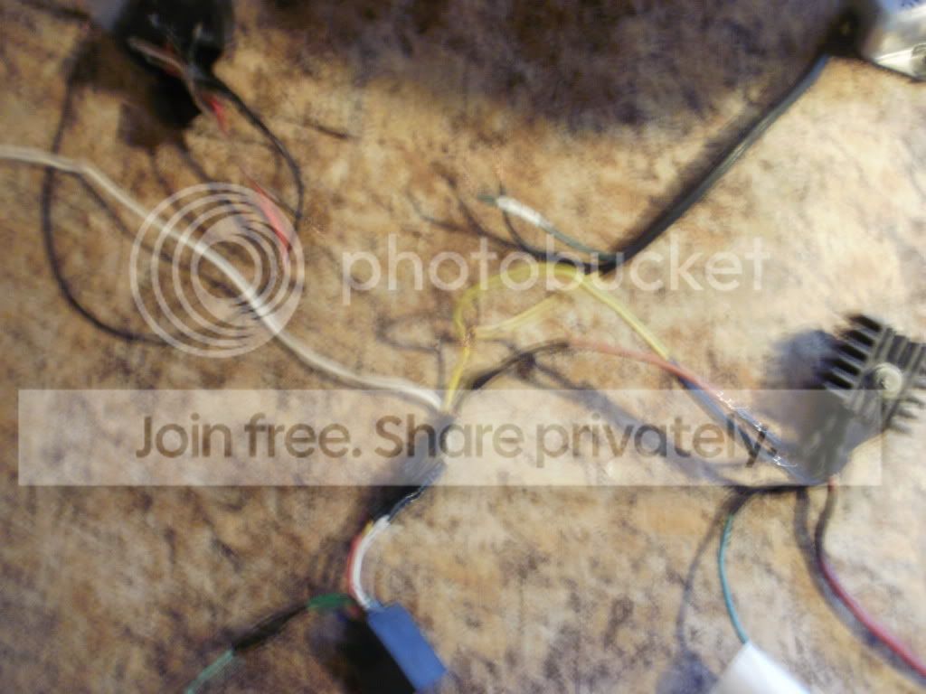

so heres the picture. the White box in the right side is what im using as a battery. Sothe red off the rectifier goes into battery. so how do i wire the key switch into this? Then ive got the yellows in the right side. The stator plug is at the bottom(its a 6 pin trailor hitch harness where im only using what i need) . So i would splice the white off the stator into the yellow on the stator before the yellow gets to rectifier and regulator, right?

You don't. The rectifier runs to the battery all of the time (no switch). The switch comes from the battery to the rest of the wiring.

You'll want to run at least one fuse (5A should be OK) right before your ignition switch, too.
The white is actually 1/3 of a charging circuit. The yellow is the other 2/3 and the pink is a full circuit. So your stator has two full charging circuits, one of which is divided.
In stock form, the white (1/3 circuit) only gets used when the high beams are on. It's a common modification to splice the white and yellow together, effectively giving you two pinks...
Hope that made sense...
-Matt
