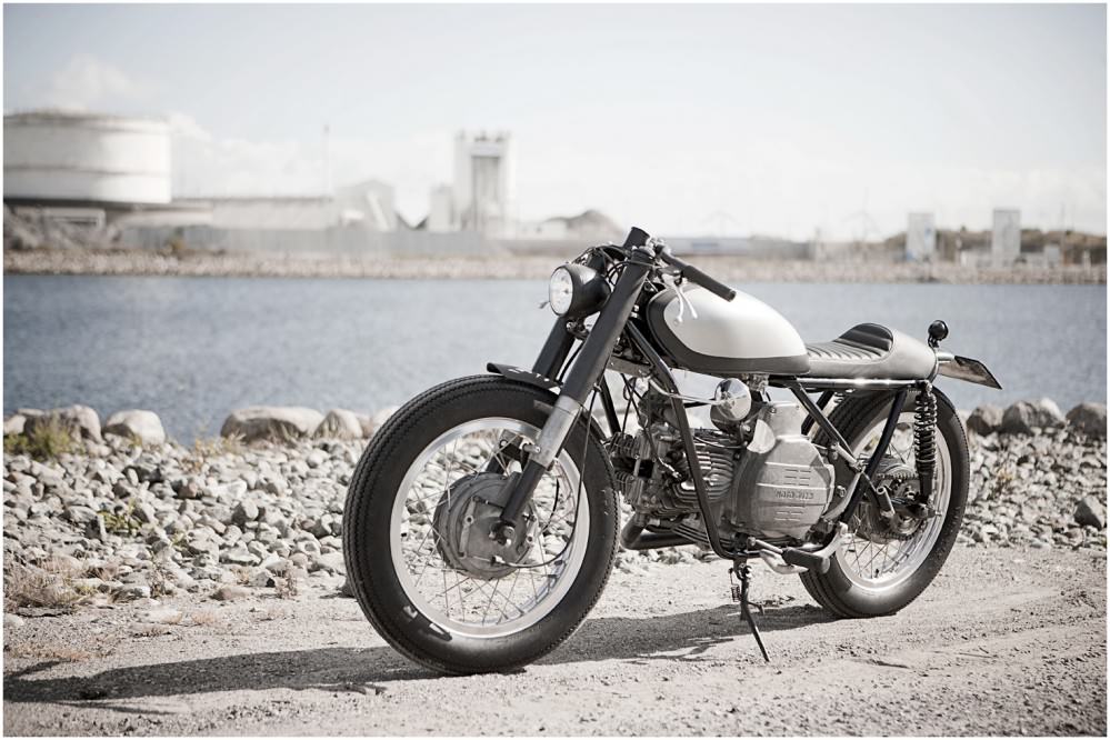

I'm thinking about going a bit towards brat style and getting a two-up seat pan for my bike, but before that would be done I'd have to clean up the wiring and make sure everything's decent there. Maybe a seat like this one?
Something that's not completely flat, but still able to have two people on it. I also want to keep the electric starter on my bike, is there a good way to mount a battery under the seat pan? Carbs will be sent to crazypj, most likely along with pod filters.

Kind of liking the CB350 BikeExif posted not too long ago, http://www.bikeexif.com/analog-honda-cb350
I know the 360 isn't the most reliable bike, but I'd like to be able to putt around town with a lady friend on the back, then still have fun with it on the weekends doing some mellow canyon rides. This
is pretty cool too, but I could do without the bulkier look of the stock seat, and would rather not have the fender sticking out with the bulb of a tail light.
Any input would be cool, what sounds stupid/any resources for what I'm looking to do. I'm pretty new to this but I'm having fun so far ;D
