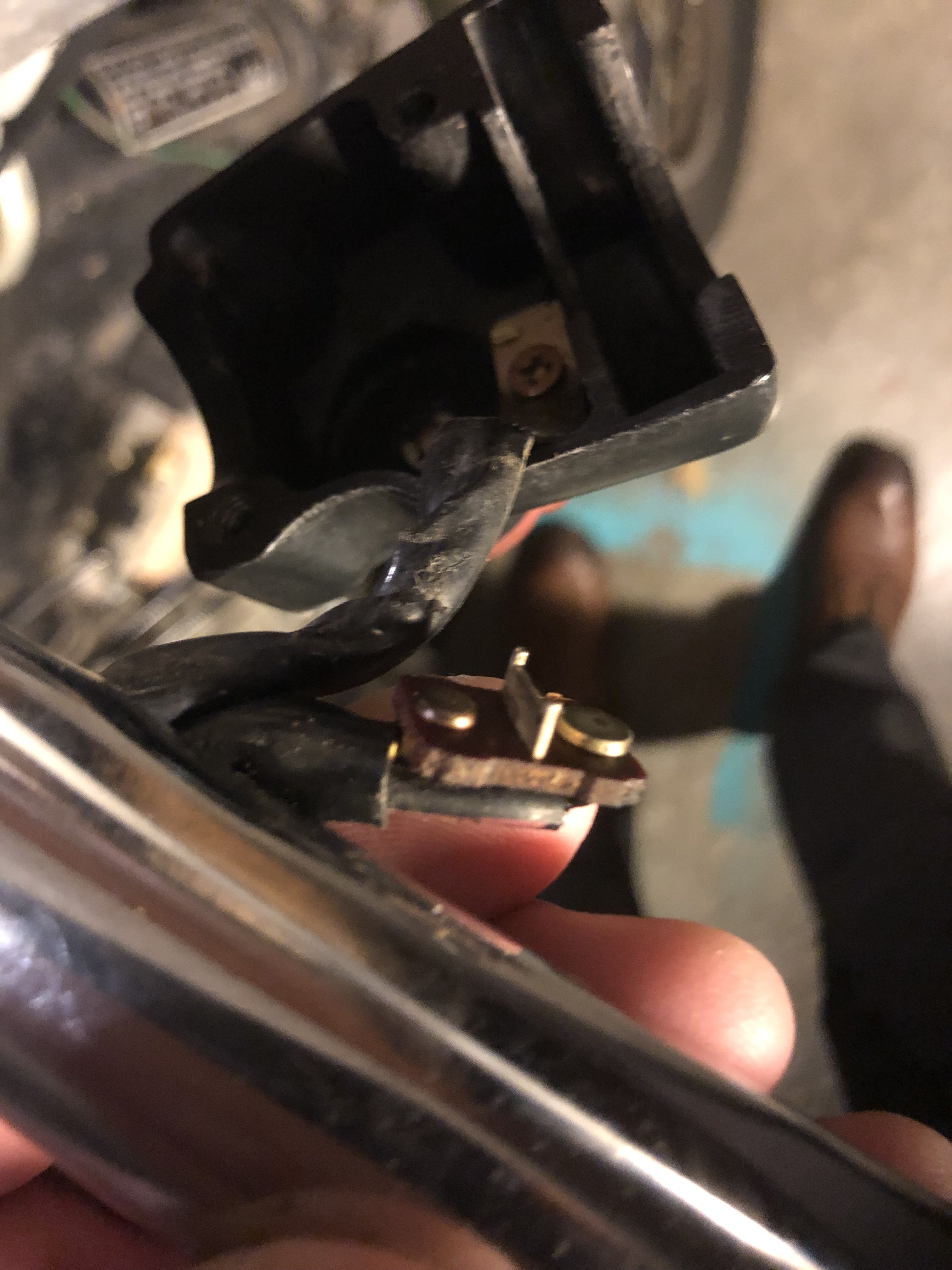

I managed to break my starter switch while installing new throttle cables. I found another thread on here that mentioned a SPDT momentary switch from radio shack that fits in the housing so I have one on order. I didn’t notice the factory switch it being DT but from what I understand it’s so you can wire the headlight to cut out when the starter is engaged to reduce battery load? Hopefully I will tackle some of the wiring tonight.

Yes, also the 360 was factory wired to kill the headlight on start up. So all the wires should already be there.
IIRC the black and Black/red should open when you press the starter button. (Killing the headlight). otherwise powering the light when not pushing the button.
