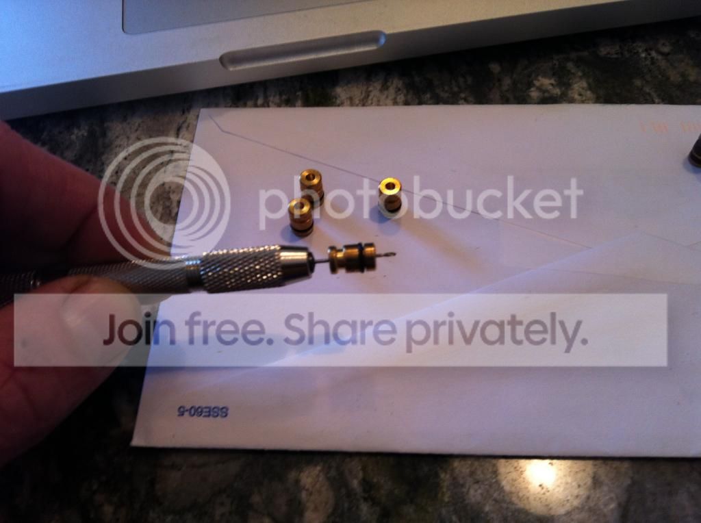

Need to up jet before I reassemble. Ran all over town and finally found a set of Micro drill bits so I can drill out the mains a couple sizes. more later. Mike, whatever I have left over is yours if you want it. !

Okay got my jets drilled out two sizes over. decided to spend $15 on a micro drill kit instead of twenty on a set of jets. Where jetting is as much art as science this will allow me to keep playing with the jetting without laying out for jets and having ones i don't need at the other end. so Carbs are back together. I'll get them mounted and see what I have to do to the electrical to make this thing run.

Cool. I would reccomend once you get the size nailed down by drilling to acutally buy the size from the store as the drilled jets aren't shaped as good as factory sized for flow, but drilling one size up at a time and running it is a good way to determine what you should run without spending $$ on 4 x each size X 5-6 sizes for sure.
