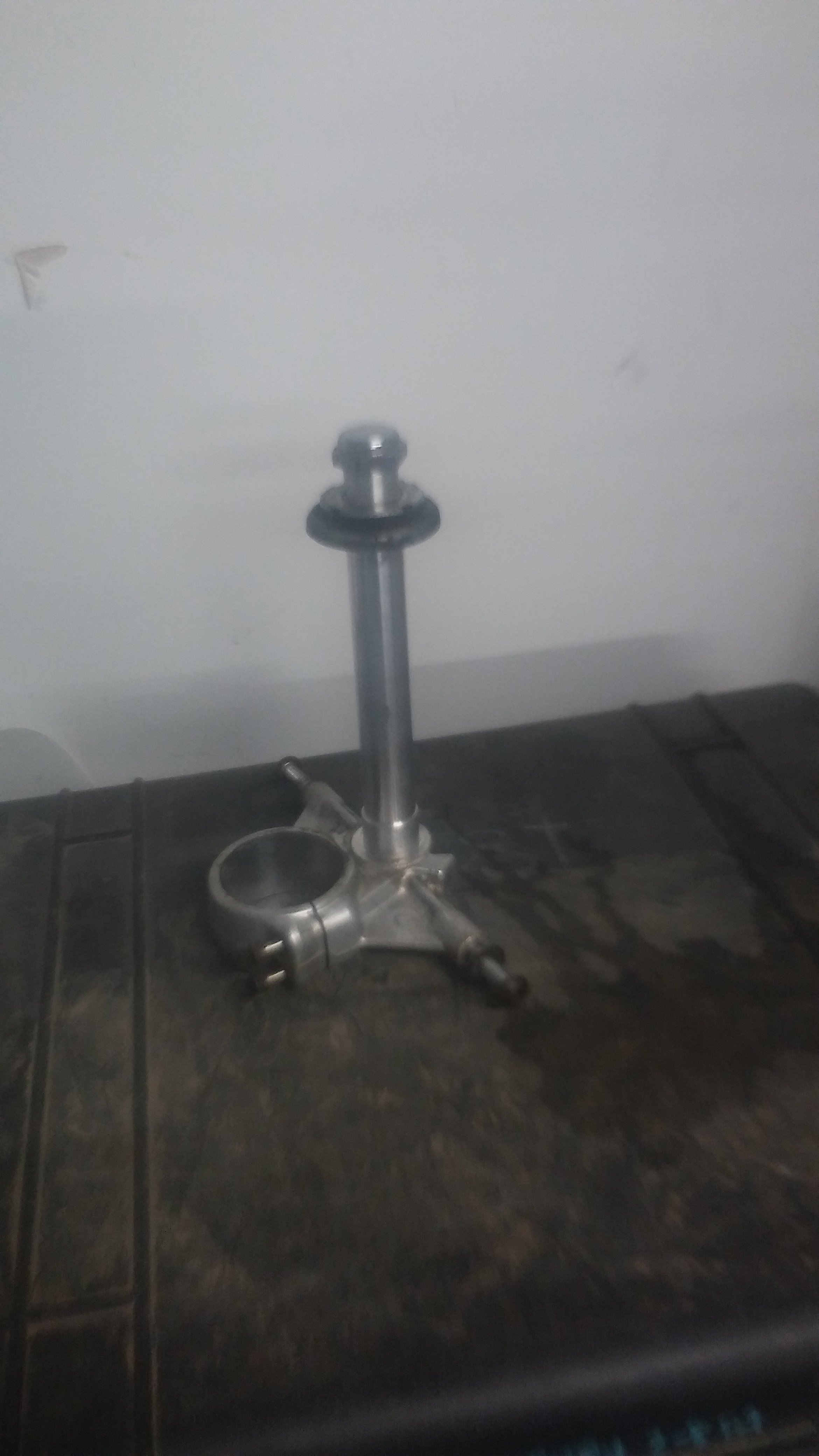

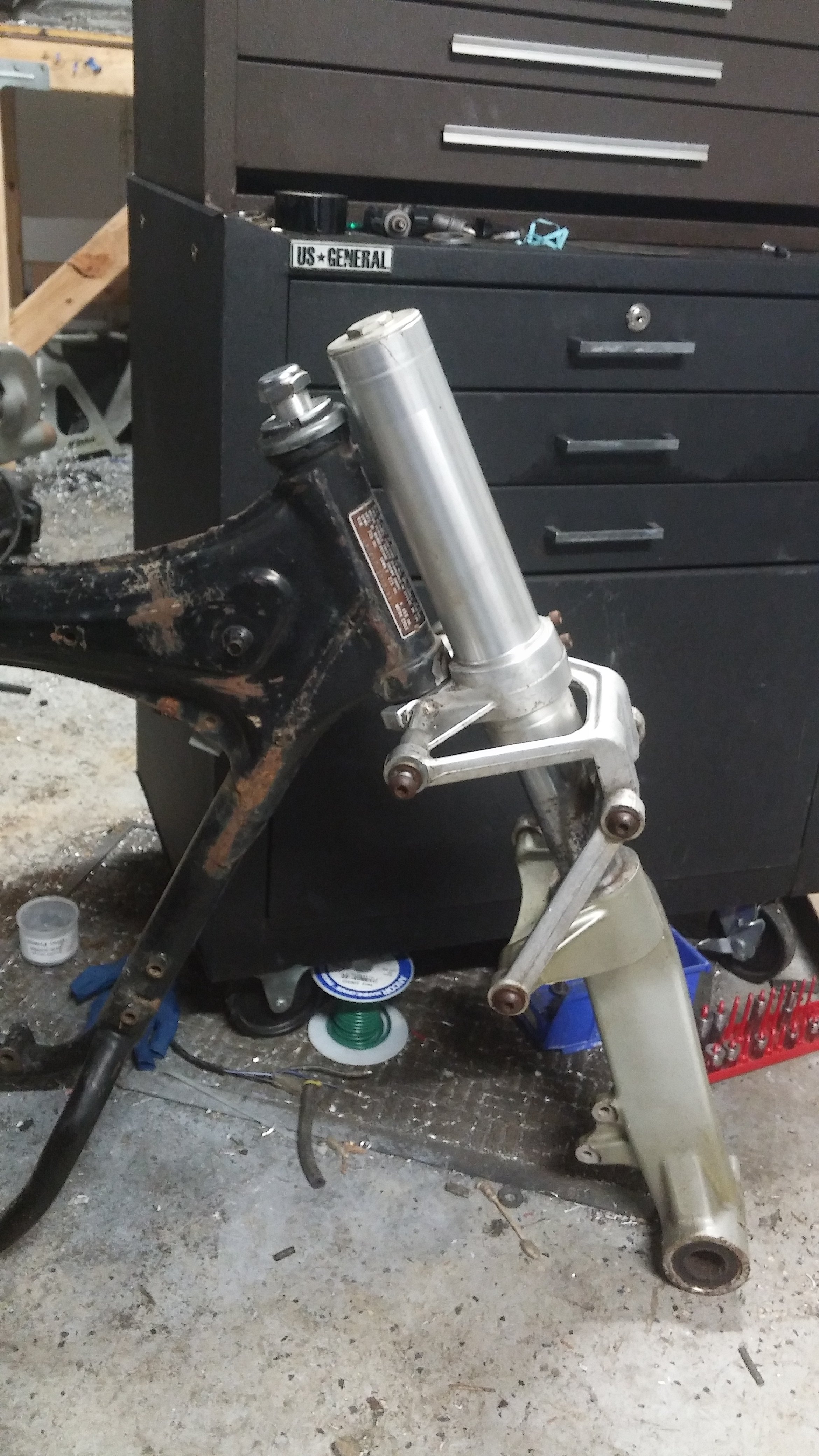

It should be a little different. I wanted to do it mainly becauae I though it would be intersting. The steering stem is done, now to order bearings and plan the upper clamp out.
I love unusual solutions and out of the box thinking but the other half of my brain asks "is that strong enough". Is it stiff enough for the 400 which I would think would be much heavier than its donor?
The bike it came off of was about 300lbs dry and 30hp. So I probably won't be that far off on weight, and not that much higher on power. I figure even with a 466 kit it'll be 40-45hp, and between 300 and 350lbs dry depending on how much weight I can save.

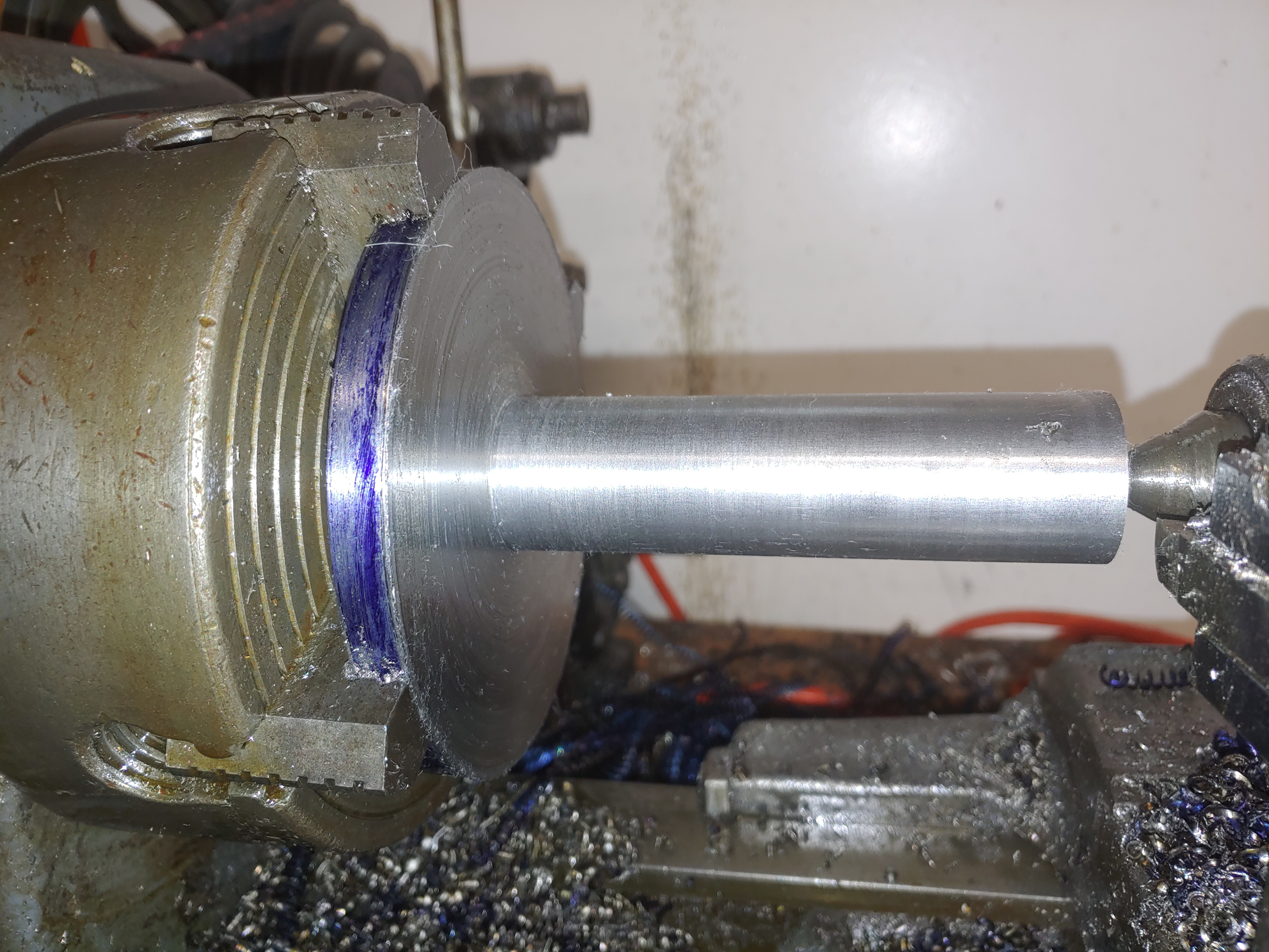

This bike isn't forfotten, just moving slow. Got cruzinimage 54.5mm big bore pistons to go 466. And I got the giant chunk of 4140 to make the front hub and axle out of one piece. Still got a bunch to machine off, but with the .070" depth of cut I have going it might be ready to finish in a few days.

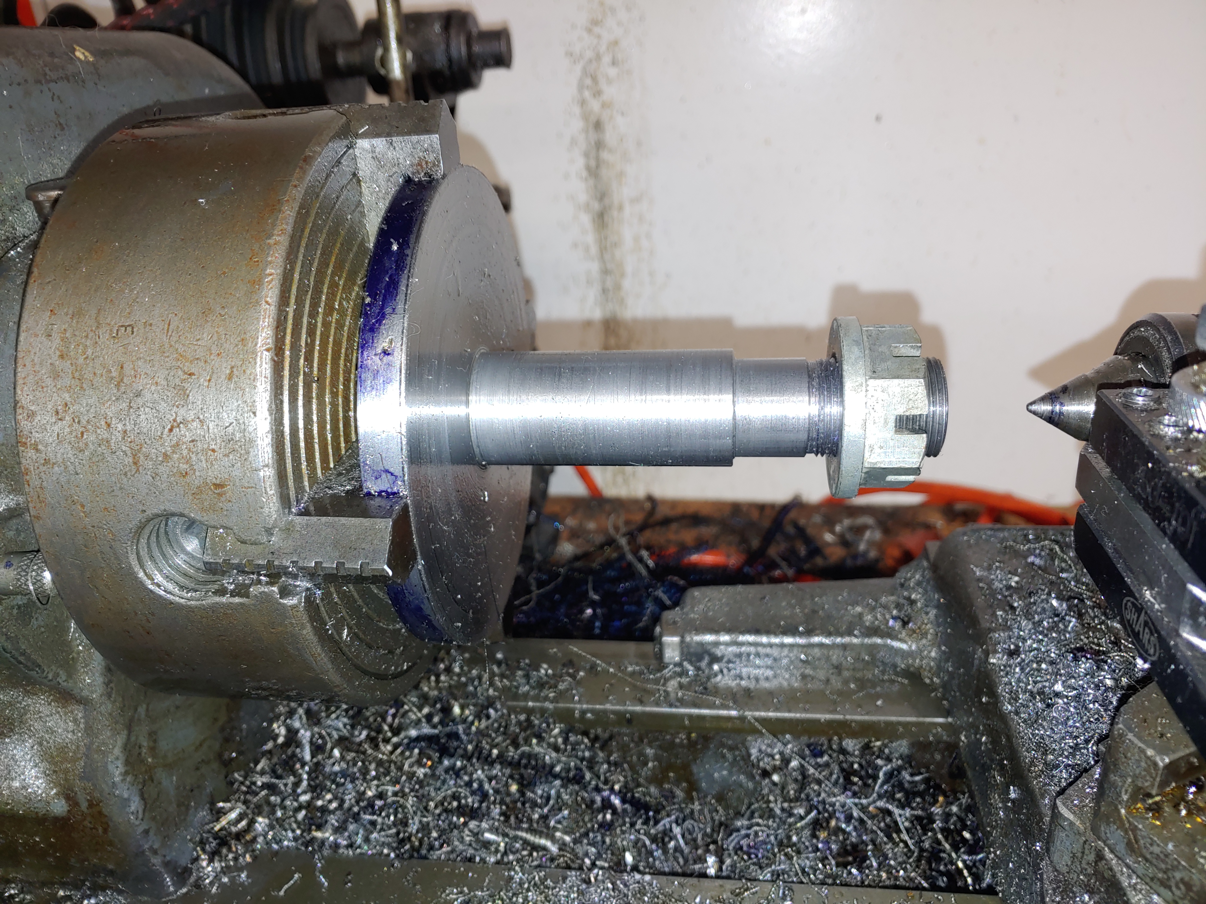

Finally got the front hub roughed. Started out as a 5.125" diameter piece of 4140, now it's 1.28" on the skinny part and 4.8" at the hub side. The axle will finish at 1.181". So now I can start the finish work.

Maybe another 1/2hr on the lathe and then it'll be ready for the mill.

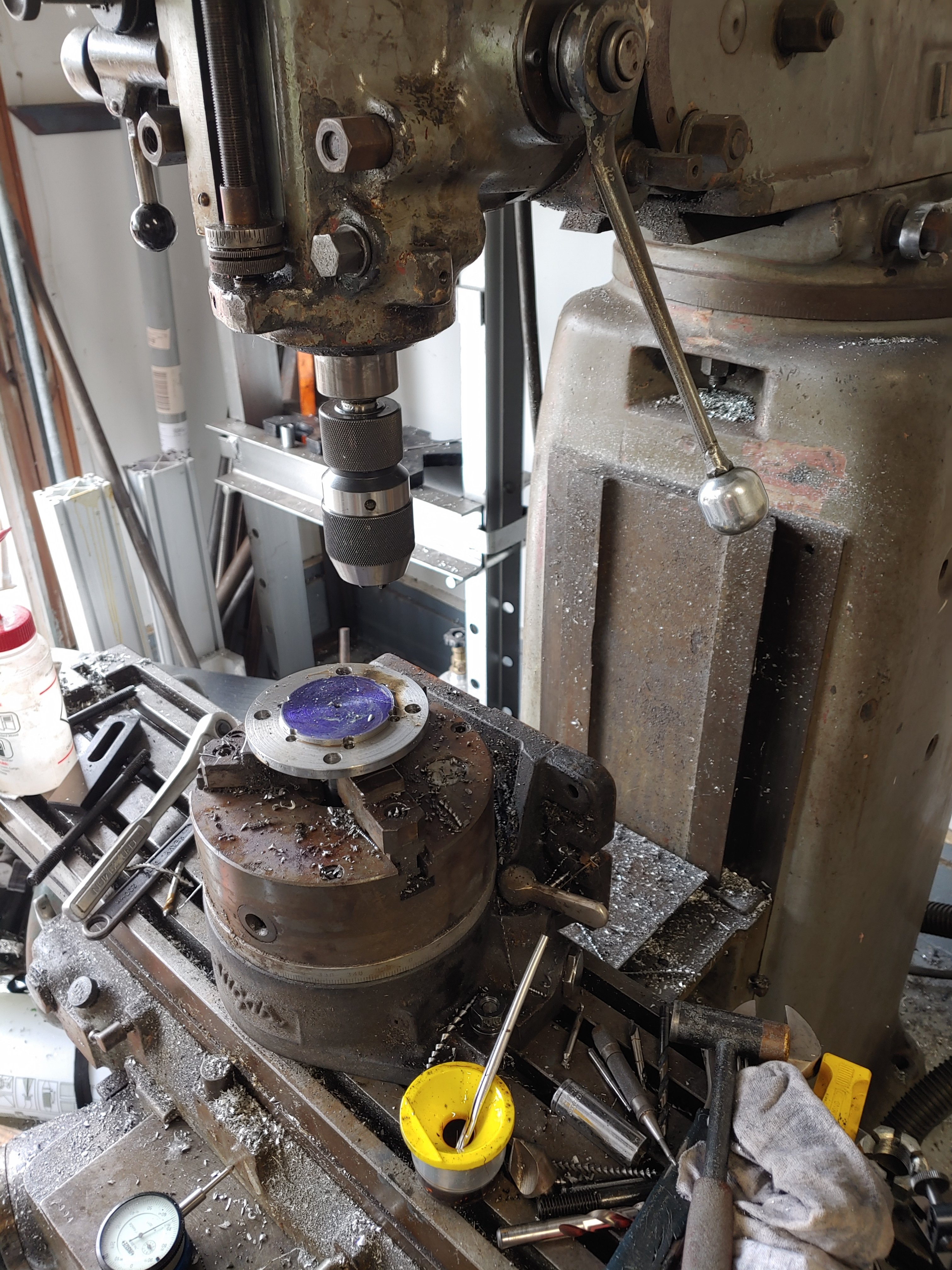

Drilled for wheel studs and rotor bolts. Turned out my m8x1.25 tap is dull so I have to get a new one.
