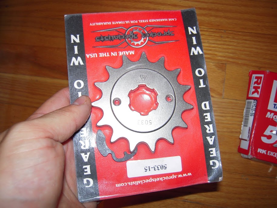

Big Rich said:Keep a close eye on the spacing on the sprockets. When i replaced my front sprocket, it needed a shim behind it to keep the original alignment.
Big Rich said:and it might not even need a spacer. Just didnt want your sprockets getting chewed up.
CresentSon said:Depends on the slight offset of the sprockets I would think.
